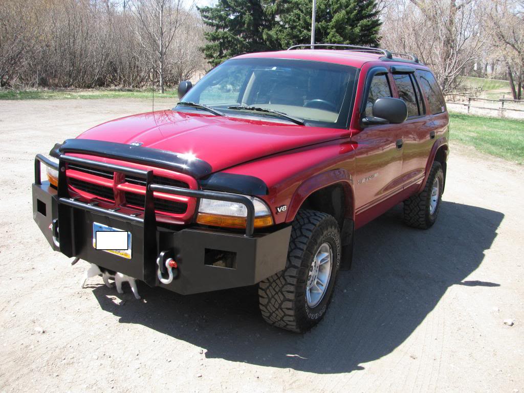

Here are some pictures. I had a local metal company cut out the front piece of metal and bend it to the shape I wanted. I spent a lot of time crunching numbers and test fitting cardboard moch ups. It was all made of 3/16" except the shackle mounts. The shackles are not attached to the bumper. They are made of two 3/8" plates with a 1/8" piece sandwiched in between so I could slide them over the frame and bolt them in place.

Thanks, a lot of hours went into it including help from friends and family. I gotta give them credit for the knowledge and labor.
I would sell you my old bumper except it has a large whole rusted through the drivers corner. I didn't realized how bad it was until one day my brother walked up and poked it, very lightly as if he was only meaning to point, and it all fell in there. That really kick started my project. Overall the cost is just around $400 plus I plan on putting on $200 worth of lights.
