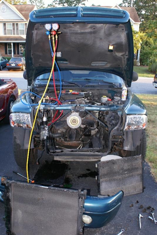

Default All this for a radiator
getting to the radiator is the hardest part :-)
Old Oct 14, 2013 | 10:03 PM
that_guy's Avatar
that_guy
Joined: Jan 2011
Posts: 4,099
Likes: 44
From: Pittsburgh, PA or Columbia, SC
They must have changed more stuff than I thought for 2000 then, I've unbolted mine before without having to remove the bumper, and I'm pretty sure it wasn't attached to the a/c condenser either.
