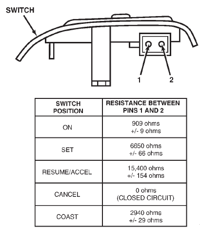

thanks. is there a good chance it could be the switch on the steering wheel or the main module itself? i looked in the switch and saw that itss only 2 wires in and controlled by resistors across the switches... i could see this very easily having problems over time and it has over 227,000 on it now. the intermittent problem is getting increasingly worse the past couple weeks. it was happening every few weeks then once a week now every other day it seems. also, i checked those 2 wires into the switch and there was no power or ground. which kind of ssounds like the clock spring.. the module had no power going to it either. i tested both with the key on. the module did have ground though
You can test the switches by getting yourself a digital multi-meter and measure the ohms.
