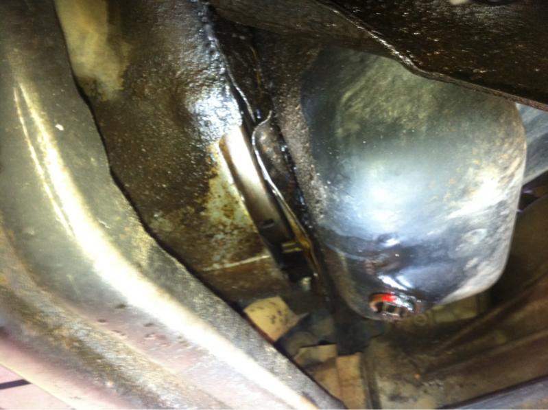

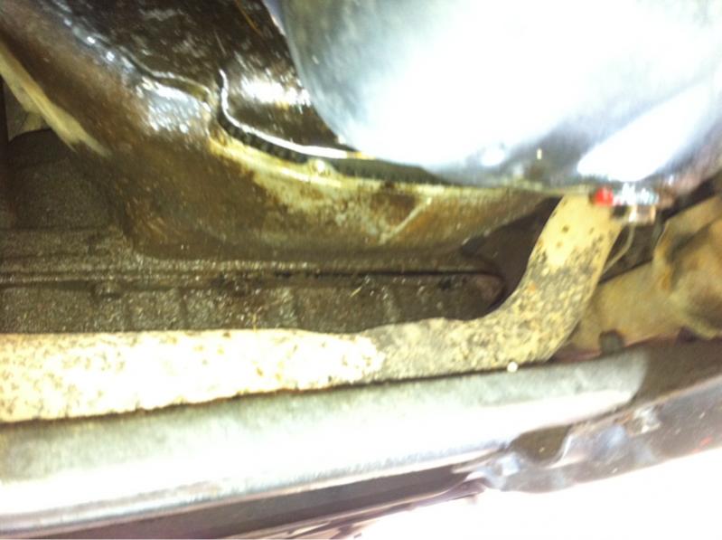

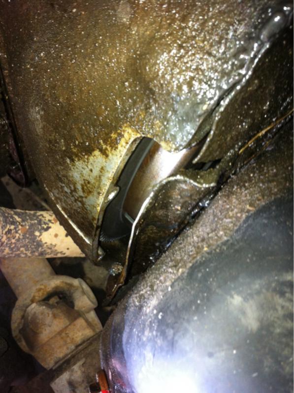

Hey guys, I have two new issues with my durango. First off, I had driven my D up on some railroad ties so as I could get underneath it to trace an exhaust leak, But I found this instead. The front of my transmission plate is pealed back, and I can see gear. There's no trace of any fluid there, except some oil from somewhere. I'm going to post some pictures of that.
I also while I was down there, found oil around my frond passenger drive shaft between the diff and hub, and it's fresh golden oil.
In the same area, I found antifreeze dripping, I tried to trace the oil and antifreeze, but to no prevail.

That's your flexplate you can see there. I'd guess someone had it off at one point and didn't put it back on properly. They do get bent up sometimes when taking them off. You'd know if you hit something that tore it up like that. The antifreeze is probably coming from one of the freeze plugs on the back of the block.

Yeah, it's torn too, I have no idea what happened. What will it take to fix that. And shouldn't their be fluids in there?
I'll check the freeze plugs again, but I haven't noticed it. And the oil is all over the axle, and their appears to be splatter all around that side from underneath. Where's the closest oil at besides the filter, it is cleaner then a whistle, changed it not too long ago, and didn't notice either of my problems.

Just bend the plate back into place and put a new bolt on it (make sure it doesn't rub anything when you bend it back into place). There shouldn't be any fluid inside there.
