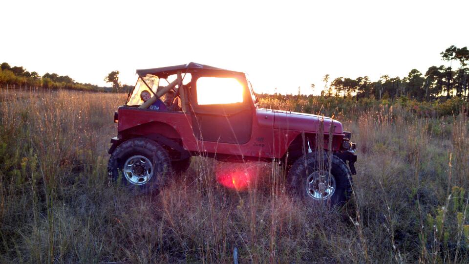

Not sure if the pic loaded, but here it is. Used dodge column n dash. Entire harness was pulled from headlights to tail lights

The TPS is the one with the white connector in this picture. It's on the driver's side of the throttle body.
