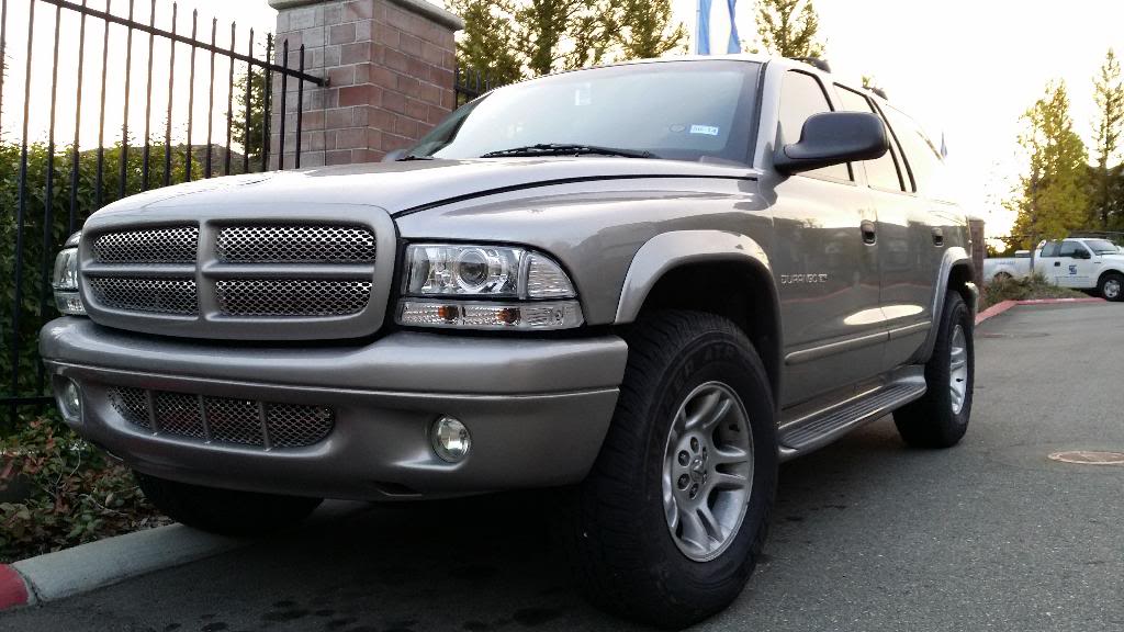

Eh just tow with it. You’ll be fine.
Worst case your truck takes a dump and you can just go buy another for $3k.
Heck, I’ll even sell you mine!!
