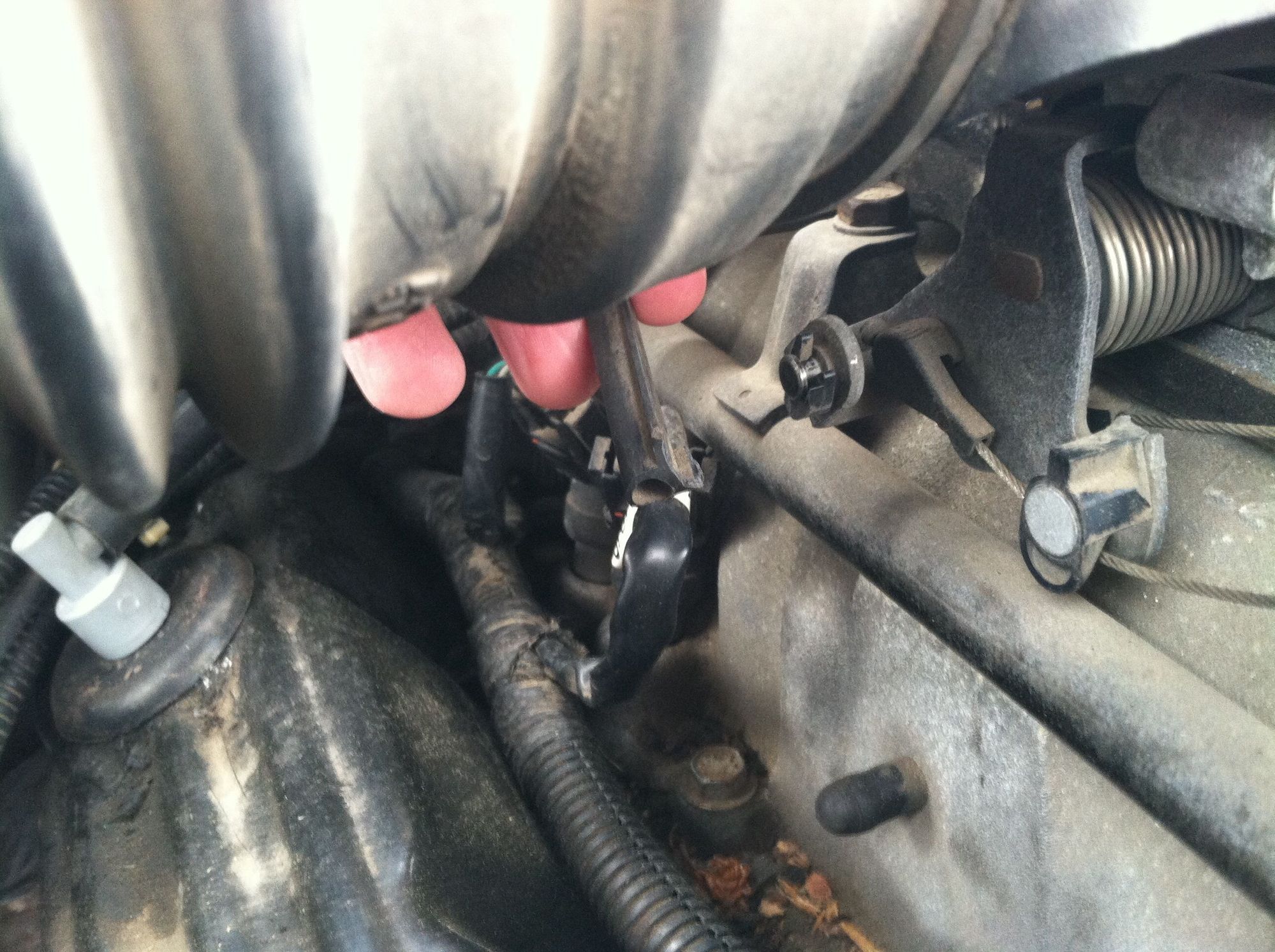

Old Jun 1, 2015 | 01:39 PM
lemon's Avatar
lemon
Joined: Jun 2011
Posts: 31
So changed the fluid and filter then I came across this, originally I assumed this was connected to the power steering but I believe that it's the throttle valve cable? Could this potentially be the culprit?
Old Jun 1, 2015 | 03:00 PM
Posts: 28,211
Likes: 366
Could very well be. Connect it back and see.
