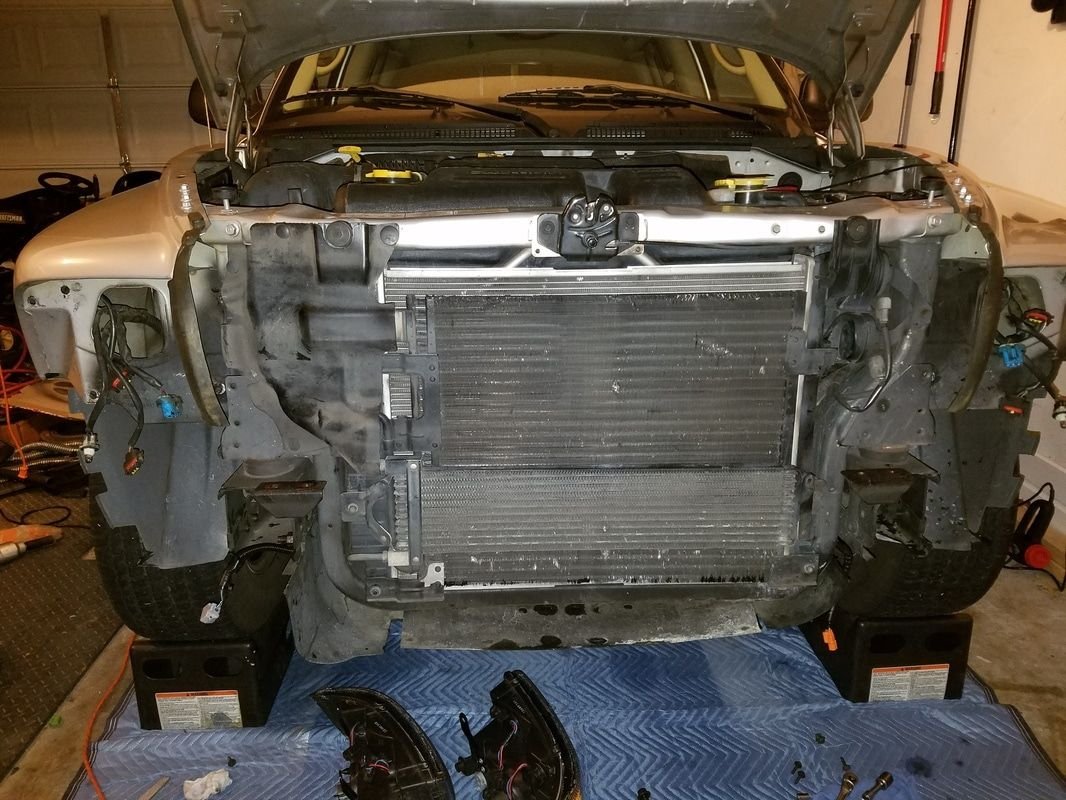

Wanted to post what I did this weekend. I've had an overheating issue with my Durango since I bought it. I developed a leak in the core of the radiator that was in the truck when I bought it, so I replaced it with one from a local radiator shop. The summer after I replaced it, my overheating issue was much worse. I also know that from the factory, if you have a truck with the tow package, you got the heavy duty radiator. I have never been able to find a heavy duty radiator, maybe Dodge still makes one, but who knows how expensive that would be. Griffin makes a drop in replacement radiator with double 1.25" rows for almost $900 without a trans cooler and almost $1,000 with it. Well this is my project truck, and I have a company truck to drive, and my wife drives my daily. So I took advantage of the opportunity and bought a Griffin universal. The part number is "1-25242-XS" it's a very similar width, but not as tall. But it's all aluminum and double 1" rows. So far the results are good, but time in Oklahoma summers will tell. I let the truck get up to operating temperature and let my Taurus fan kick on. I disconnected the low speed circuit, because I need to order a higher temperature sending switch, and I just wanted to see what it would do cycle wise. The high speed fan came on and I grabbed my temp gun immediately and was already showing a 40 degree drop across the radiator. Within about 45 seconds the radiator core had dropped 30+ degrees and the fan shut off. With my old radiator, even in 30 degree weather my high speed would still run for almost 3 minutes before it would shut off if I had the low speed circuit disconnected. So its already a massive improvement.

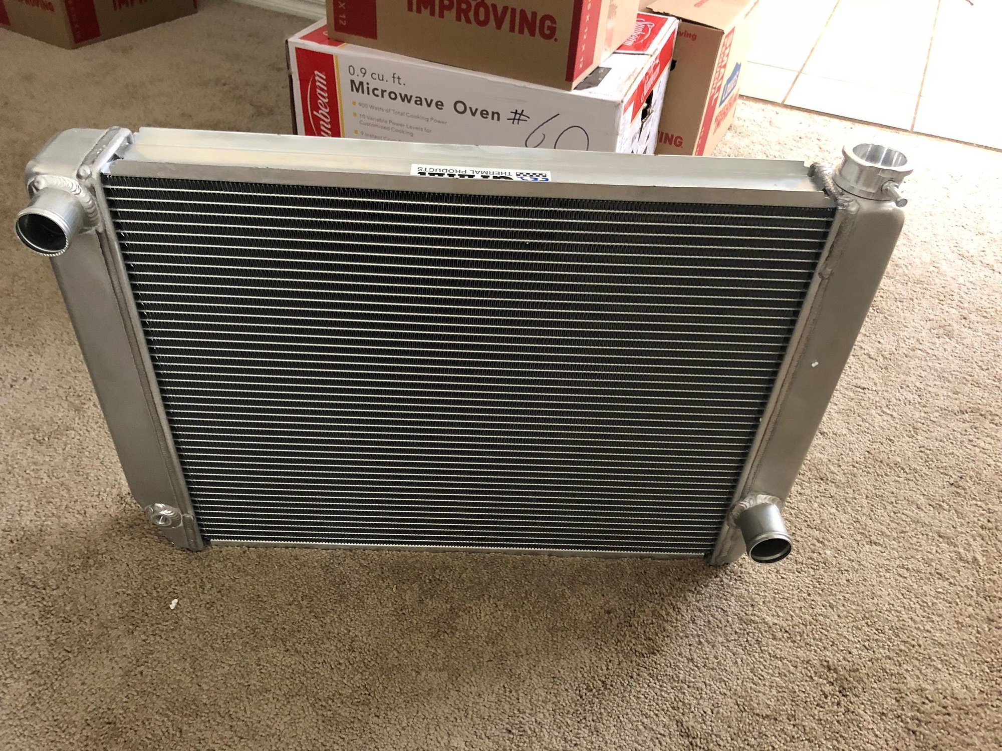

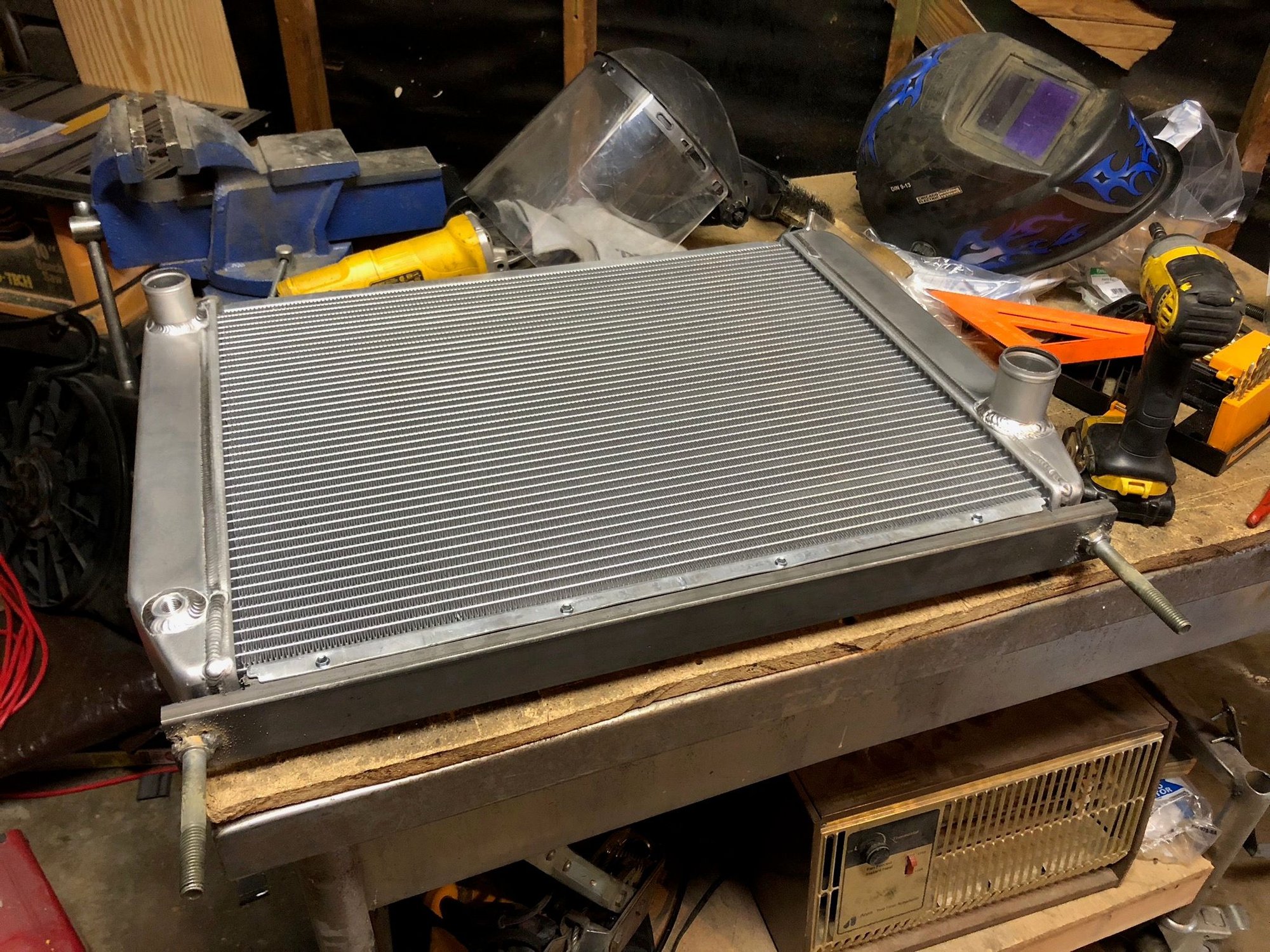

The radiator:

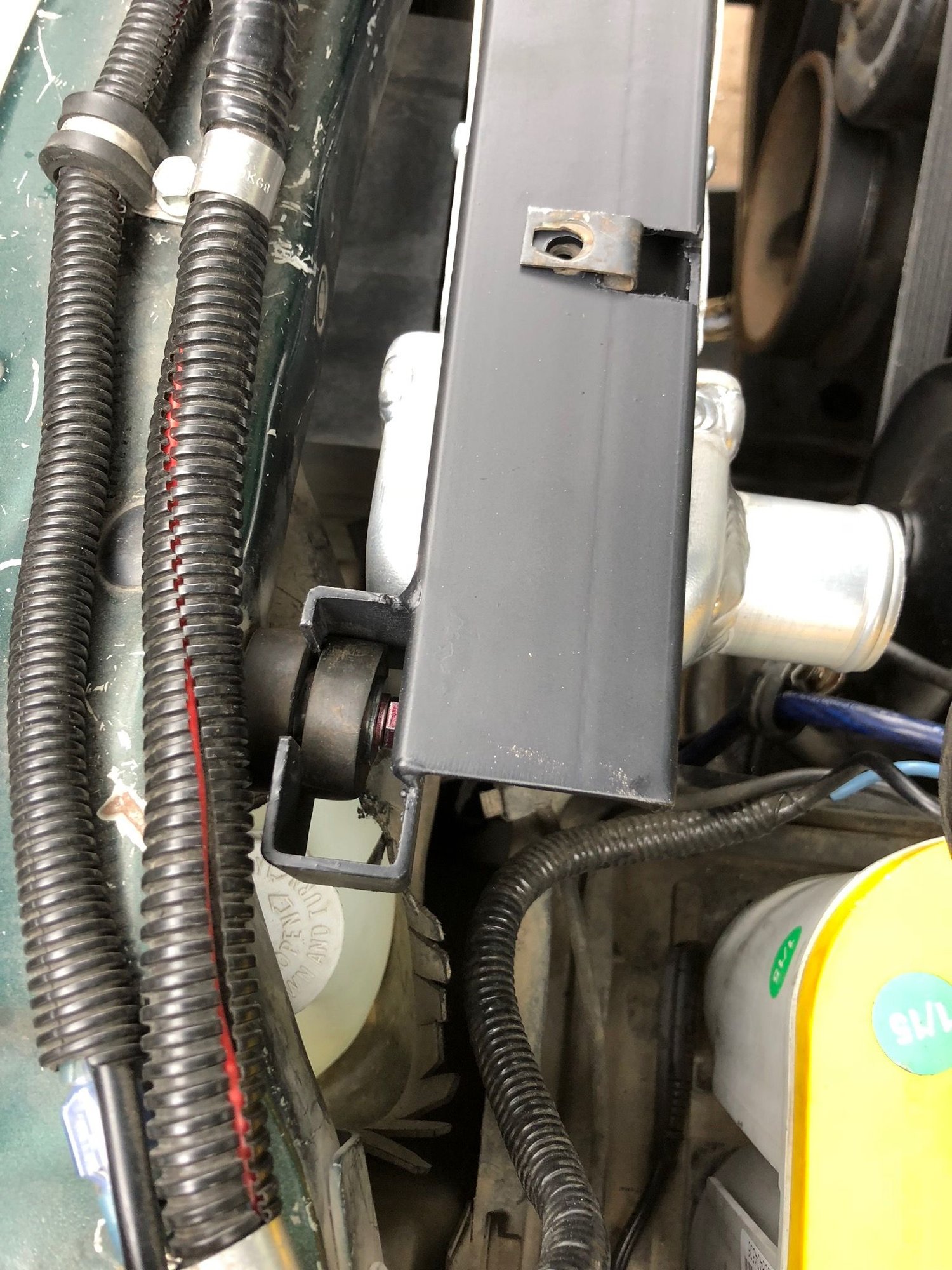

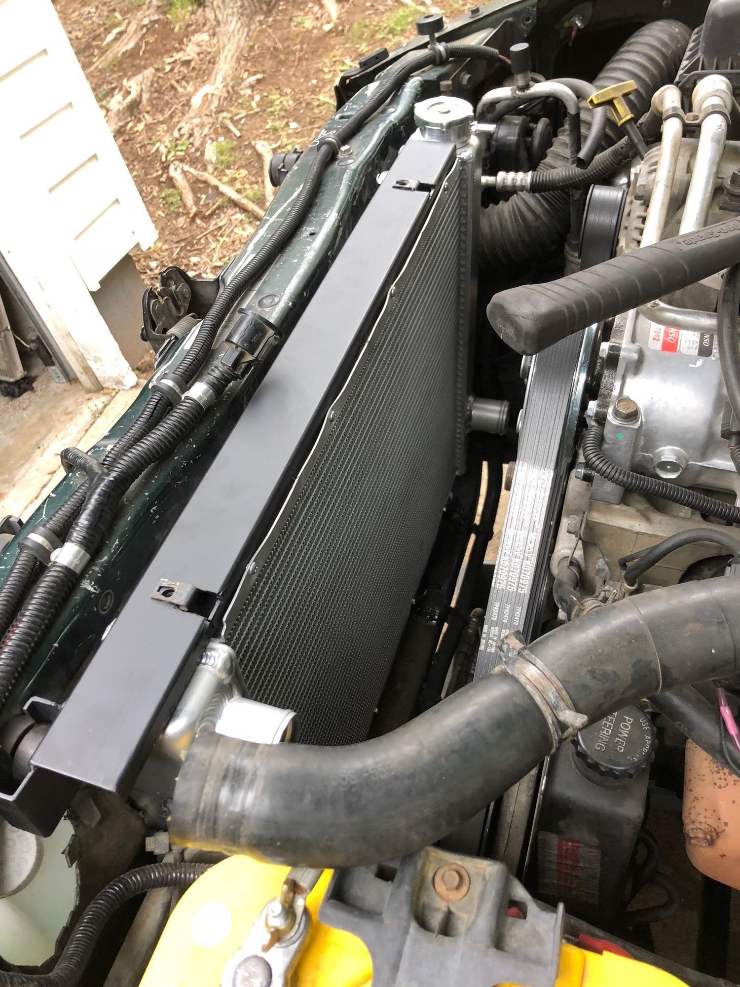

I started off by building the lower mounts. I have some 14 gauge 1X2 steel rectangle tube for another project I still haven’t gotten to. It was about 1/16" (give or take 1/32") skinnier than the aluminum mounting rails that run above and below the radiator core. It made this project tremendously easier than I was expecting. I got some 1/2" bolts, either 3 or 3 1/2" long, can’t remember which, and welded them to the bottom of the 1X2 that I cut and notched for the radiator side tanks. The 1/2" bolts have nuts and washers and sit in the factory rubber grommets I cut off the old radiator and sat down in the holes in the lower support just like the factory radiator.

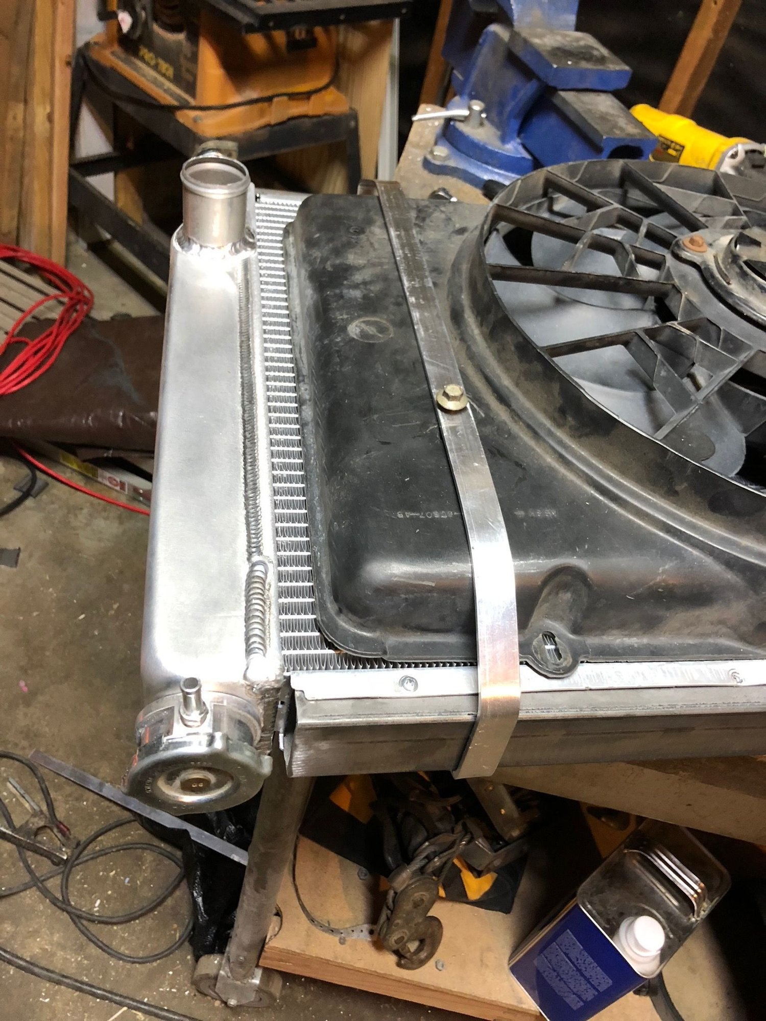

I then built the upper mount. Again, all 1X2, with one really interesting cut and weld to reuse the drivers side factory top mount. Passengers side was a little more difficult due to the radiator cap, so I did something different to that side that you will see in the finished picture.

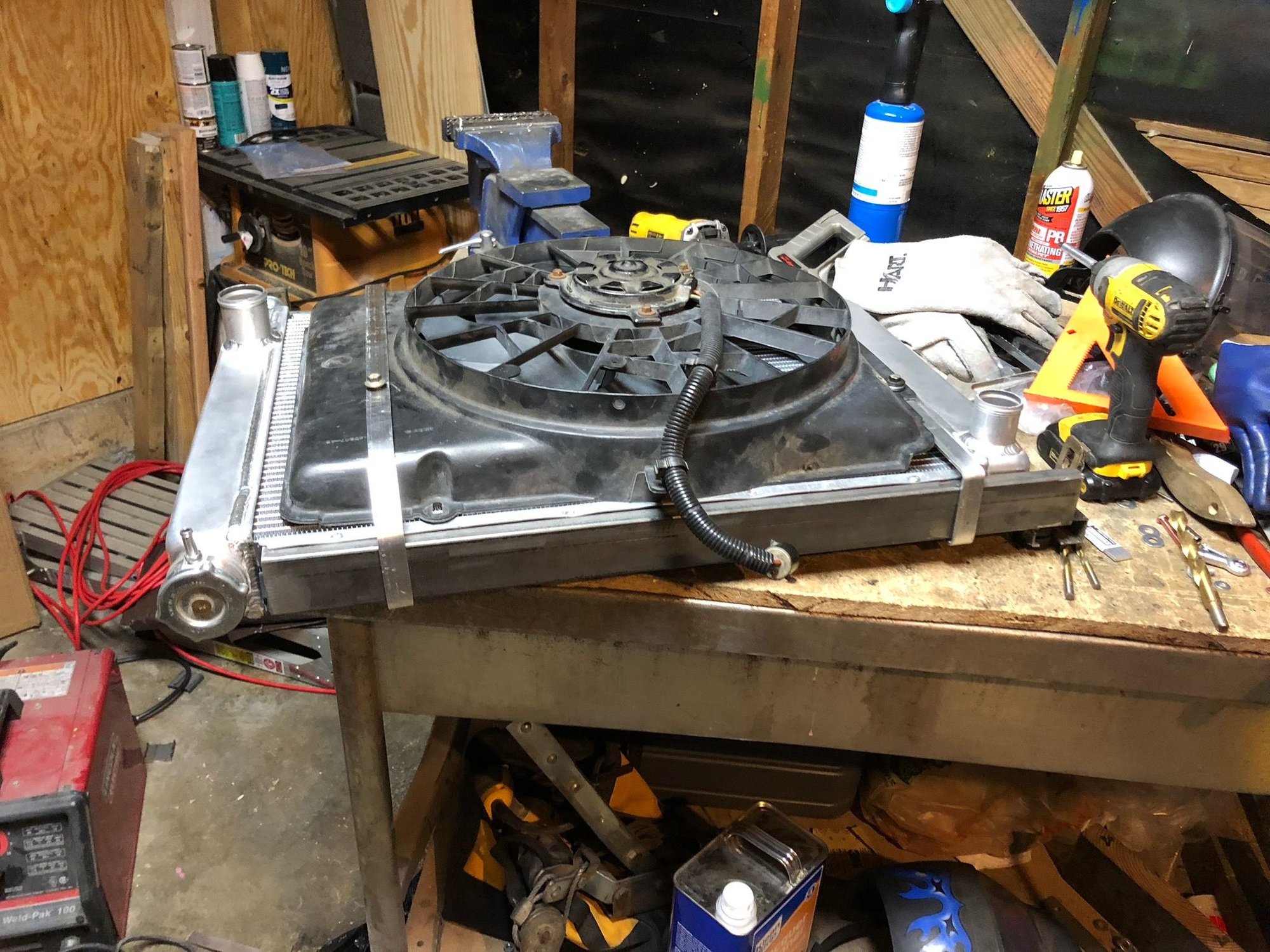

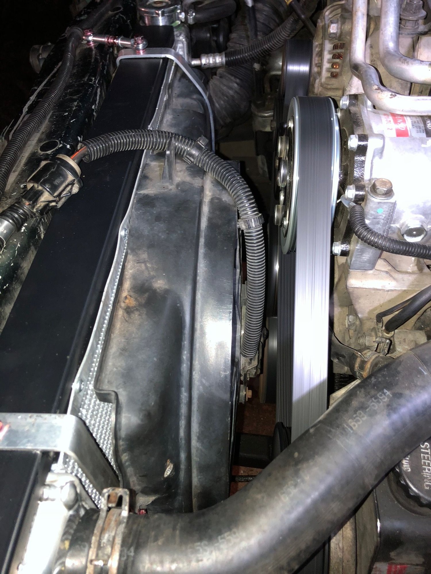

Had a really rainy Saturday so I spent some time making the fan mounts since the truck was outside and unable to be moved. This is the Taurus fan Ive had for more than a year (some of you may remember the thread I have up somewhere about why my Durango won’t stop overheating no matter what I did, one of those things being, getting this Taurus fan). Its just some 3/4" aluminum flat bar. I used the original "speed nuts" or whatever you would call them. There were 8 on the factory radiator. 4 for the fan shroud, 4 for the factory transmission cooler. I reused 7 out of the 8. They are 6mm X 1.00 threads. Picked up some bolts of various lengths to make sure I had what I needed.

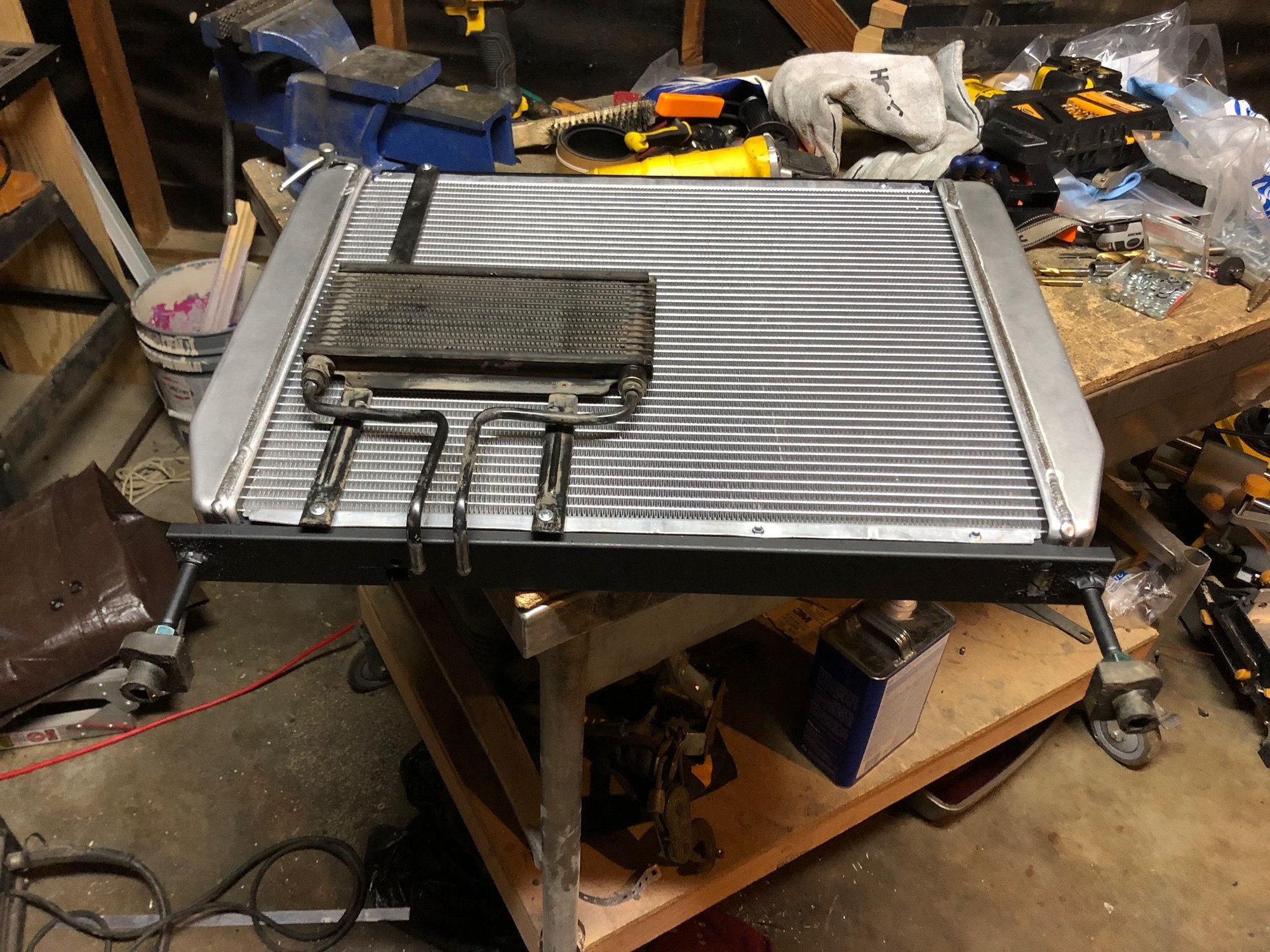

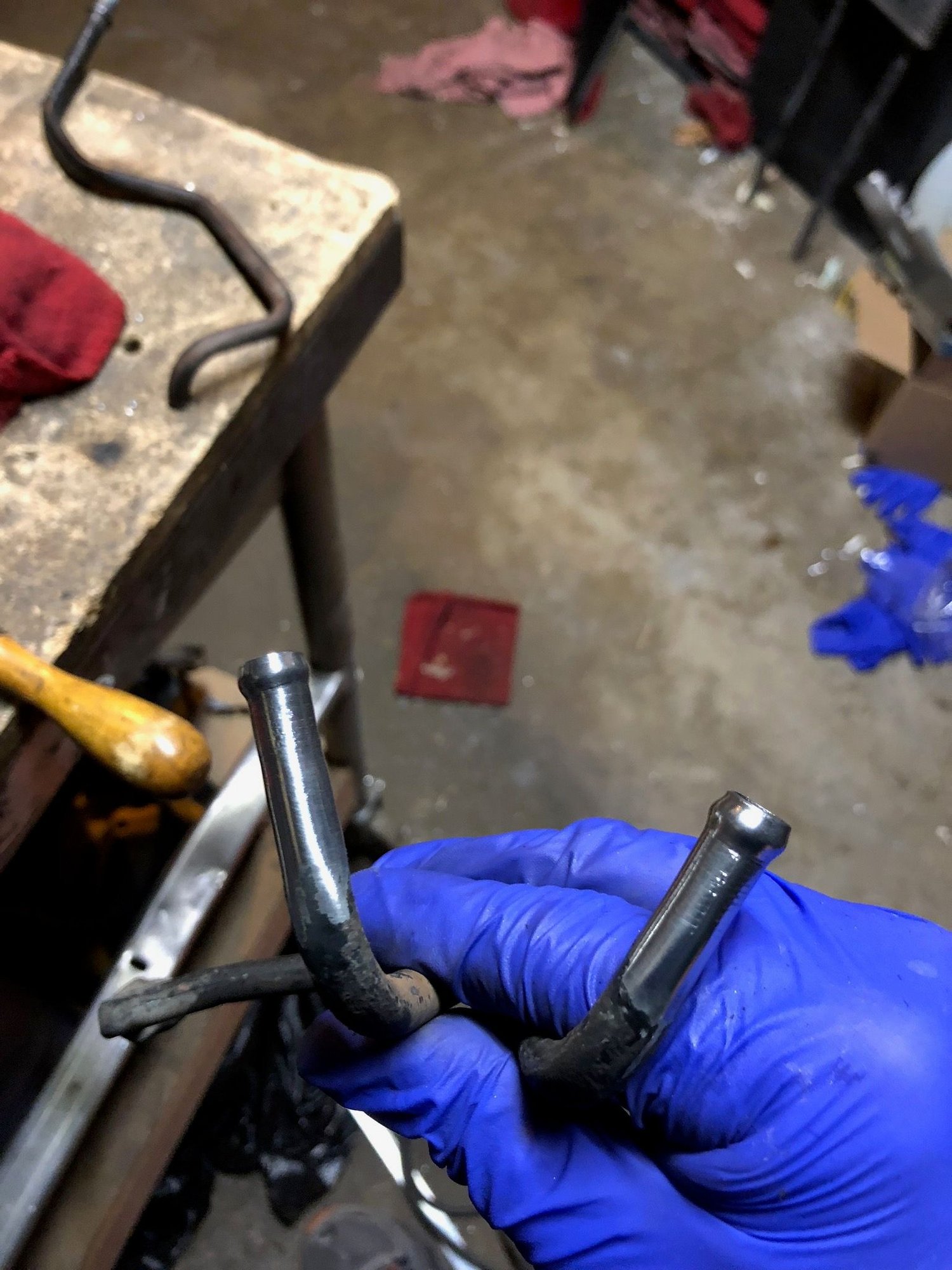

Then it was on to the transmission cooler. I have an aftermarket aluminum one. Would have been a little harder to mount, but much easier to plum. I decided to keep the factory cooler hooked up and save the aluminum one for maybe a power steering cooler somewhere down the line to replace my factory one that sits right up next to the block. From factory, the cooler is mounted horizontally according to the brackets. I decided to change that to vertical because it would save time and effort among other things. I cut off one mounting leg altogether, and cut one to length to fit just right vertically. I also bought a double flare tool from Harbor Freight. Its for Aluminum, Brass, and I think Copper. Be weary, I didnt check until I already bought it. These lines are STEEL. Put a magnet to them, I was surprised. I cut each line right before the 4th bend away from the cooler, did bubble flares on both, and swapped the lines between ports because the cooler is actually in backwards compared to how it was from the factory. When all was done, the lines pop out right under the radiator next to the factory lines. (BTW, I know I should have a cooler in the radiator, especially for winter time to help keep the fluid up to temp. But it's $100 more for a built in cooler, a piece of cardboard to stick in front of it=free.)

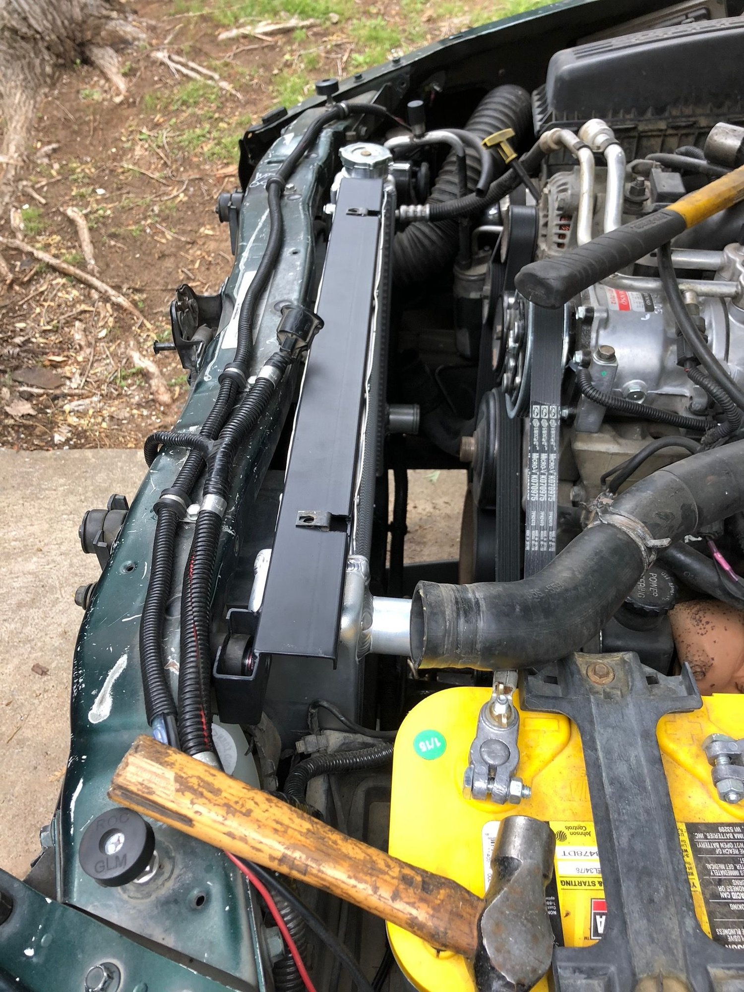

Here are some pictures of everything in place, and one finished picture. In most of these pictures, you can see how I used the factory thread inserts for the fan mounts. I have a temporary flexible lower radiator hose. Im going to go to the salvage yard and take measurements of the 00-03 (or 01-03?) Durangos lower outlet because Im pretty sure they raised it up considerably, so I might be able to just buy a factory one for that Durango W/5.9 and be good to go. For the passengers side upper mount, I used two 6mm Heim Joints butted up together to still allow movement but hold the radiator in place. The transmission hoses were cut just before their factory fittings, they go on to the 3/8 steel line perfectly and clamp right up.
I hope this wasn’t too boring of a read, and I hope it can help someone in the future. With my overheating problem, Im 99.9% sure it was that radiator, so I should be good to go now. I ruled out everything else, but time will tell!

The radiator:
