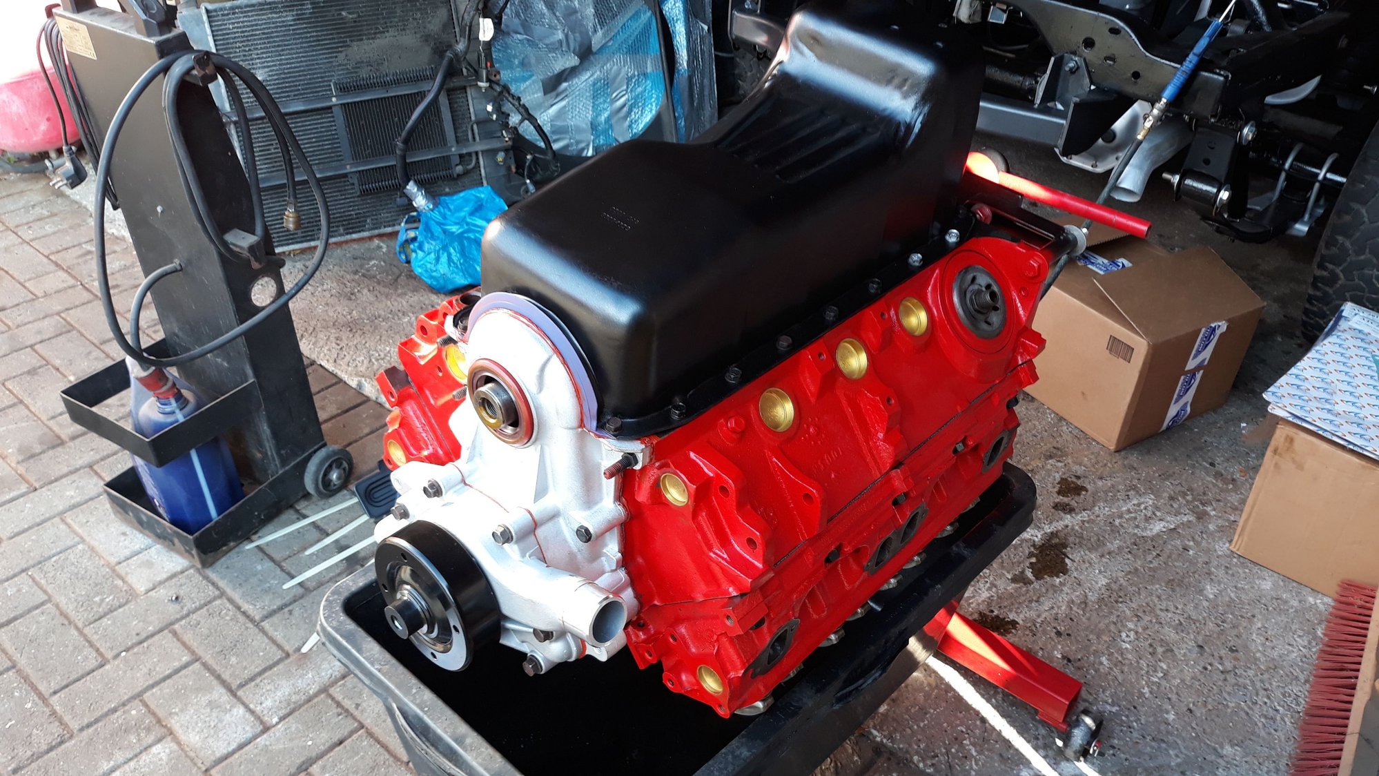

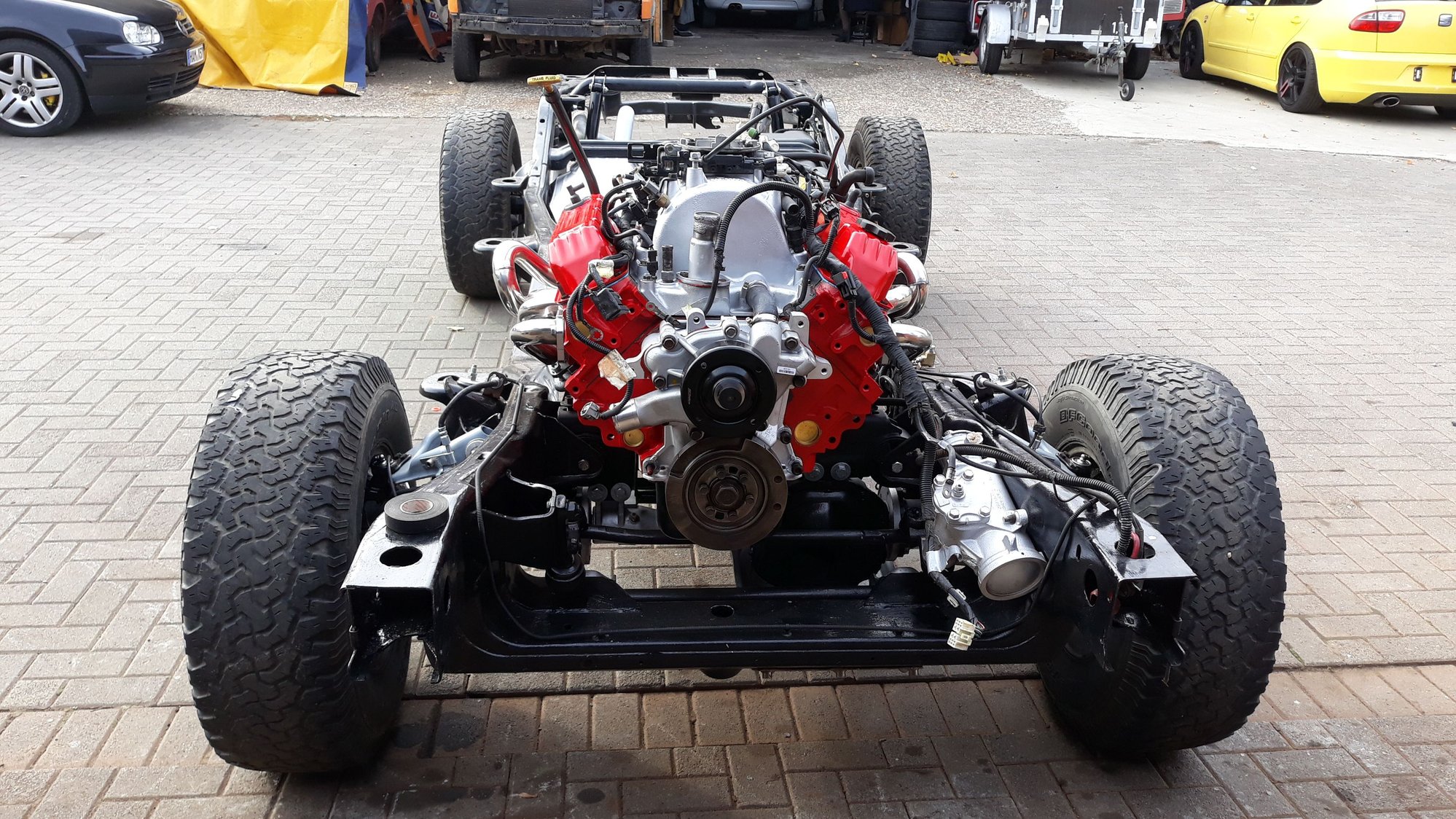

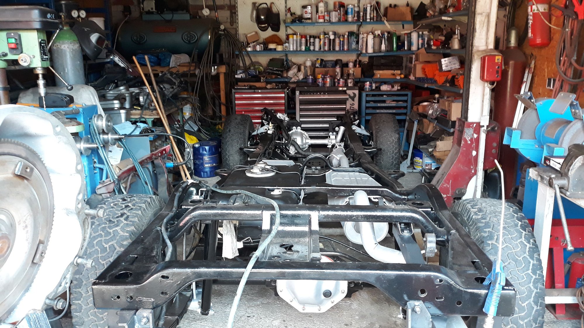

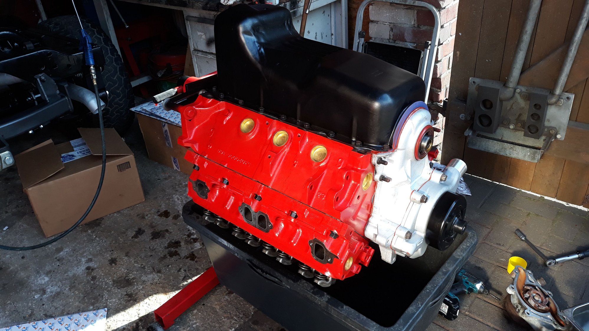

here some more pictures
Old Oct 18, 2018 | 09:05 AM
Posts: 87,483
Holy smokes, you have made some serious progress in a very short amount of time.

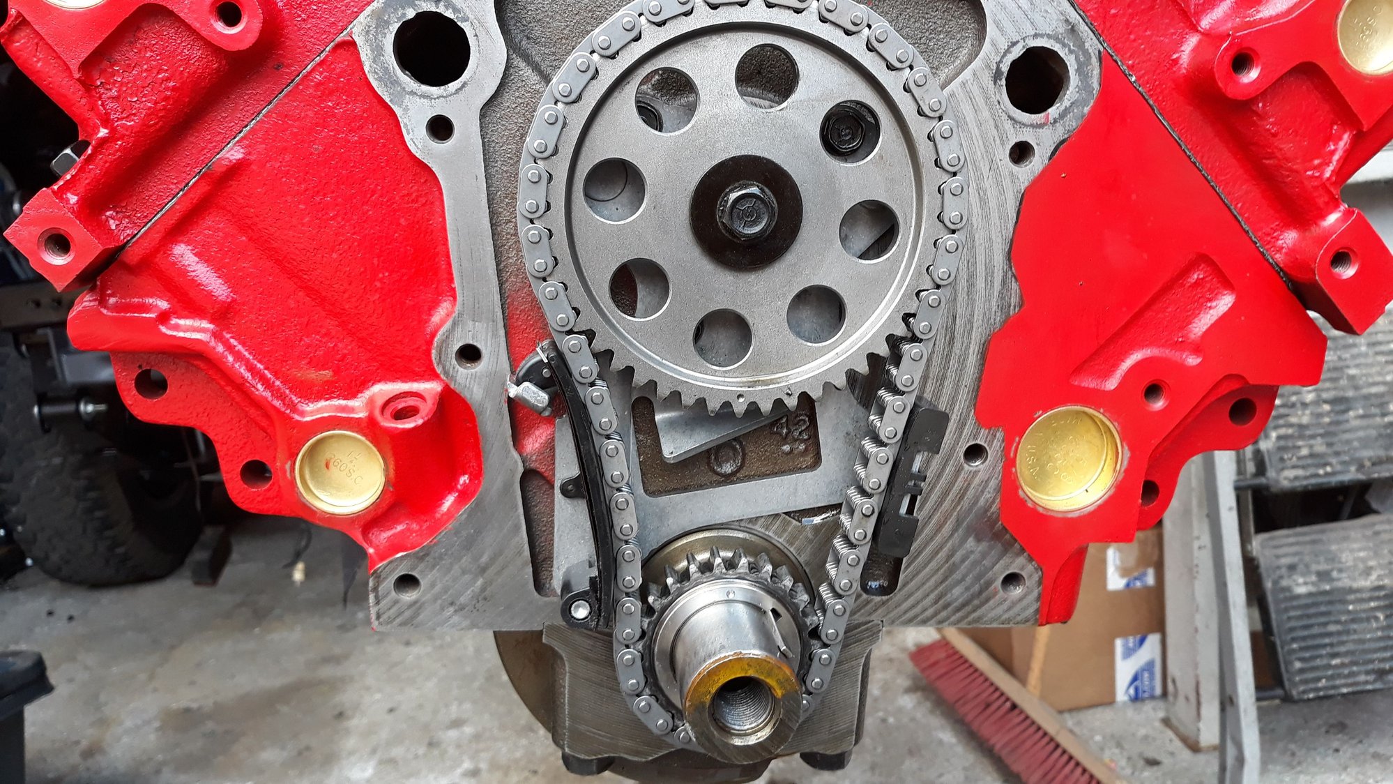

I have been waiting for the chain tensioner, otherwise I would be finished with the engine
I wanted the chain tensioner, is super cheap
cost only one double short+tip on Rockauto.com

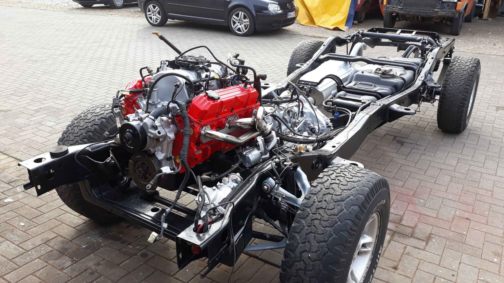

Today I reinstalled the engine.
new valve cover screws are ordered

That looks slick. I see you heat wrapped the Y pipe. Are you going to wrap the headers too?
Old Oct 20, 2018 | 11:30 AM
Juergen's Avatar
Juergen
Joined: Oct 2018
Posts: 60
From: Germany, NRW
yes, i will make
black band I do again and take white band

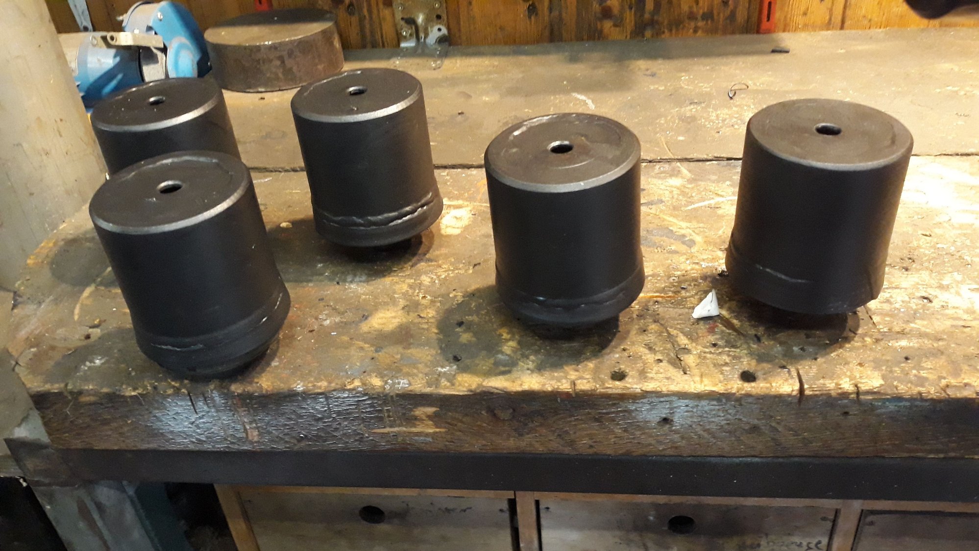

3 inch Bodylift selfmade
Old Oct 28, 2018 | 08:09 AM
JeeperDon's Avatar
JeeperDon
Joined: Jan 2013
Posts: 993
Likes: 11
From: Albuquerque, NM
This was going great, excellent work and decisions, until this! I'm hugely not a fan of body lifts! They are ugly and a poor mans work around to a proper suspension lift. If you want tall and big tires, switch to a solid axle in front and SOA in the rear.
Old Oct 28, 2018 | 10:25 AM
that_guy's Avatar
that_guy
Joined: Jan 2011
Posts: 4,099
Likes: 44
From: Pittsburgh, PA or Columbia, SC
What are your plans for getting the fan shroud (attached to body) lined back up with the fan on the motor (attached to frame)? You'll need to extend the transfer case shifter also.
