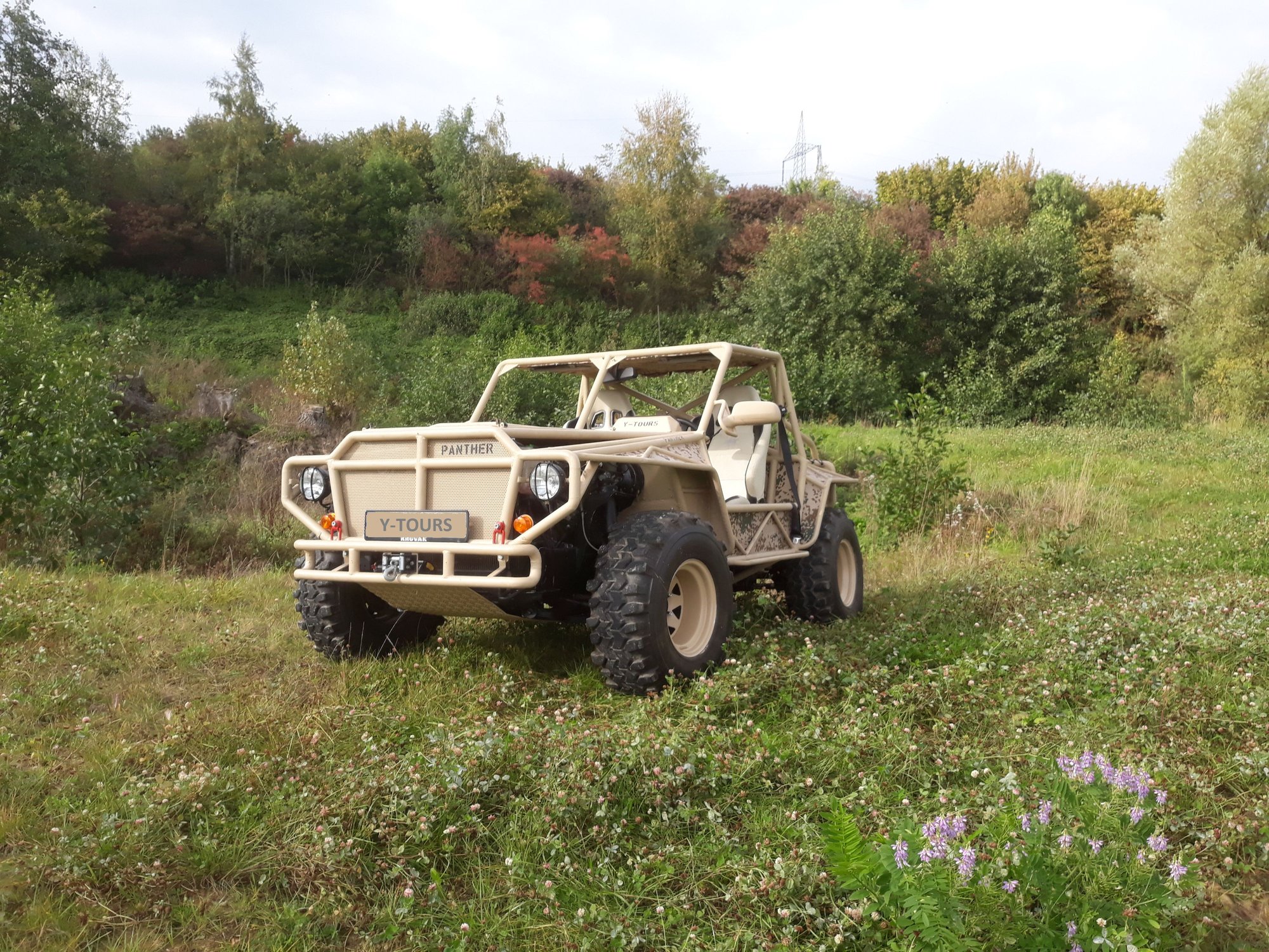

I have already (self)built vehicles completely, here one picture from my selfmade "Panther" :-) only just4fun
it was once a suzuki Vitara

Looks awesome! Just incase you don't know, 2000-2003 Durango radiators are actually down in the core support area instead of being behind the core support. It might be a little easier to fab a shroud from that radiator. I actually put a Griffin full aluminum Radiator in mine. But I put it back in the factory spot as my 98, but it would also fit inside the core support area. Just some ideas! Give me some time and I'll post a link to my radiator thread.
