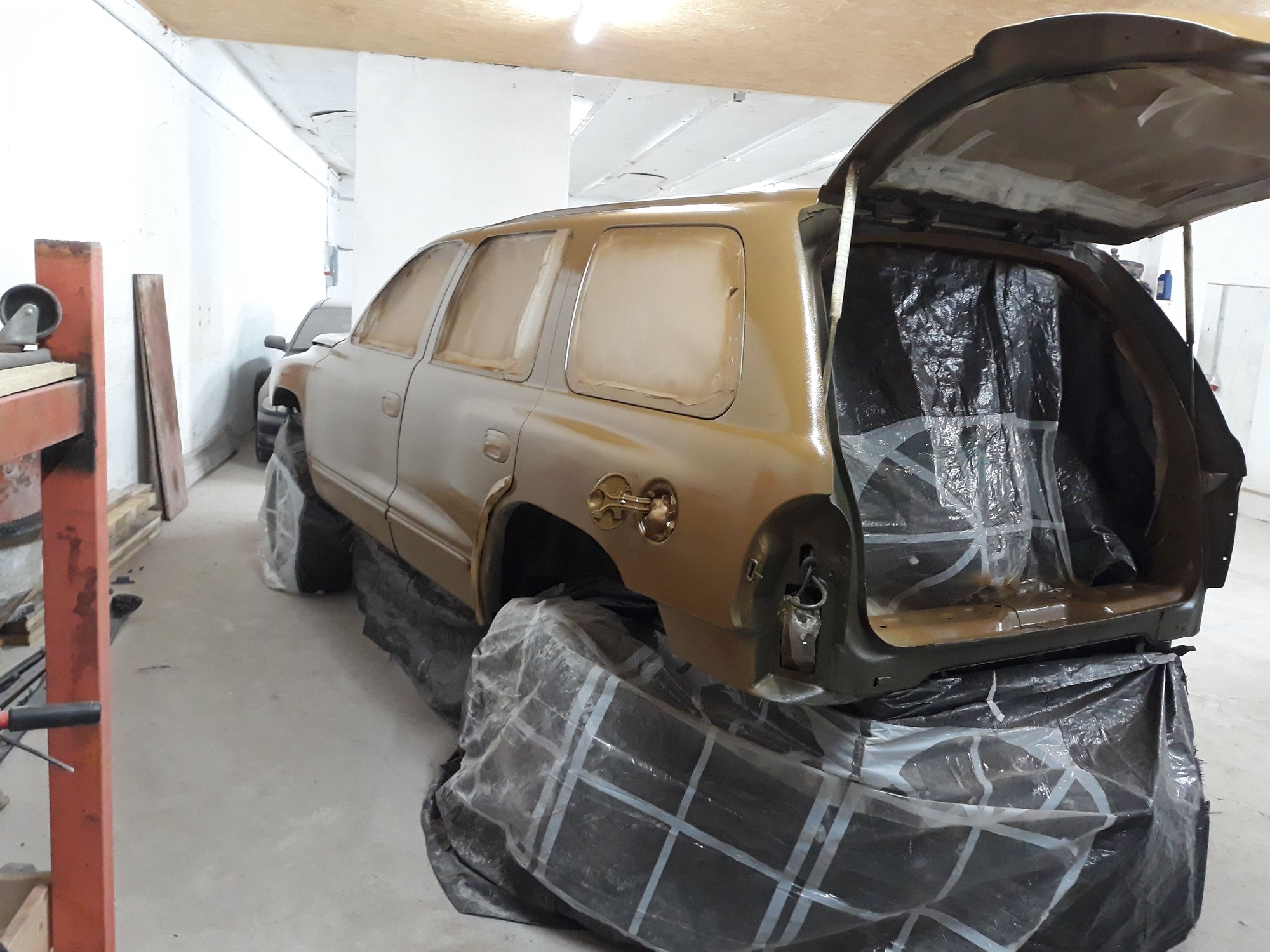

update:
fist 1-K Adhesions Promotor
then 2-K Epoxyprimer (colored in RAL7008)

I have now coated with Raptor Liner ........
quite as easy it is not a uniform order to get out without "clouding" with little color addition with base coat.
This is the first pass ..... I do not like it too unevenly, I had to often close to the body to get into the corners ......
then creates a "cloud formation" ...
important is ALWAYS the same distance and angle when spraying prevails, which I did not comply / could
I promise improvement

I would be tempted to make sure all the nooks and cranies are filled, and then spray a final 'evening' coat where you can pay attention to getting proper coverage/color saturation.

Thanks
yes, that's how I do it.
New Raptor is ordered (5 liters) for the finisch
I hope it is enough then

Any particular reason you elected to go with bed line, instead of paint?? Planning to off-road this one??
