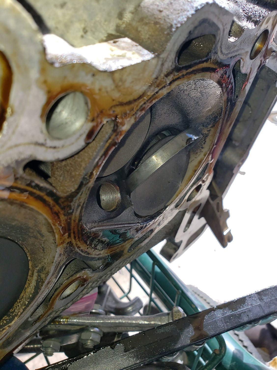

Progress report: As I'm working outdoors on this beast, tear down has been slow...I finally got the timing cover off and am getting ready to remove the timing chains/heads...a progress pic for anyone who wants to see:
I've got a lot of cleaning to do and I'm dodging rain/wind storms...I did put the timing chain cover back on to keep the dirt out....Also, anyone know the part number for the heater hoses that come off the timing cover and cross over the engine block? Its the hose that goes from rubber to metal across the engine to the heater hoses coming out of the fire wall.

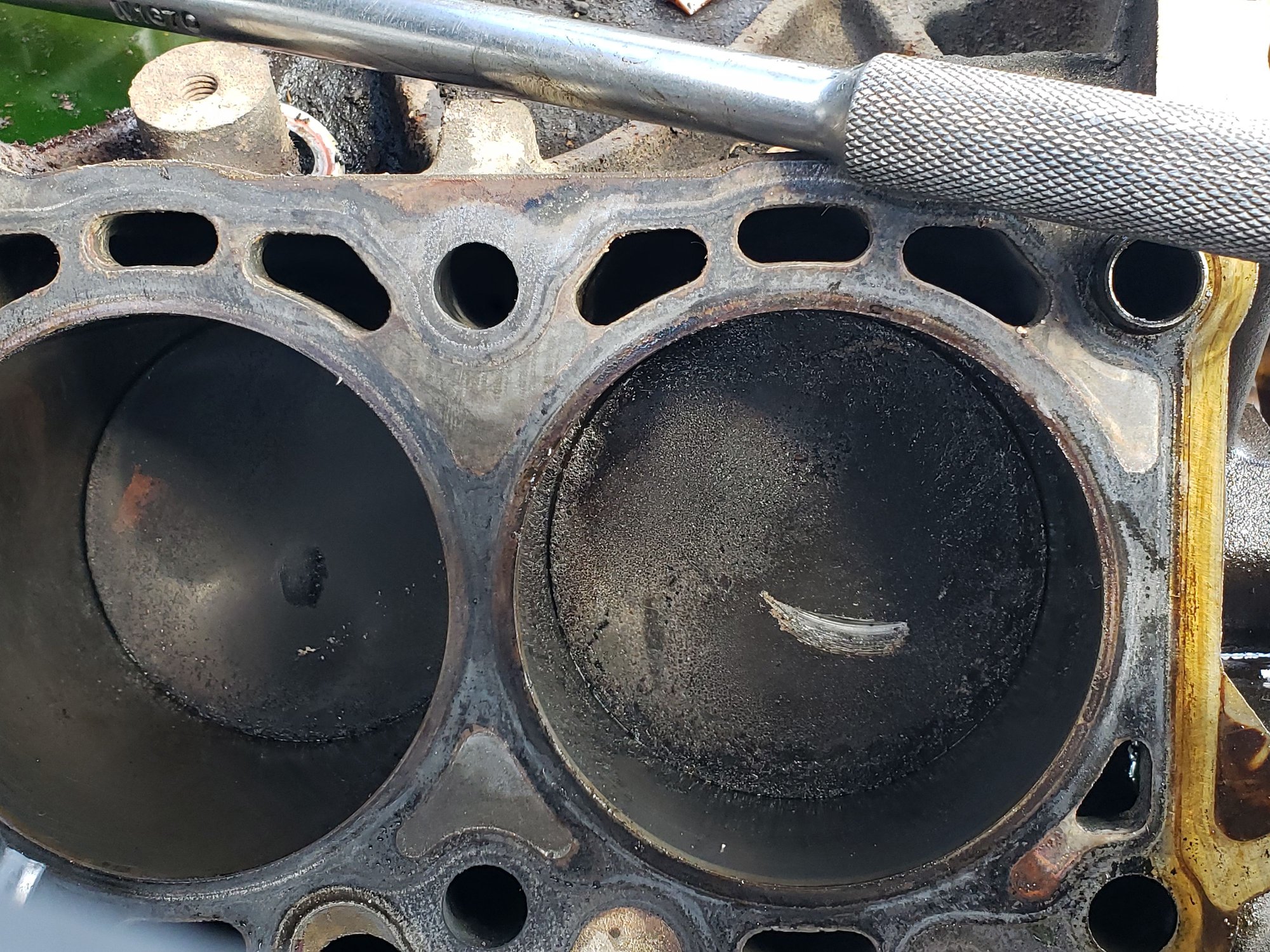

And we have found the culprit:
Dropped valve seat on #2 intake valve...
Minor damage to #2 piston head...going to clean it up and run her
And as a bonus...I lucked out and found an unused set of reman heads on letgo for $275...now to get busy cleaning and installing...tomorrow time for a beer or 3 lol
