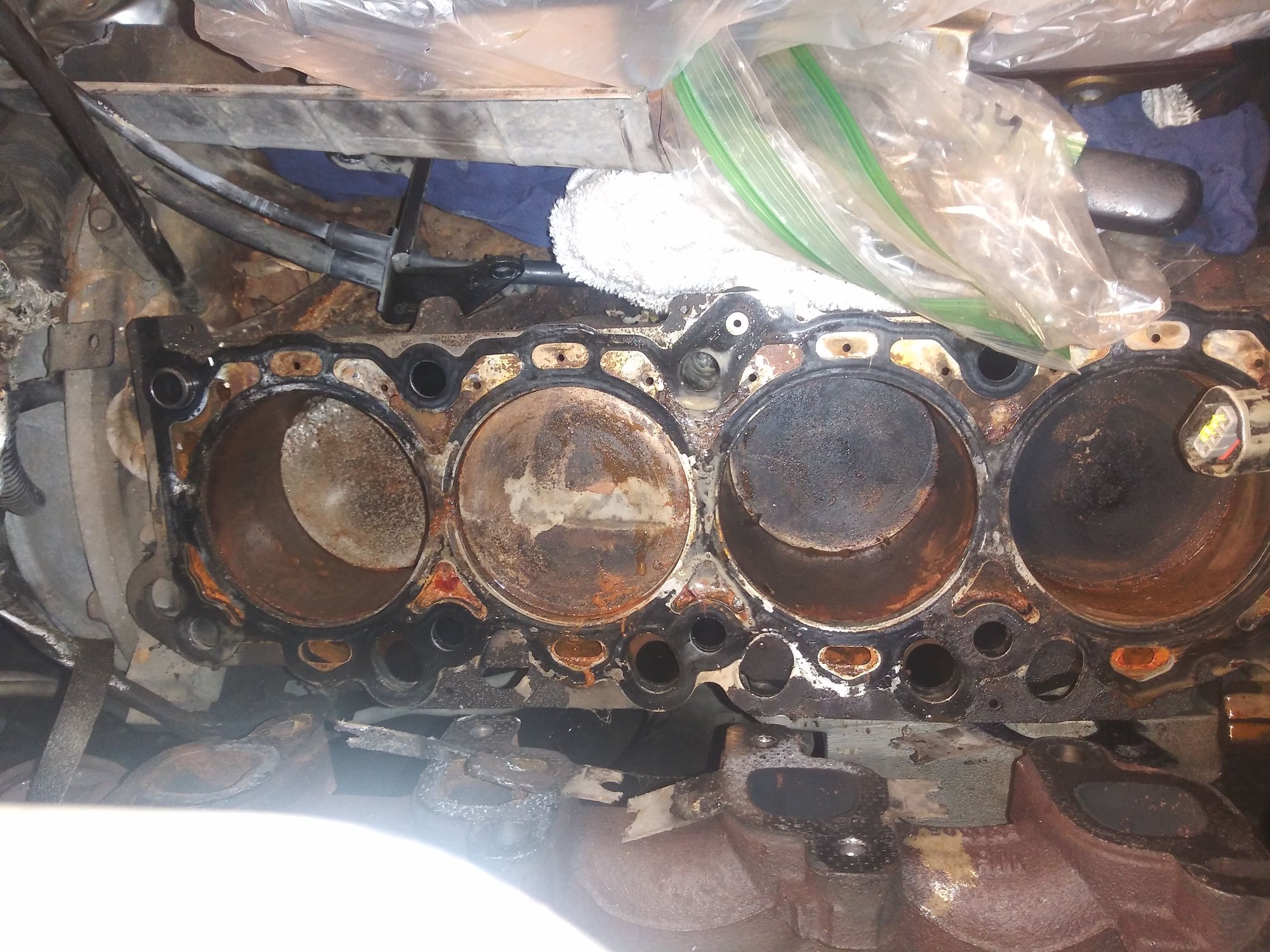

Do u think i could salvage the block thats in it???
Old May 2, 2019 | 10:51 AM
Posts: 87,483

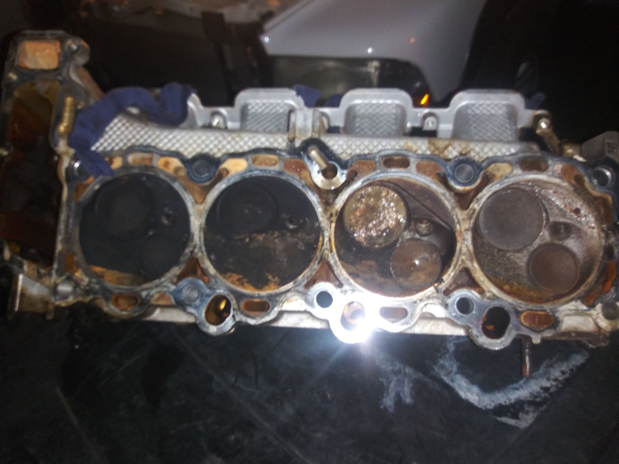

In one of your pics, with the piston all the way down in the hole, it looks like there are cracks in the cylinder wall....... If you can get a whole motor for 1200, that is definitely going to be the better route. You would spend close to that in machining, and the new parts to go with it..... (pistons, rings, etc.) Not to mention that one of your heads is trashed. (the one that got beat to death by bits of piston bouncing around in the cylinder......)
