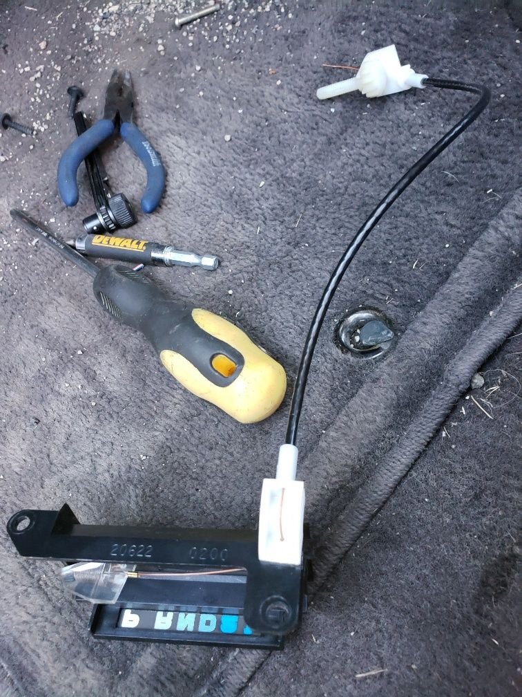

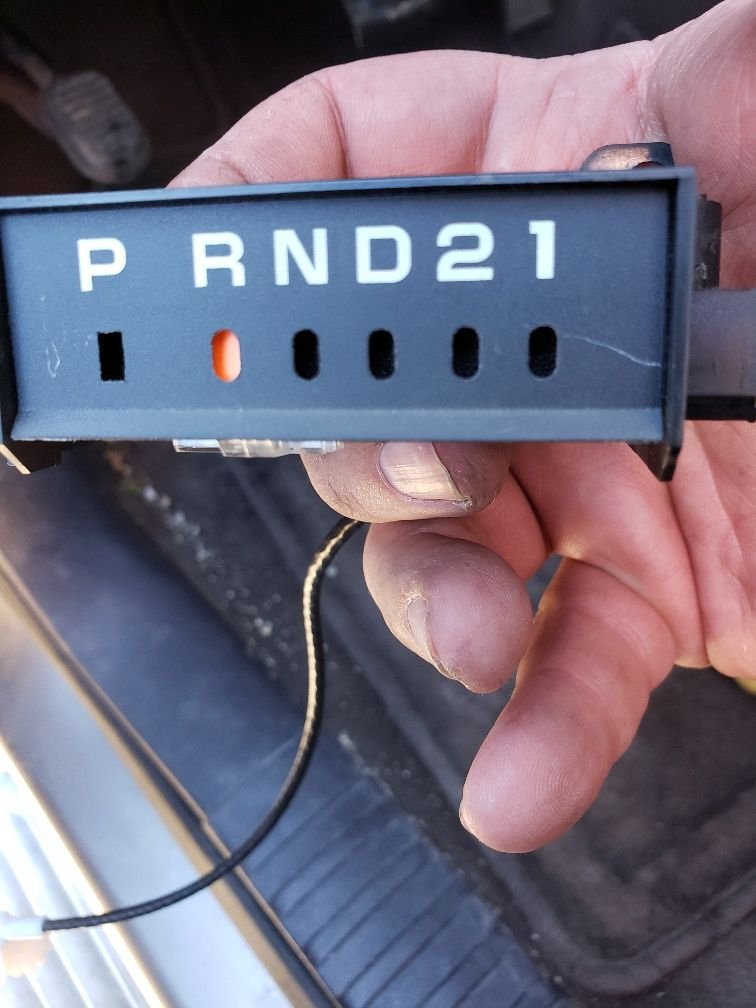

Well I'm an idjit...I was WAY over thinking this one...
I figured out why the shift indicator was not working...and I should have know better...the 2000 doesn't have the digital display for the gear indicator. The indicator is a bright orange "stick" that is supposed to fill the window below the corresponding gear.
Indicator assembly out of vehicle manually showing how the line is supposed to work

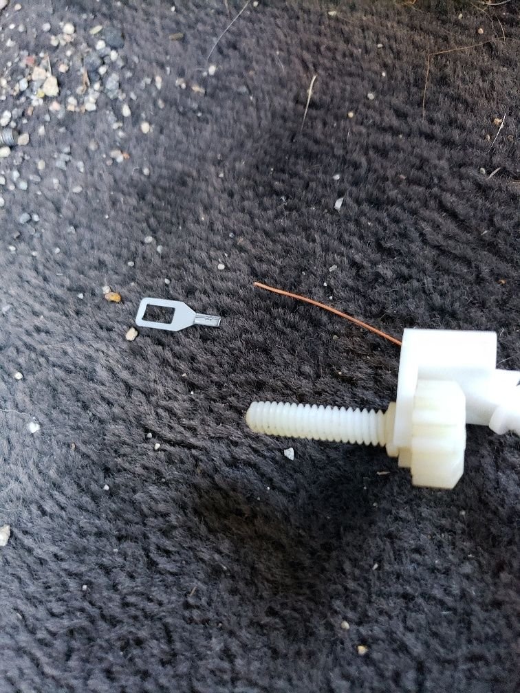

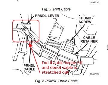

Luckily I still have the '00 2wd donor here at the house and was able to pull its indicator off...problem with that one is that the cable seems "stretched out" I cannot get it to consistantly adjusted...run out of adjustment screw before it's in the correct position.
Original assembly with missing end
Missing end next to the adjustment screw
Could it be a routing issue that perhaps I don't have it going the correct way? Has anyone modified or cobbled together a replacement end for the cable? I had thought of taking a round wire terminal and squeezing the hell out of it to make it oval (I know I cannot get it to the rectangle shape of the original) and seeing if that works on the original shift indicator...anyone one else have suggestions? Trying to wrap this up by next week so we can make the road trip to Colorado...And for those of you who would say "eh, just leave it and count clicks" not sure the boy nor his girlfriend are that capable on a daily basis, and as this will be a daily driver for them I want it as safe as possible...
