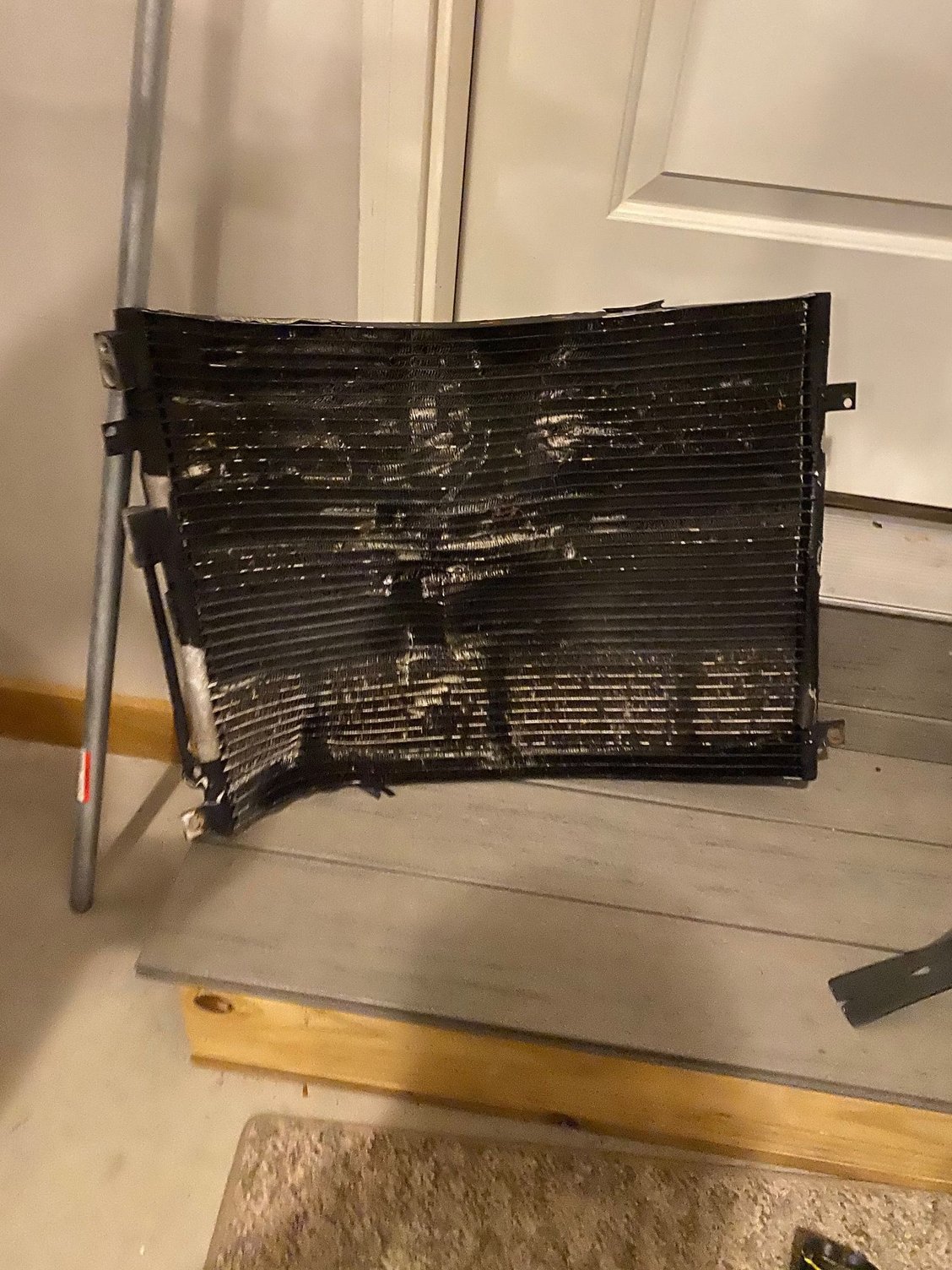

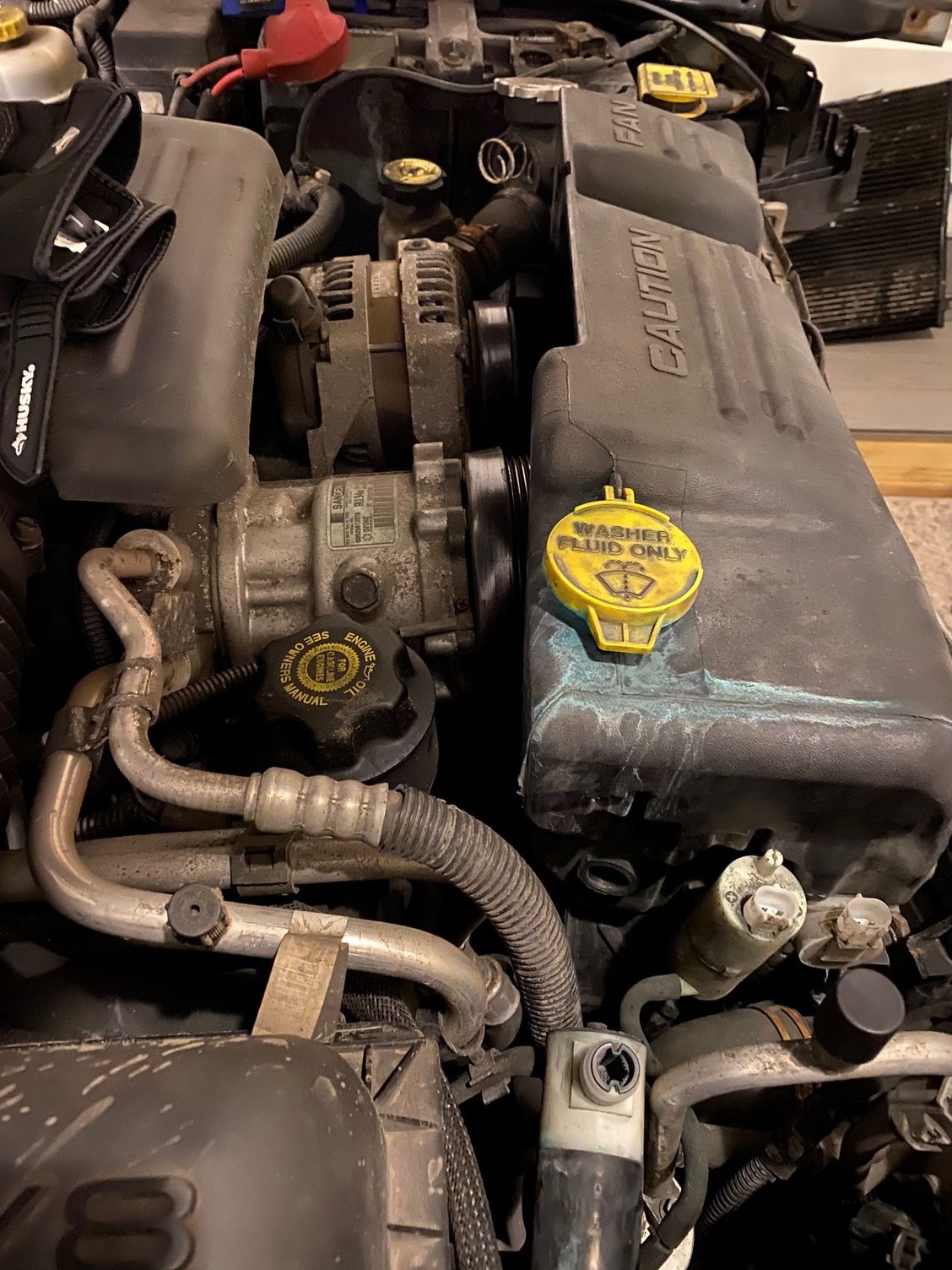

Inside looking toward front, where radiator pushed into fan.
Removed condenser

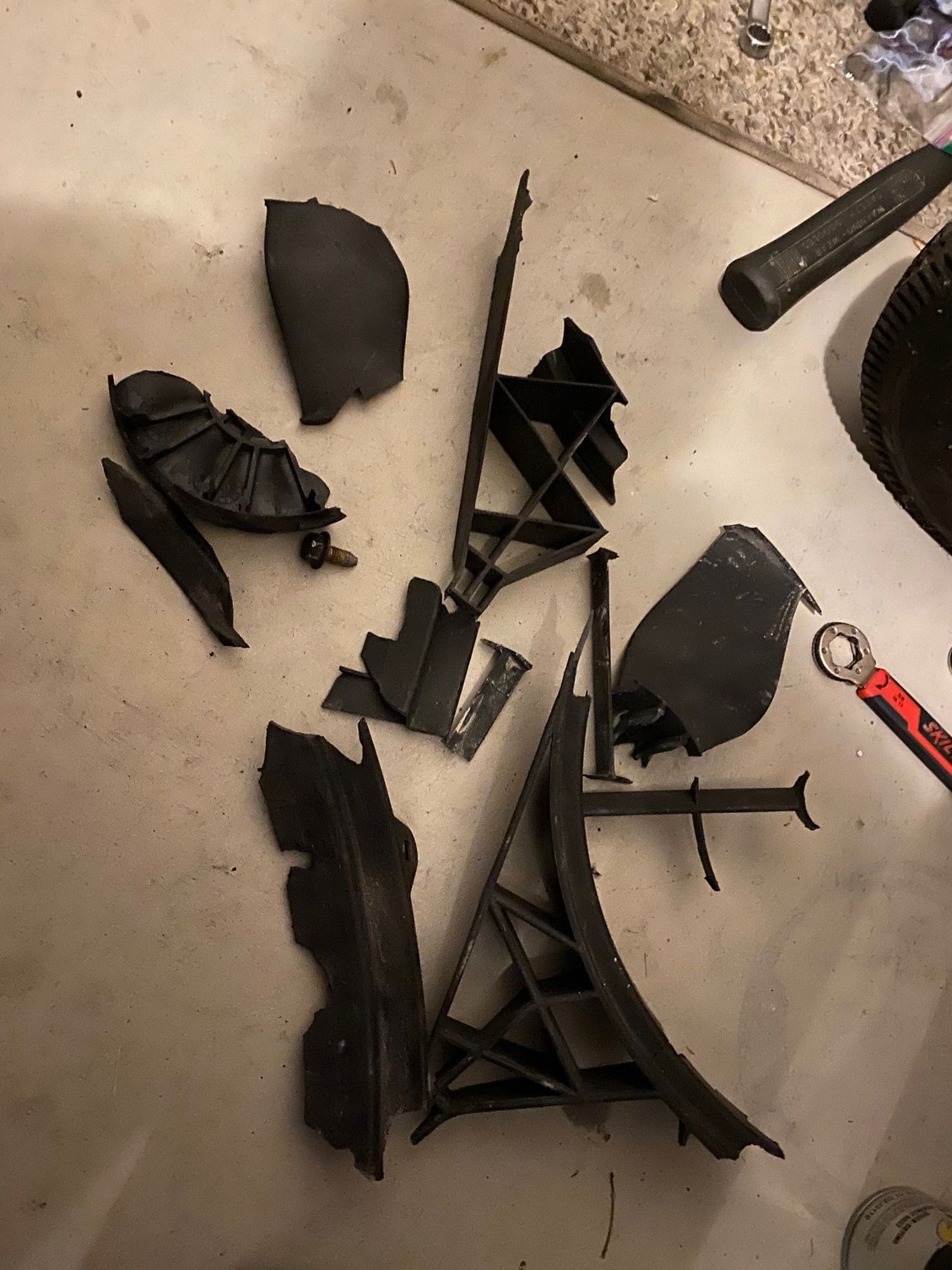

The plastic pieces below the fan laying inside.
straight across view from passenger side, does the works behind the reservoir look bent upward to you? Bad?
Alright, progress on dismantling! Bumper is off, condensor was barely hanging on as well, removed it easily. Still have a stubborn nut on the right side (facing the hood, drivers side) before I think I can remove the reservoir and fan shield to better get at the radiator.
All that said I did get down in there and pulled out a ton of shredded black plastic pieces which I assume were some sort of cover for the fan. The fan itself is completely messed up, from the radiator being pushed into it, which in turn looks to possibly even have turned the engine off kilter a bit, there's also a heavy round disc in there just laying inside connected to something (fan motor I assume) and there's a belt twisted. Oh and the plastic piece that it looks like holds the radiator and connects to the fan shield/washer reservoir is snapped of course.
Which again leads me to the question on if this novice repair guy has the skills or if it is even WORTH it to continue. I want to fix it so please say yes, that said if I am now in for even MORE $ for parts for fan, fan motor, compressor, radiator, tubing....not to mention the bumper
More photos are attached, if the mods don't like all the photos I'm happy to remove and can set up a library somewhere. If you want any angles to see better let me know, I am hoping to get that nut removed from the shield and a better look at the radiator soon, the goal was to get all the bad parts stripped off to see what I need to replace. I'm just worried it's more than I want to spend now that I see what happened to the fan.
