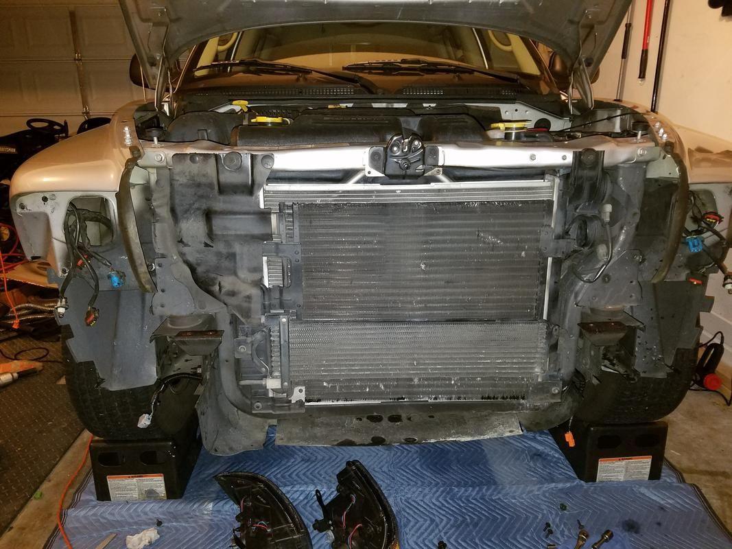

I went through the same dilemma when replacing my radiator but keep in mind, I have a Dakota. Not sure if they're the same for the Durango. Anyway, this thread describes the HD cooling radiator vs regular rads and what I replaced my radiator with. https://dodgeforum.com/forum/2nd-gen...-radiator.html
Here is how the front looks with the heavy duty tranny cooler seen at bottom (again, this is a Dak).
