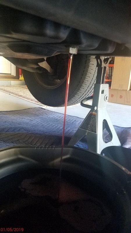

You don't drain it all, one shot... you do multiples. It takes 3 drain and fills (driving in between) to effectively replace all the fluid. Suggest you check the fluid level before draining and make sure it's full, then measure the amount you drain out and and replace with the same. I've got the 545RFE and drain and fill once every 25K. Currently at 320K with no issue. I also use the ATF+4 from walmart (supertech) and it's worked fine. PS: this is all much easier if you buy an aftermarket pan with a drain plug, or drill your current pan and add a drain plug (I did the latter).

If you want to get the old trans fluid out quicker you can take the cooler lines off the cooler. Stick the inlet in a 5 gal bucket of fresh fluid and the outlet in an empty bucket and let it run in neutral (maybe cycle gears while holding brake). Just don't let it suck air. Drop the pan and change filter after and call it good.
That said getting a pan with a drain plug might be an easier option .

Yeah, I avoid doing that because damage occurs very fast when it sucks air. ATF+4 will mix with old fluid and work, provided that the tranny is not already screwed up, so there is really no need. I had some valvoline universal ATF in mine when I got it. I never bothered to try and extract it all in one shot. I simply ran drain and fills from there on, every 25K. I might have run shorter intervals to begin with, but I believe I did drill the pan the very first time after replacing filters. Dealing with all those bolts, the mess and sealing it each time is a huge pain. Drain bolt make things as simple as an engine oil change.
