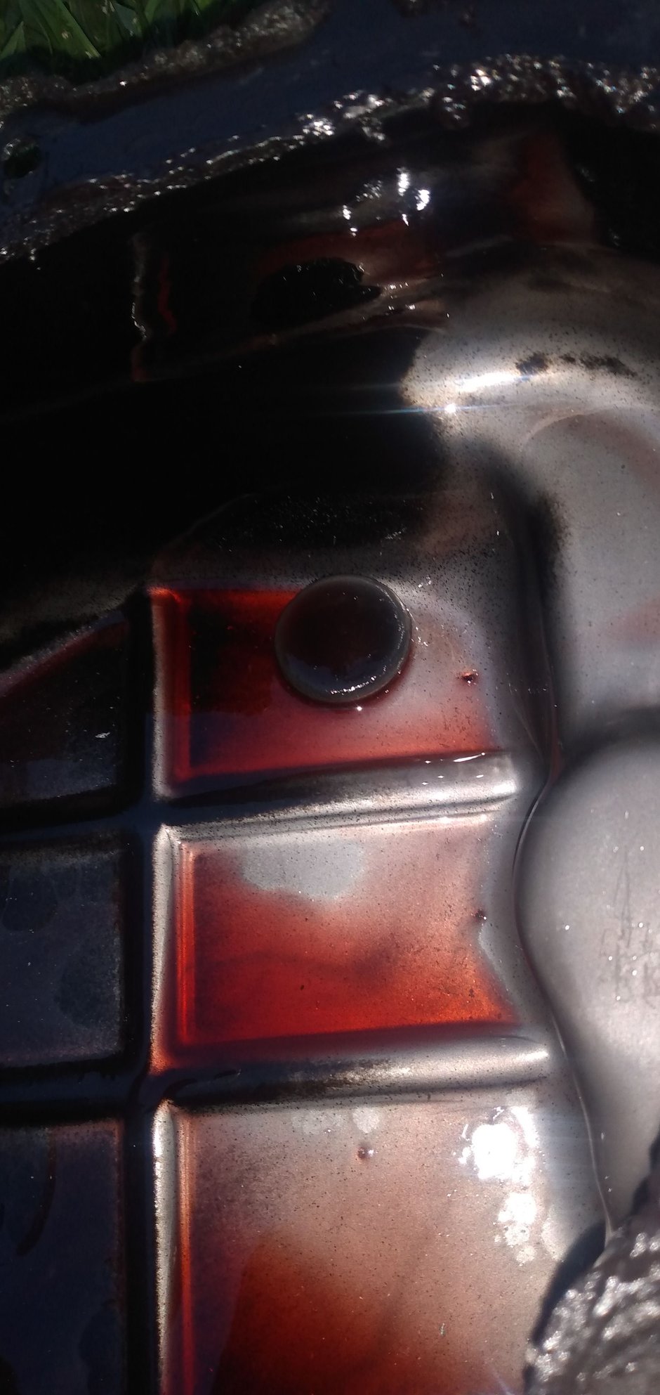

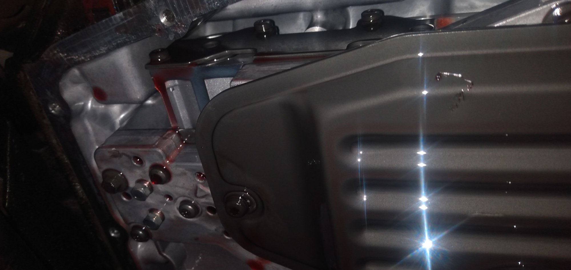

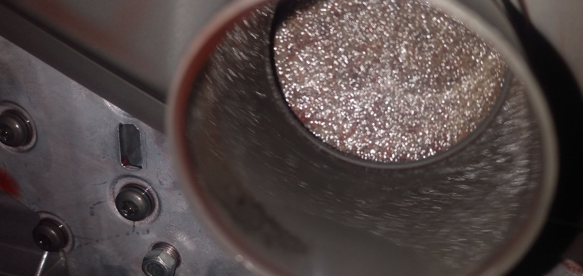

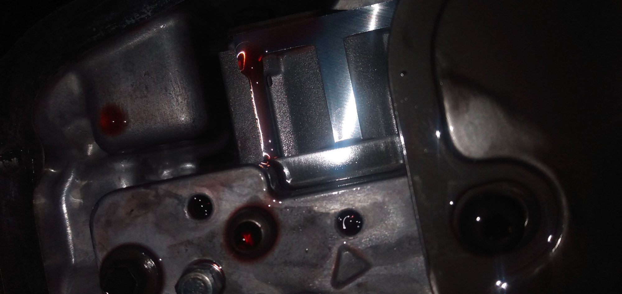

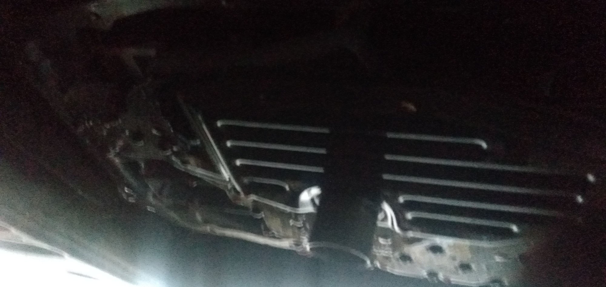

As it sits.
Clean pan .minimal residue on mag.
Pan damage front drivers side from front axle dislodging .on account of diff to engine mount loose bolts One month prior .action taken - remount bolts .front drive axle removed. Patched pun hole leak on pan(see image) Added I at of atf4. again same day 30 days out .fluid level at slightly above the two lower dots(operating temp)

If you don't see any metal piece's and the filters are in place and sealing. I would say the torque converter and pump gave out. P0700 is just to kick the lamp on. You need to have a hard fault like P0944 loss of prime code.
