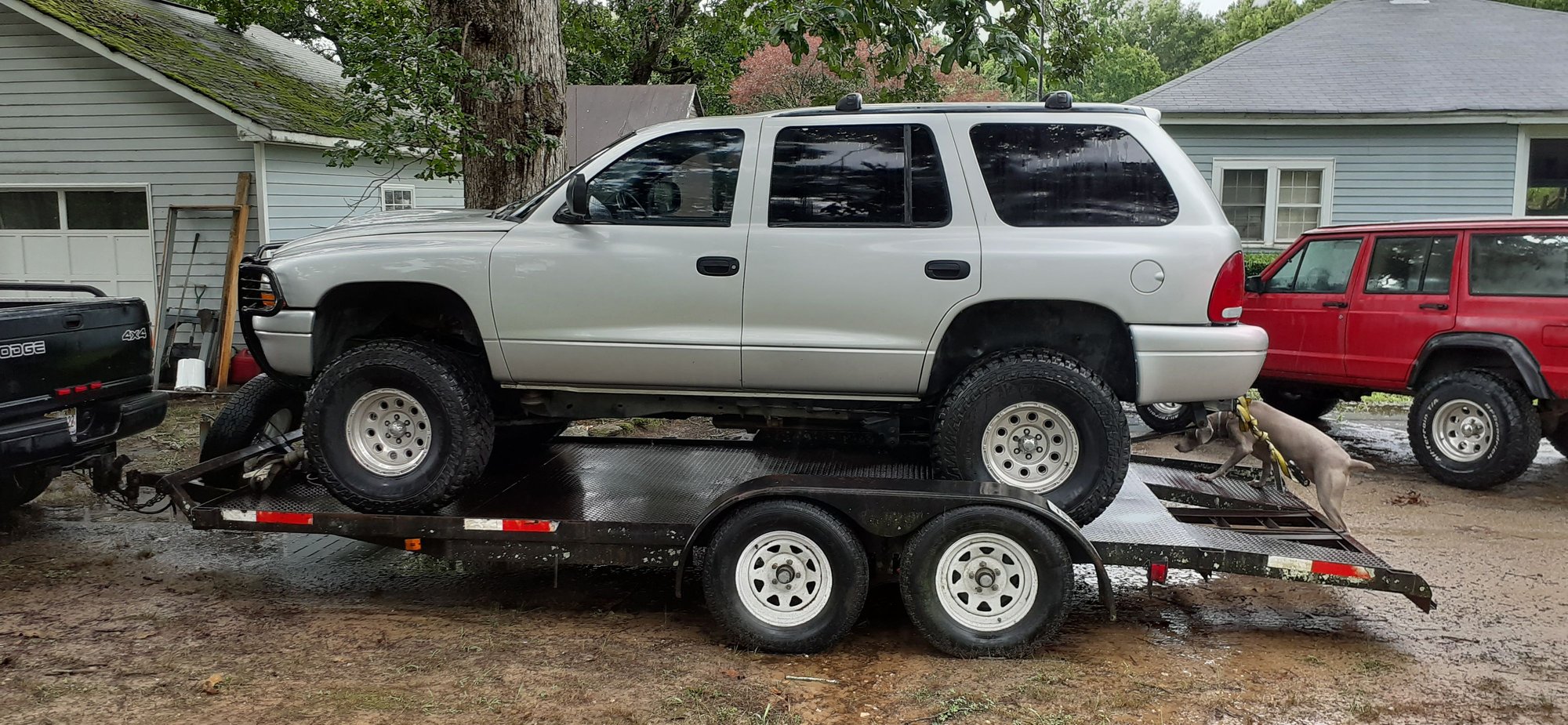

I purchased a 1999 Dodge Durango a week and a half ago, 5.2 with 44re may not have been the best decision I have made. I test drove the truck owner said it had intermittent transmission problems but the trans had been rebuilt and something electrical was wrong. The truck drove fine but in limp mode I believe never changing gears. The owner had a tech print out of trouble code PO753. After a looking up the code and possible problems I made an offer and bought it.
Hooked my car hauler to my Ram 3500 and brought it home, raining hard I left it on the trailer. Next morning I started it and backed it of the trailer shut it off, I got my code reader out ad pulled the codes P1765, PO340, PO743 and PO748 I had red about grounding the pink wire at the PCM and did that when I tried to start it I got the no bus. I took the ground of the pink wire at the PM and still had same result.
I have 5 volts at the map sensor and TPS and have unplugged everything I can find and the no bus remains unplugged Map sensor, TPS sensor, Crankshaft sensor, Camshaft sensor, Trans speed sensor on tail shaft still have 5 volts and no bus.
