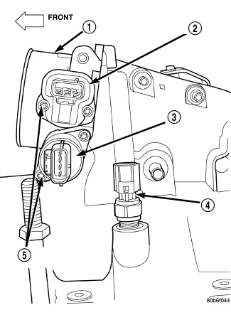

Make sure no vacuum hoses are disconnected, that would be my strongest suspicion given the circumstances. It could also be the IAC (idle air control) valve which is right below the TPS (#3 in the diagram below). When you replace these things (all the sensors you mentioned as well), replace them with Mopar brand as aftermarkets can cause issues. Finally, pull the neg battery cable overnight to reset everything after replacing any sensors.
