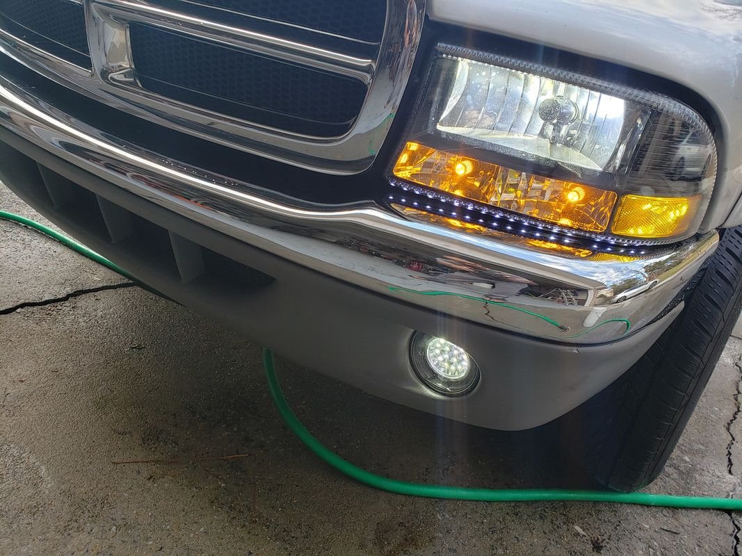

You have red flashers? Strange.... I thought they were all amber... this was an old headlight of mine.
Now I have these and they're clear. I have amber LEDs in them.
EDIT: Crap!... you did say "2004 Durango"... you're posting in the wrong forum here. Even so, all the pics of those I see have amber....
The OP is referring to the rear. The fronts are usually amber or sometimes white. The rear on U.S. vehicles, unless they sell a lot overseas, are usually red like the tail lights.
Well, hell. For some reason that didn't occur to me. Musta been sleepy. Scrap my whole response then.
