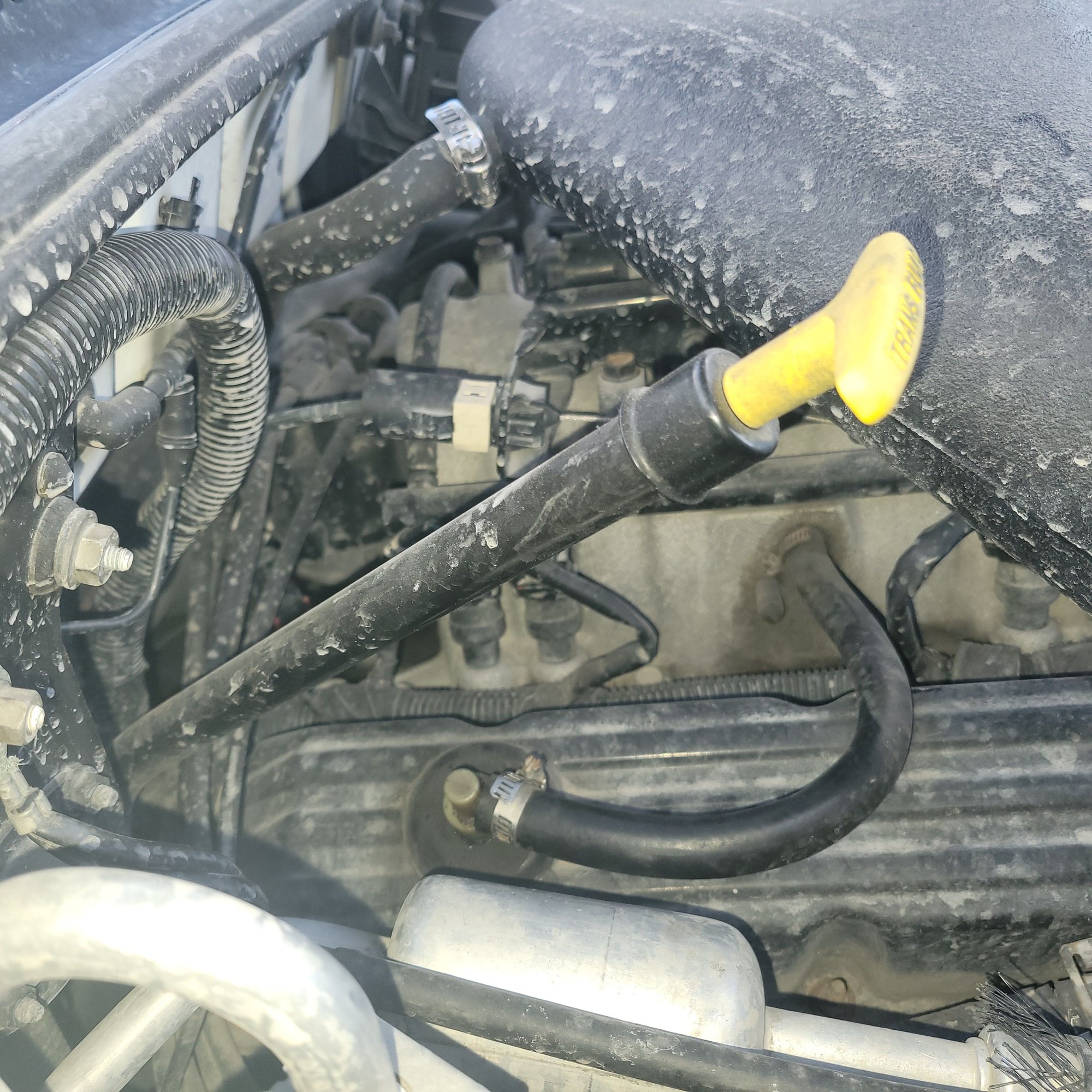

Old Oct 20, 2022 | 02:35 PM
LeonDuitz2009's Avatar
LeonDuitz2009
Joined: Jun 2020
Posts: 49
From: Canmore
So PCV is operating properly. Theoretically. Check the hose between the valve and intake manifold, see if there is oil in there.
yeah theres a enough to notice and form a drop on the end of the hose at the intake.
Is there supposed to be another hose on the driver side of the intake? I have a port on that side that is simply capped off.
Old Oct 20, 2022 | 05:41 PM
Posts: 87,572
Likes: 4,232
Yeah, the other side should just have an elbow, with a hose that goes to a fitting on the air filter housing. if it's just capped off, that will put more vacuum on the crank case than there should be... Though, I am unsure if that would actually cause any problems.....

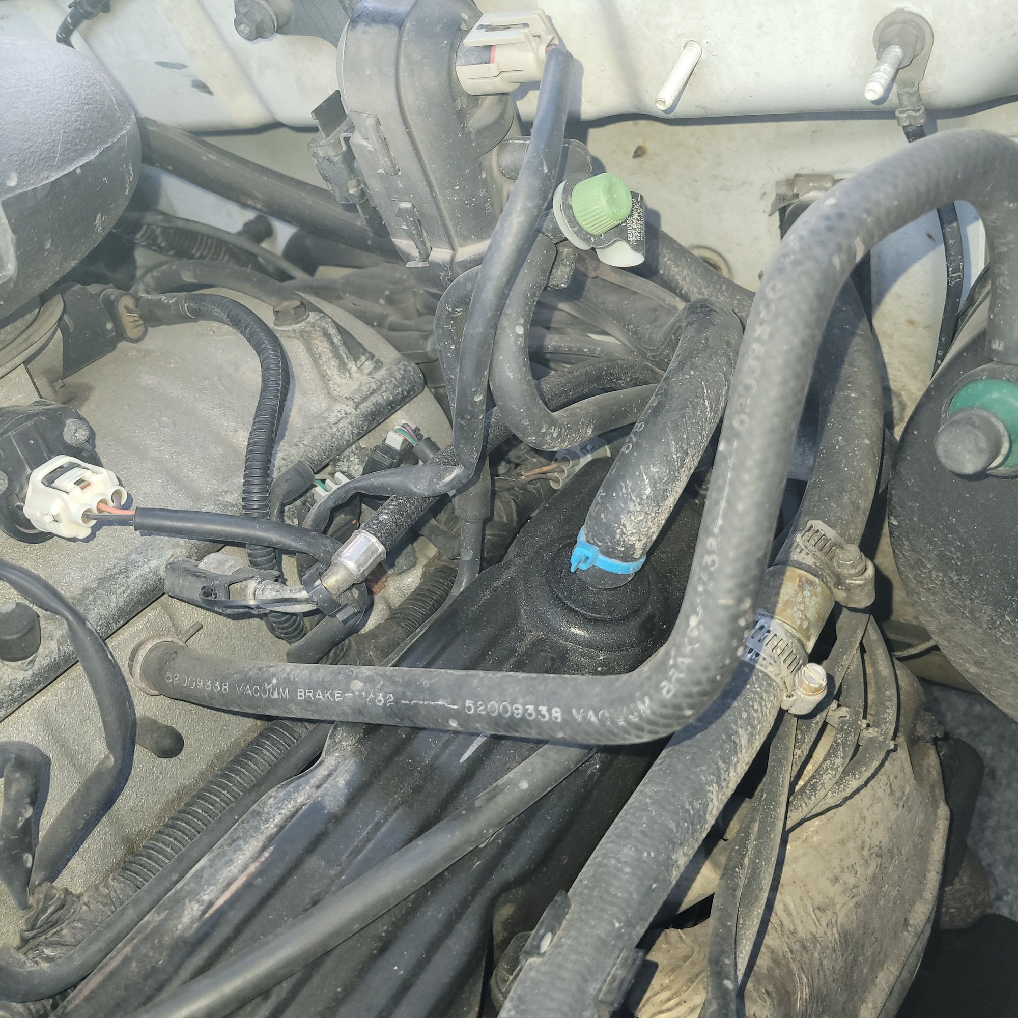

Old Oct 20, 2022 | 06:09 PM
LeonDuitz2009
Joined: Jun 2020
Posts: 49
From: Canmore
Okay, so the hose coming off the air filter housing goes into a rubber grommet on the driver side valve cover... second pic
