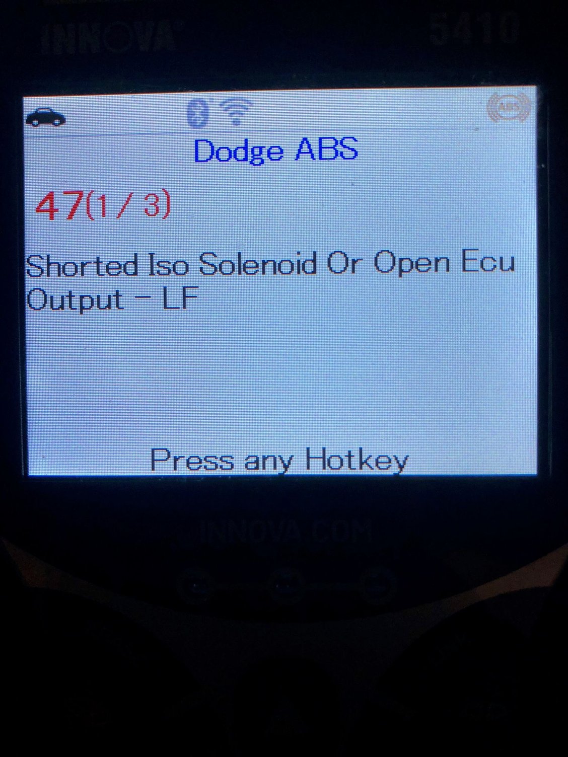

I have 3 pics attached with the Dodge ABS codes it pulled when I scanned it. From my quick search - this may be the module under the hood being buggy?
Old Aug 13, 2023 | 01:44 PM
Posts: 87,479
Where is the power relay? Think I would address that one first, and see if the other two don't go away.

Looks to be the one under the hood, and it appears as if the module either has to be replaced or sent out for repair.
