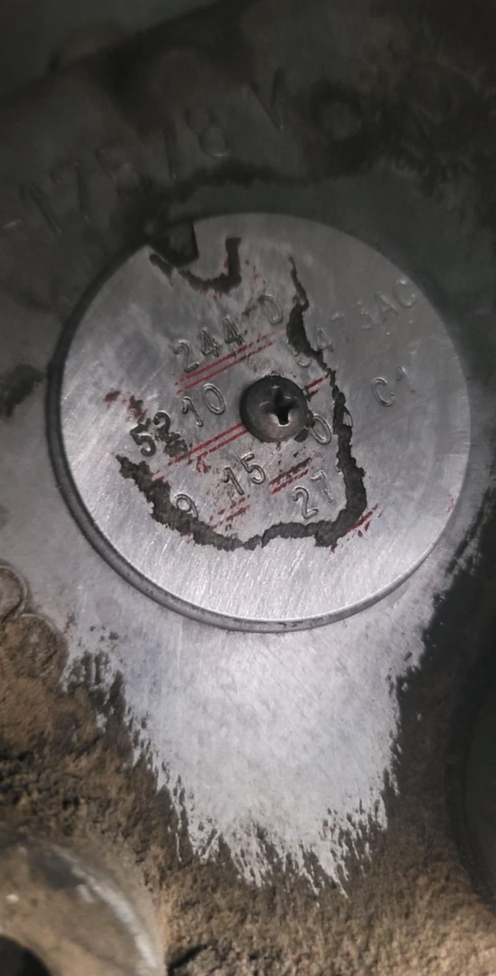

Tag on the back of my t-case...you can barely make out the 244D at the top...my brother
Tag on the back of my t-case...you can barely make out the 244D at the top...my brother "helped" by using a brass brush to clean off the tag....smh
Is there any wisdom out there that might help? Is the NV244 such a rare beast or am I looking in all the wrong places???

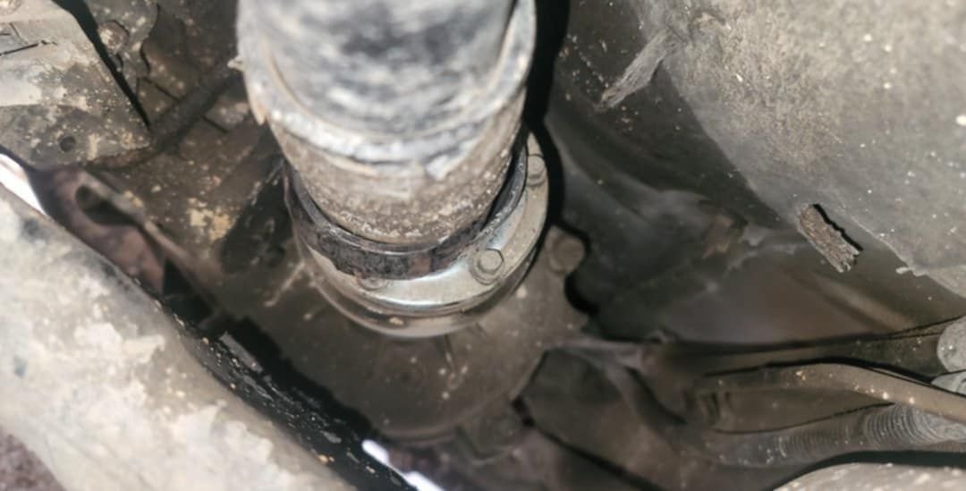

Here are a couple of pics of the front drive shaft and the damage caused by either it going or the t-case going...
When I grabbed the driveshaft it is wobbly as all get out...the front tires spin freely while the back don't...

The difference is probably how the front driveshaft mounts...... I don't know if that cup-style drive can simply be bolted on to the other case..... I wouldn't be surprised if you wouldn't need to change that output shaft there as well though......
