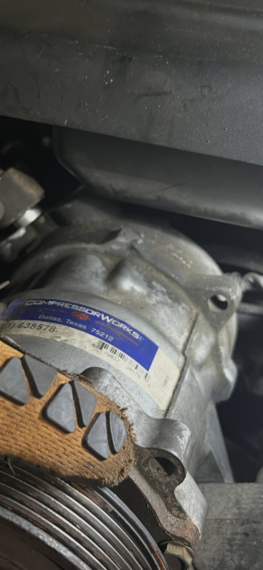

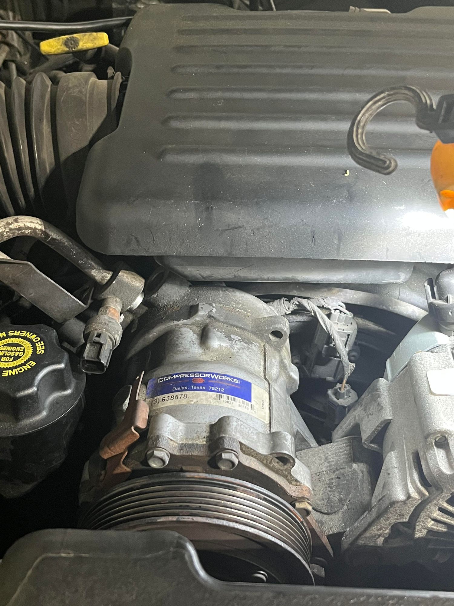

Well, I went to roll out remove the old AC Compressor and it's being blocked by the black intake cover. Is this black plastic cover actually part of the intake with a gasket and such, or is it simply a cover? Easy to remove and put back on?
It really looks like the darn AC compressor wont roll out of there without removing it...
