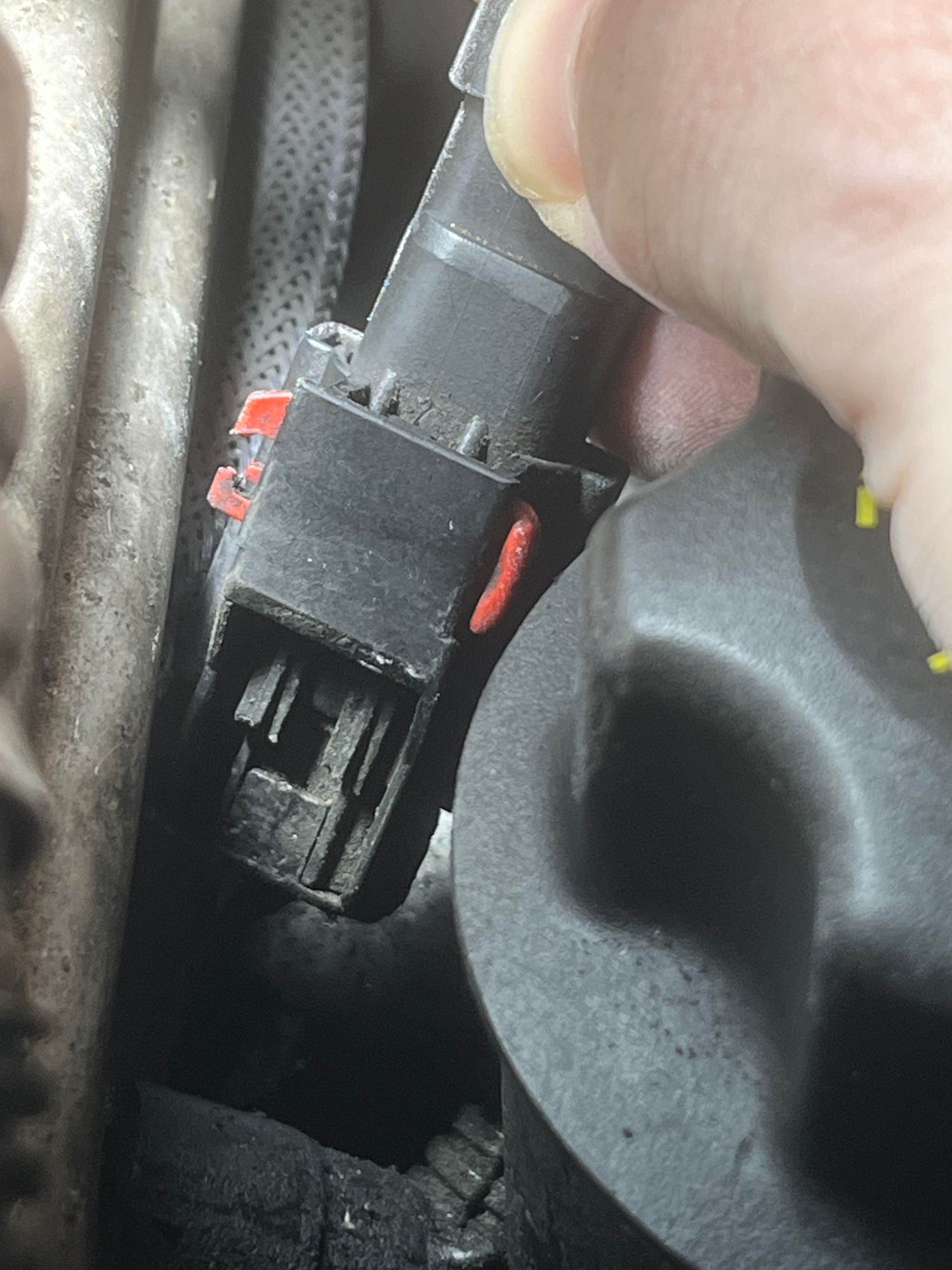

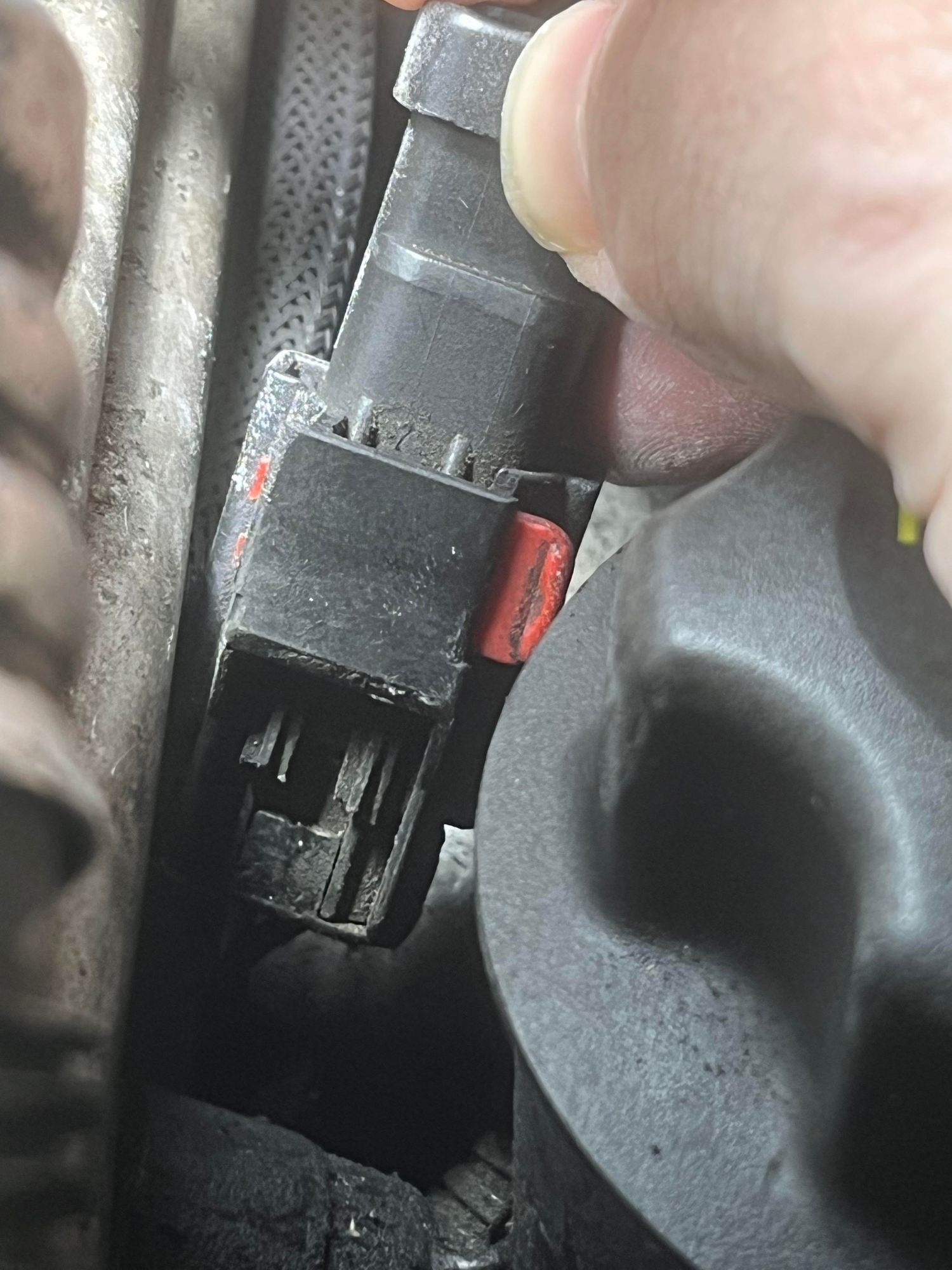

Hi, I have a 2000 Durango 4.7L that I'm trying to diagnose why the AC compressor isn't coming on.
The Freon level, as measured from the low side, is about 30 psi. But the darn compressor still isn't kicking on. I can slowly turn the clutch and it will turn with a little resistance. I've measure voltage at the relay, and it's getting 12 volts. I've put in a relay tester in the AC relay slot and hit the tester's on button Still, the compressor isn't kicking on when the cabin is set to max AC and the low side is showing about 30psi.
There isn't a check engine light on.
I want to verify the connection at the AC compressor is getting power, but I can't get the darn electrical connector off. I've pushed the darn red tab to both left and right and still can't the pry the connector off.
Any ideas on how to get the electrical connector off, or about this issue? Thanks.

Push IN on the connector, completely remove the little red tab, I think you need to press down on the part sticking out the other end as well, you know, the one that looks like it is broke?

Red tab should be out, not necessarily removed. You might need to spray a little silicone into the switch and remove it with pliers. Sometimes things get stuck. It's why after any plug removal, I coat it with dielectric grease. You might have a bad clutch. I replaced mine with the compressor still on.
