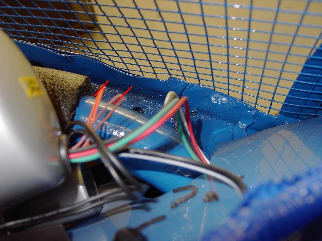

i ges ur right 95 to 96 there are wires looped in the back ...brown and orange ...im gesing the orange is and illumination wire ...wat do i need to do with the brown one
http://i240.photobucket.com/albums/f...r/IM001326.jpg
http://i240.photobucket.com/albums/f...r/IM001329.jpg
^^^^^the red wire going into the pcm is actually the brown one on the tach ..i had to add on to it because it was to short

ok good this is the easy type...
In the pic that i modded for you... I need you to cut the loops at the ends like shown... and just use a little electircal tape to isolate each one... so you should now have 2 brown wires and 2 orange wires...
walla done... it will work fine... this is how you select how many cylinders you have
leave the wires as they are for 8 cylinders (this would explain why you are running half of what it should..)
cut the brown wire for 6 cylinder
and cut both wires for 4

ok... works fine ..thanx for all the help
