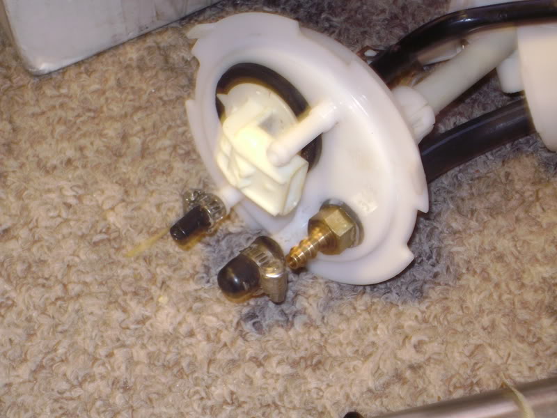

sppol boy mod is modifying the fuel pump adding a extraline for fuel return..

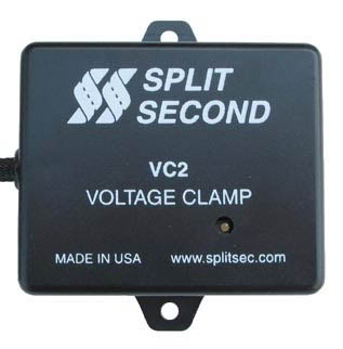

here is a voltage clamp that you could use.. dont need a missing link though

spool boy modded fuel pump

ok well why not use a missing link? isnt it easier and cheaper? how much is a voltage clamp? and you wouldnt be selling that modded fuel pump would you?

no i actually up graded that to different fittings and such and used it in my car..... their both simple to install. the missing link stops the map sensor from seeing boost.. the voltage clamp is just that stops the ecu from registering boost and freaking out. wires to your map sensor and stop the map from seeing over 5 volts...

so then why not stick with the missing link and eliminate havin to splice wires

in my opinion its one less part to fail in the turbo plumbing.. thats my .02 but i never said the missing link wnt work.... if you find one cheap use it. but honestly with a little reading you could go full ms for the price of a full fuel system using the rrfpr
