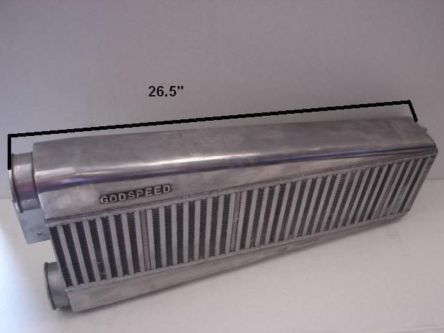

you probably could have avoided cutting the bobble strut if you got this intercooler:
[IMG][/IMG]
being that the piping will come out of the same side of the intercooler...this is the one i have.
