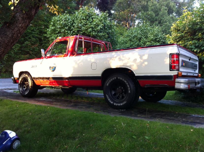

Got new wheels today on my D250. Mickey Thompson Classi III 16 by 8 rims with -12 mm offset. Rubber is also MT, Baja STZ, in 265/75-16. Sits perfectly in the wells and doesn't rub when turning (but it's VERY close up front).
How do I get more attachment space, what I have now is not much?

You can't get more attachment space, DF is limited. Use Photobucket or Tinypic and use those to upload pictures.
Truck looks nice!
