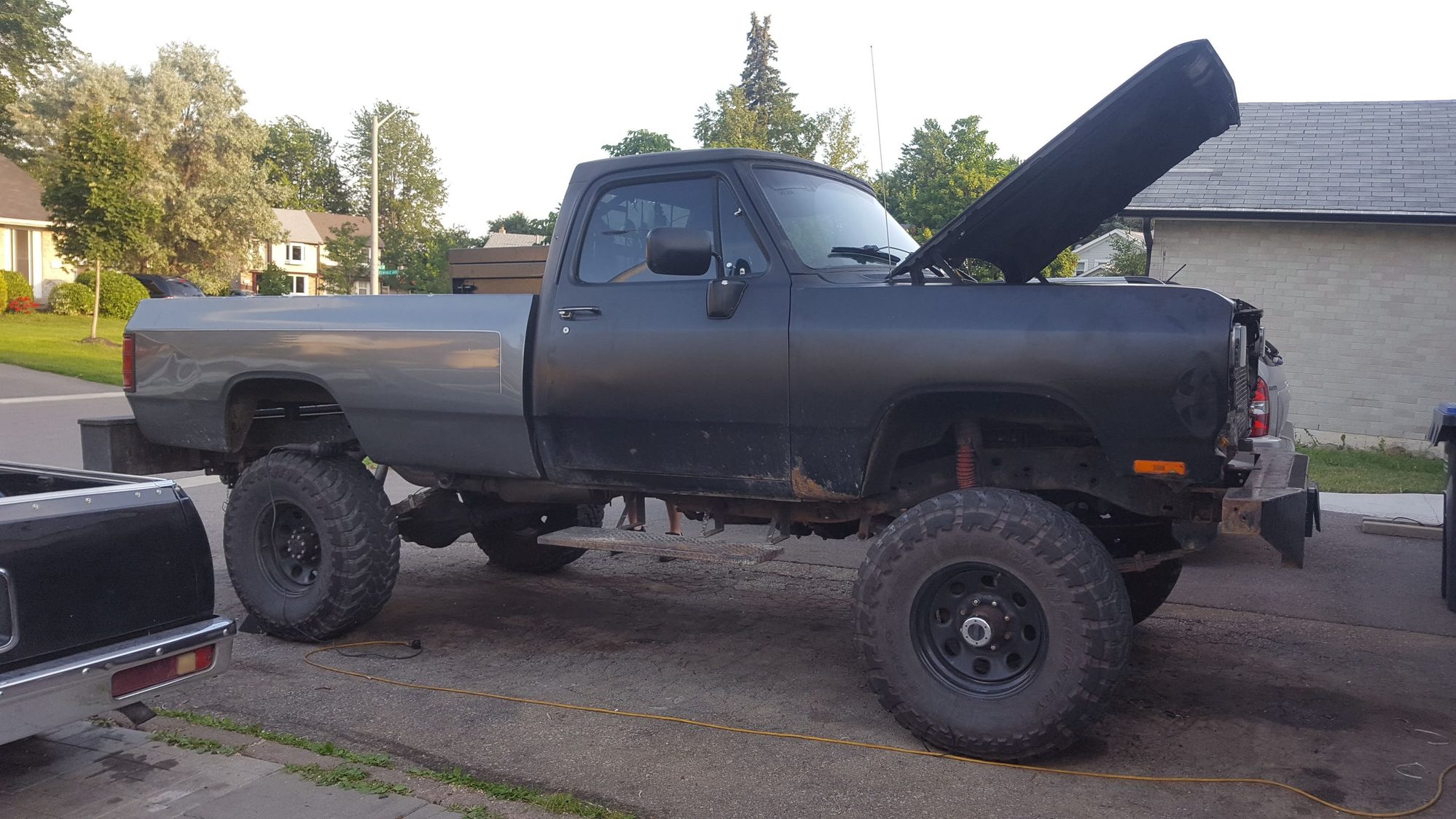

my ramchargers have 5/8" bolts in the rear. i never understood it but quite a few bolts are heavier than a truck. lift springs generally come with the shim to correct pinion angle. i am pretty sure my buddies truck is up to at least 6" of lift or more but also bought springs tall enough to remove the factory lift blocks. we did have to torch out part of the trans cross member so the front driveshaft would clear but he is running 37" tires. i think steering wise we may have only just installed a adjustable drag link. there is a Hyundai Tuscan parked on the far side of him in this pic.

ya i was talking about the rear springs. all trucks only have 1/2" bolts in the rear springs. i know i learned that when replacing rear shackle mounts on my 93 and had to drill out the brackets to accept 5/8" bolts.
i thought the shim usually helps correct the angle of the driveshaft so the pinion is parallel with the transfer case output. i don't think we have ever looked at cv clearancing but it is a auto. the front driveshaft would touch the cross member when installed so had to give it some room so it wouldn't rub.
