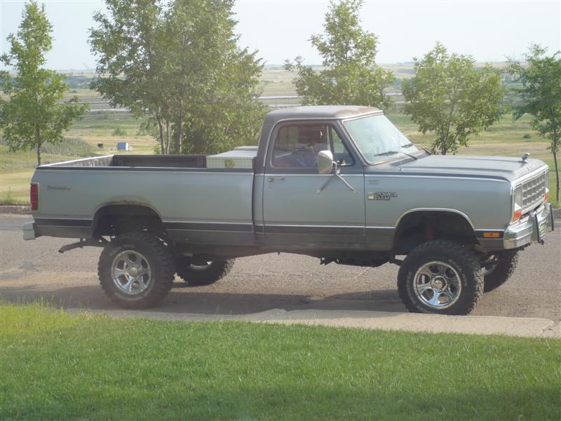

replaced all u-joints but still clunks when switching into gear. any idea what to look for. i'm guessing play in rear diff or could it be in trany or tansfer case.

What rear ends in it? How much slack's in it? 4x4s have alot of components to get the slack out of anyhow. How fast is your idle speed? Much over 650 will aggravate any slack. Also over time the accumulator spring and seals/bore can wear in the trans causing the low/reverse band to apply harshly.
Also check to make sure the kickdown linkage is returning to rest at idle. Controls hyd. pressure in the trans. Should have a spring on the linkage to keep it in contact with the pin on the carb.
Good lookin' truck BTW.
