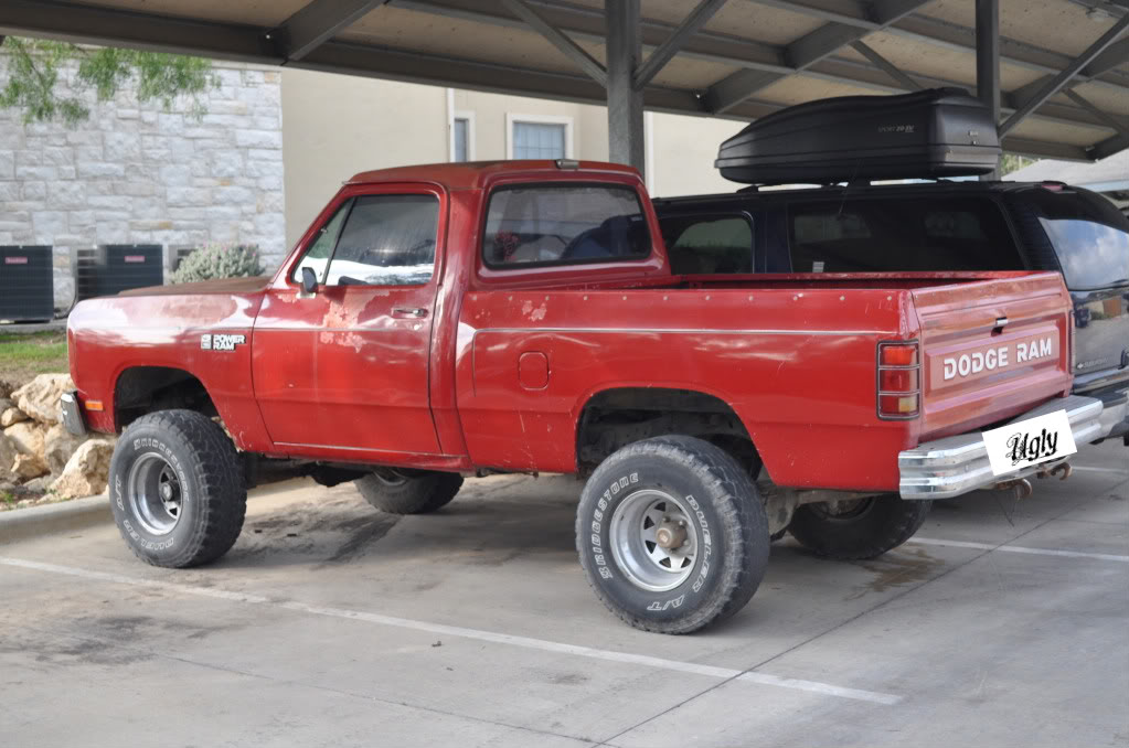

Ok, so here is what was going on. My best friend's cousin (the mechanic) came by and told us we were 180 degrees out on the distributor. Yesterday we double checked and it was right the first time.
I replaced the rotor, we started getting fire from the coil. First time around I tried to gap it with a spark plug gapper, but they are too wide. YOU MUST HAVE A FEELER GAUGE to get it right! The space is 2 hundredths larger than the width of a human hair. It has to be that precise for the coil to give off ample spark.
Once we did that it fired right up. Go figure.
Now it's just a timing problem, or a sensor or valve. Gotta track it down!
THANK YOU ALL FOR SUCH GREAT HELP. I was about to give up completely and take a big hit on selling it. You guys kept me motivated!
Now if I can only get the alternator to charge right.....
