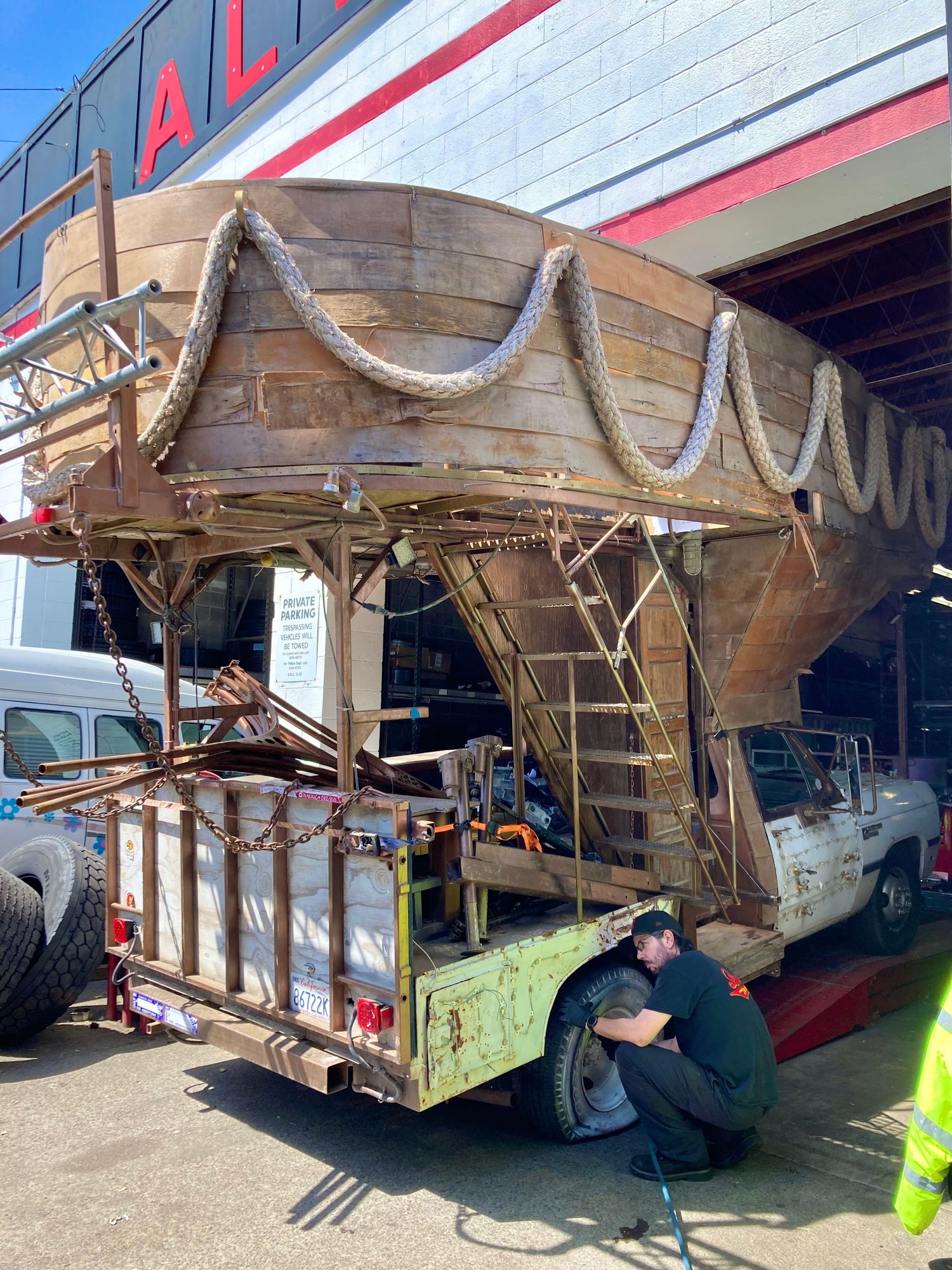

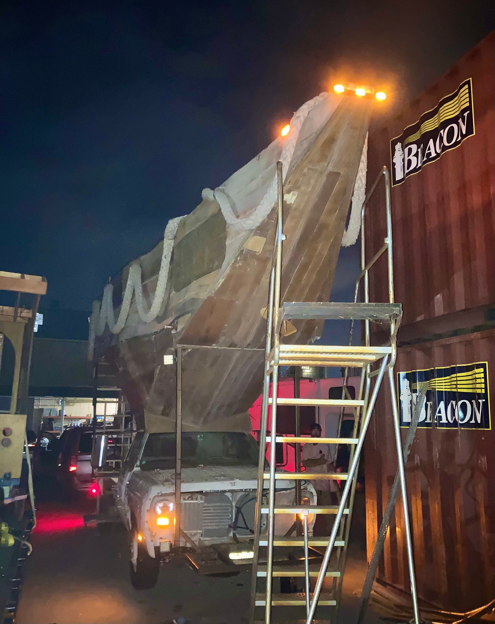

The only alignment shop in Northern California that can accommodate us. Vehicle weighs 11650lbs in road trim (no sound system, no inverter/batteries), toolbox full of spares: pwr strng, fuel, and water pumps; alt; all hoses, gasket kit, u-joints, mstr cyl. Body odd flat white rattle can (continuous touch up) and covered with over 3000 submersible WS2812 individuals addressable RGB LEDs
The only alignment shop in Northern California that can accommodate us. Vehicle weighs 11650lbs in road trim (no sound system, no inverter/batteries), toolbox full of spares: pwr strng, fuel, and water pumps; alt; all hoses, gasket kit, u-joints, mstr cyl. Body is flat white rattle can primer (continuous touched up) and covered with over 3000 submersible WS2812 individuals addressable RGB LEDs that get covered with 3-dozen photography diffusion umbrellas once at event.
…barely. Rear tire pressures are dropped to dangerously *just* off the bead to get <1/2” clearance at tightest spot.
…barely accommodates us. Rear tire pressures are dropped to dangerously *just* off the bead to get <1/2” clearance at tightest spot.

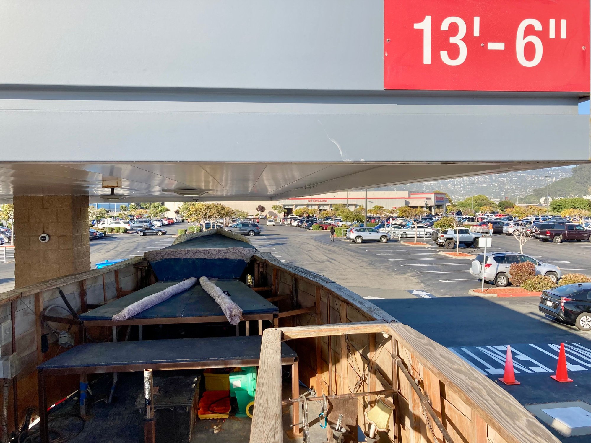

When we determined that Costco Gas derates their canopy heights by 12” (our vehicle is 13’8” static)

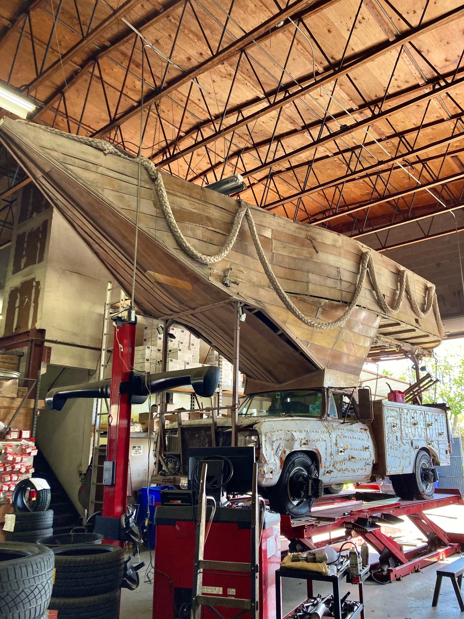

Prepping for California brake and light inspection, Rancho external reservoir shocks, fr infra-coil dampers

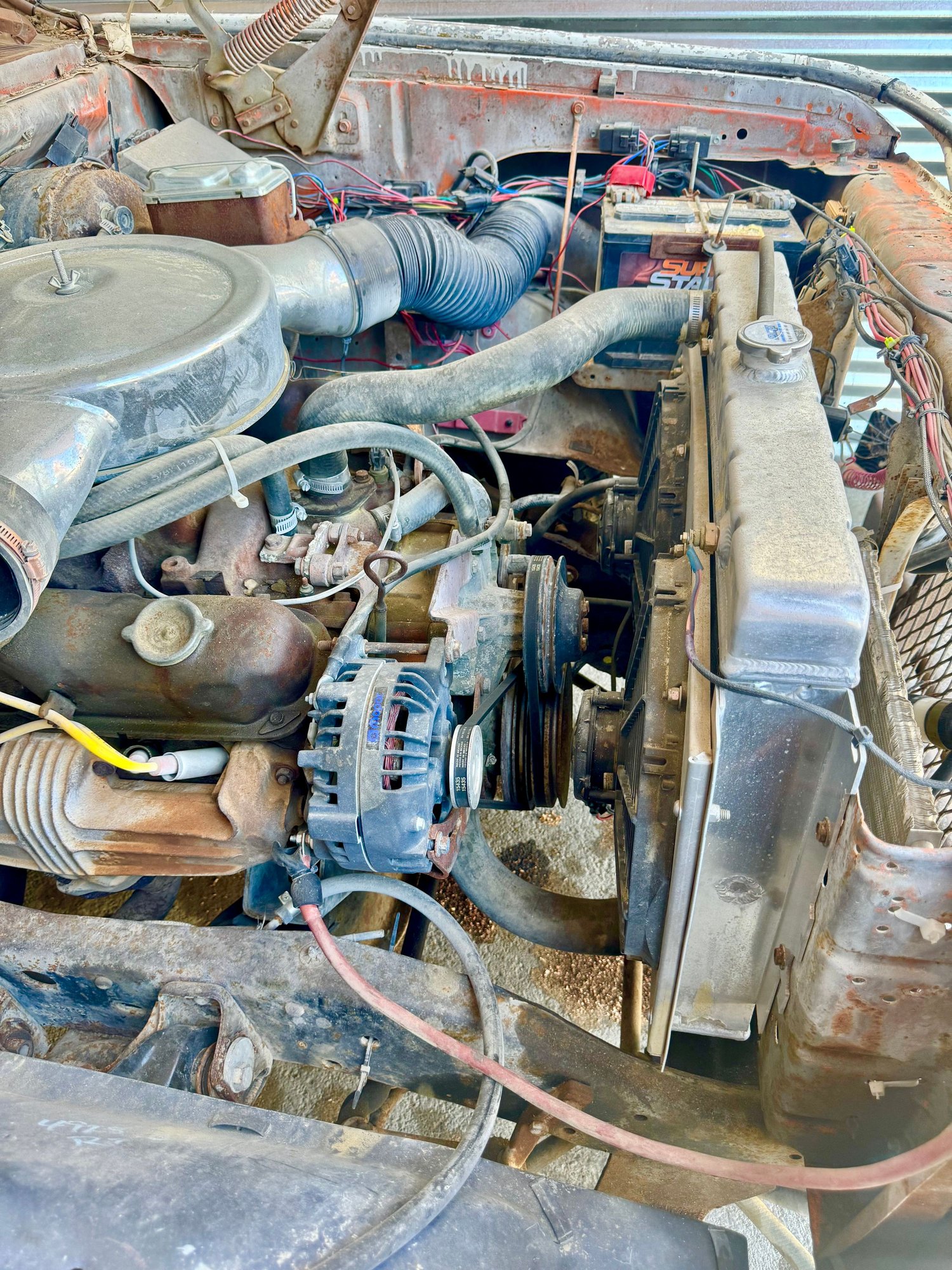

Black Rock desert is Ph 8.0 and all that petrified fish poop eats Fluid Film for breakfast. 4-row radcore and still can’t go over 58mph in The Sierras w/o heading toward heat soak. Holly Sniper EFI w/Hyperspark. 95A alt custom built to 120A, dual rad and tranny cooler fans draw 50A at full sing.
Black Rock desert is Ph 8.0 and all that petrified fish poop eats Fluid Film for breakfast. Vinegar power wash helps. 4-row radcore and still can’t go over 58mph in The Sierras w/o heading toward heat soak because this “displacement hull” may as well be a parachute. Holly Sniper EFI w/Hyperspark for eng mgmt. 95A mopar shell custom built to 150A, dual rad and tranny cooler fans draw 50A at full sing. 1200W 12V to 48V DC-DC battery charger.
Really would like to put 2-3x stiffer anti roll bars on it, but they don’t exist.
