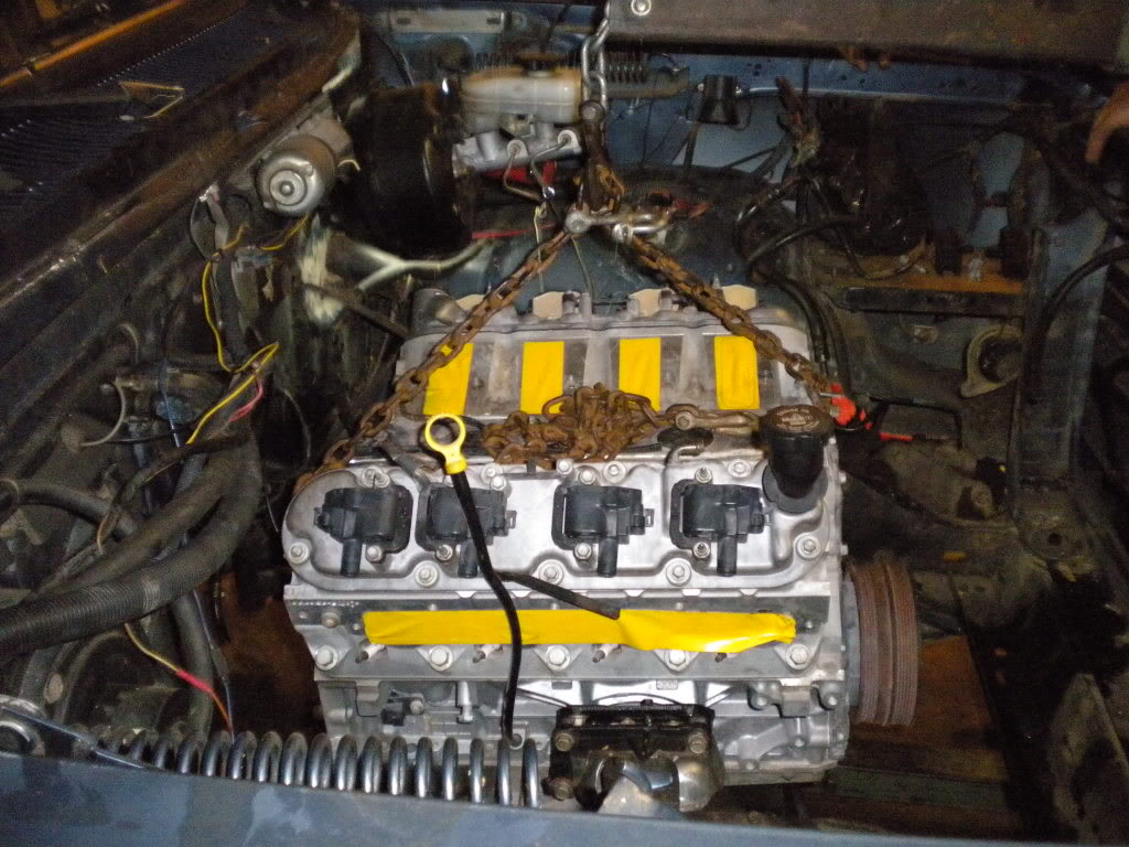

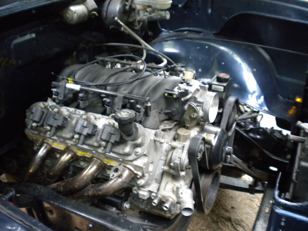

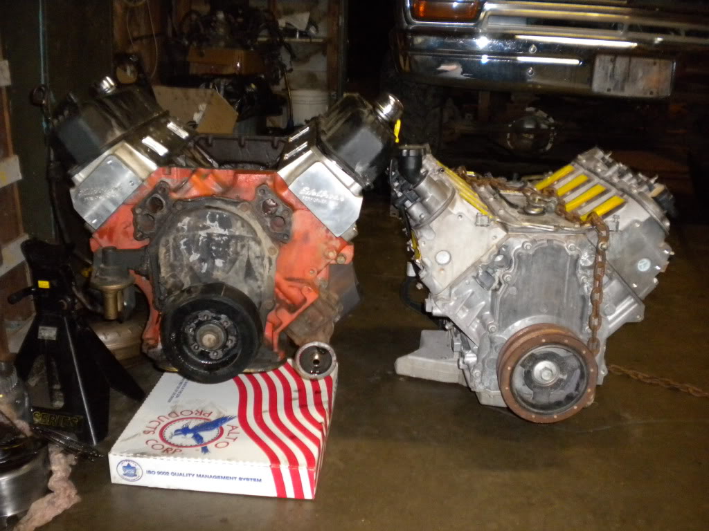

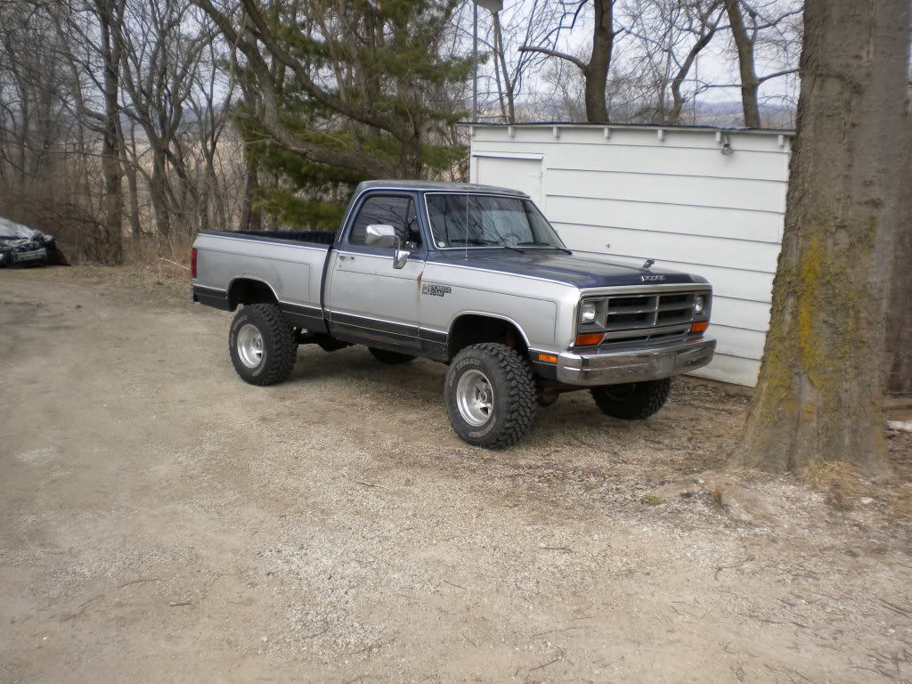

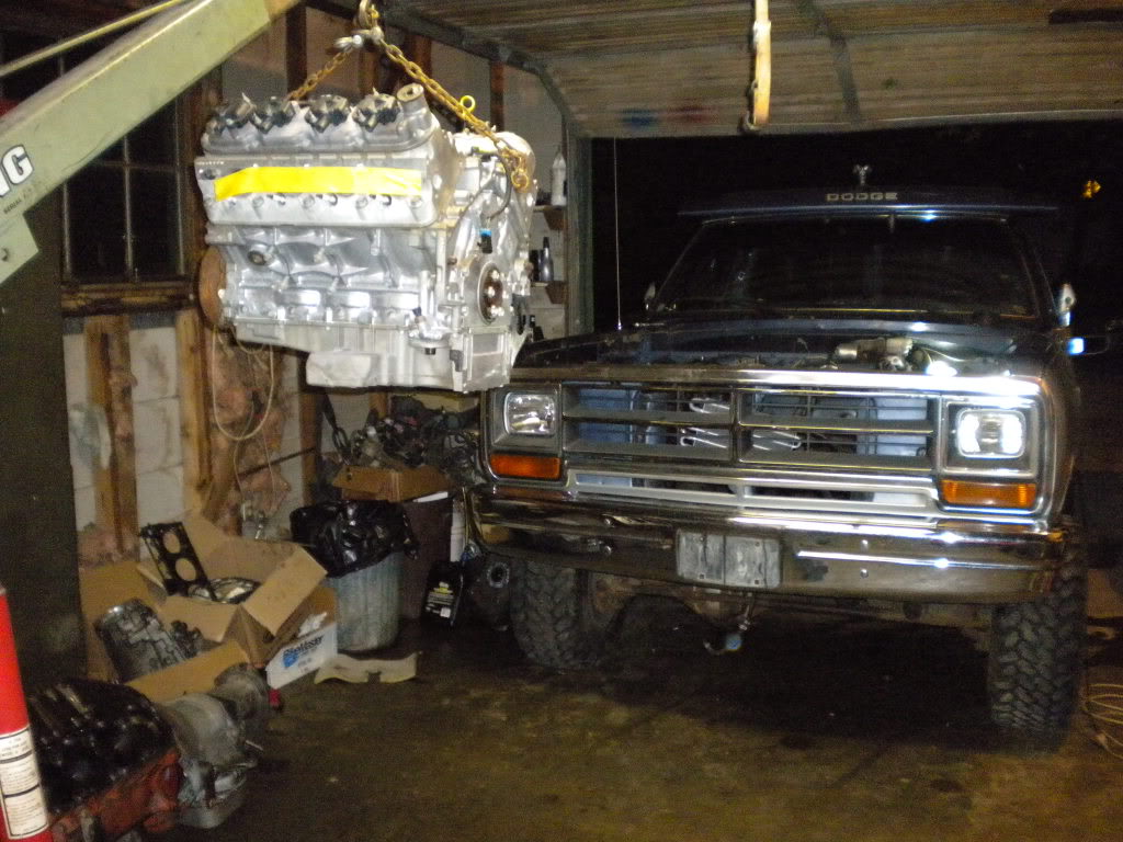

My latest project is a 98 corvette engine (346 cu.in.) ls1/4l60e/np208 into my 88 dodge ram.
I previously have a 440 727 and np203. the gas mileage was poor, overall drivability wasn't great, so I decided to make the swap for newer and better driveline components.
Best 1/4 wit hthe 440 was 15.7 @ 84 and best mpg was 9.5
I'm sure the ls1 will get nearly 19 highway and 16 in mixed driving wit hthe OD.
1/4 times are your guess as good as mine, but I think it should pull mid to low 14's
Overall I think the truck will be about 500lbs lighter the nbefore, I will put it on the scales to find out for sure though

I'm hoping to have it up and running within 2 months.
Will post updates.
