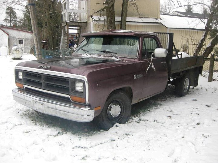

Bought an 86 d150 a while back, and its gonna be my summer project. First thing to do is get rid of the flatbed and put a box on it. What years could i get one from that would fit this truck?

I believe 82-93 should have the same bolt pattern. You may be able to go older, but the body lines might not match up.

ok great thanks for the info. Dumb question... but would it be a long or short box? I don't have the truck here and haven't seen it in a couple months pretty much just jumped on it.. cause for $500 id even use for parts

Jun 22, 2011 | 01:29 PM
looks like a long box

Jun 22, 2011 | 06:37 PM
Quote: looks like a long box
Hard to tell from the angle, but I'd have to agree with Wolfie on it being a long box.

Jun 22, 2011 | 07:33 PM
Wheelbase for long bed is 131 inches. Short bed is 115. That should help.

Jun 24, 2011 | 09:52 PM
thanks, found out is is a long box. Found an 86 long box but its a half ton.. the bolt pattern and everything should be the same though right?

Jun 24, 2011 | 09:55 PM
yup, should be no problem there
