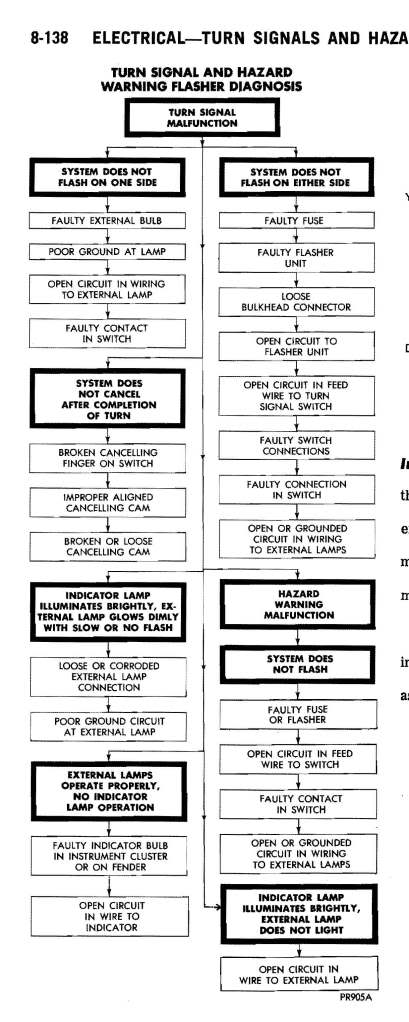

This might help.

DUDE!!!! pumbu, those freakin diagnoses sheets you just posted are TOP NOTCH!!! waaaayyyyy easier to read and understand..
