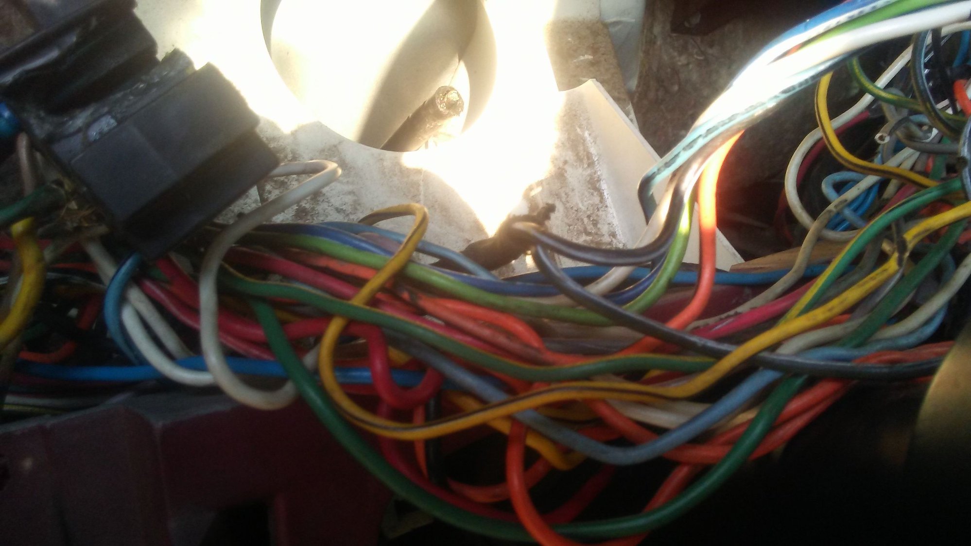

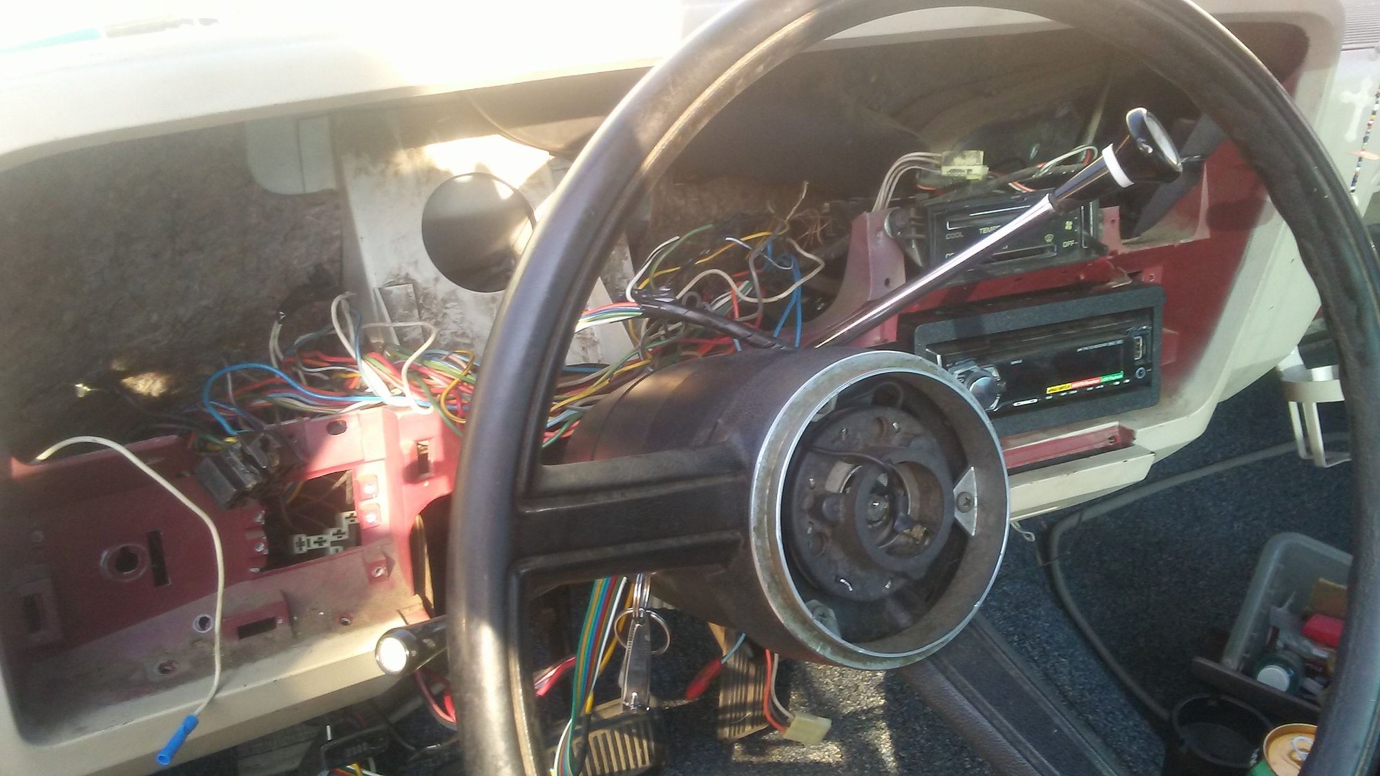

Old Aug 19, 2018 | 01:10 AM
  #30
timthemechanic's Avatar
timthemechanic
Joined: Aug 2018
Posts: 4
Originally Posted by pumbu
Just wanted to say thanks for sharing these! I just had a beautiful '82 D150 brought to my shop with the dashboard out and nothing but burnt wires.Now I can figure it out! And whoever took the dash out just cut the speedo cable/housing with a pair of dykes. But the rest of this truck is in great shape, engine compartment, everything is in good shape, intact. Body tags, codes, rust and dent free. Bed has a snap on cover. Old biker dude owns it. Just gotta figure out how to make something work for the headlight switch plug. Someone fried it when trying to fix the headlight switch. Looks like the ground wire - white/black stripe in dash fried all through the harness.
