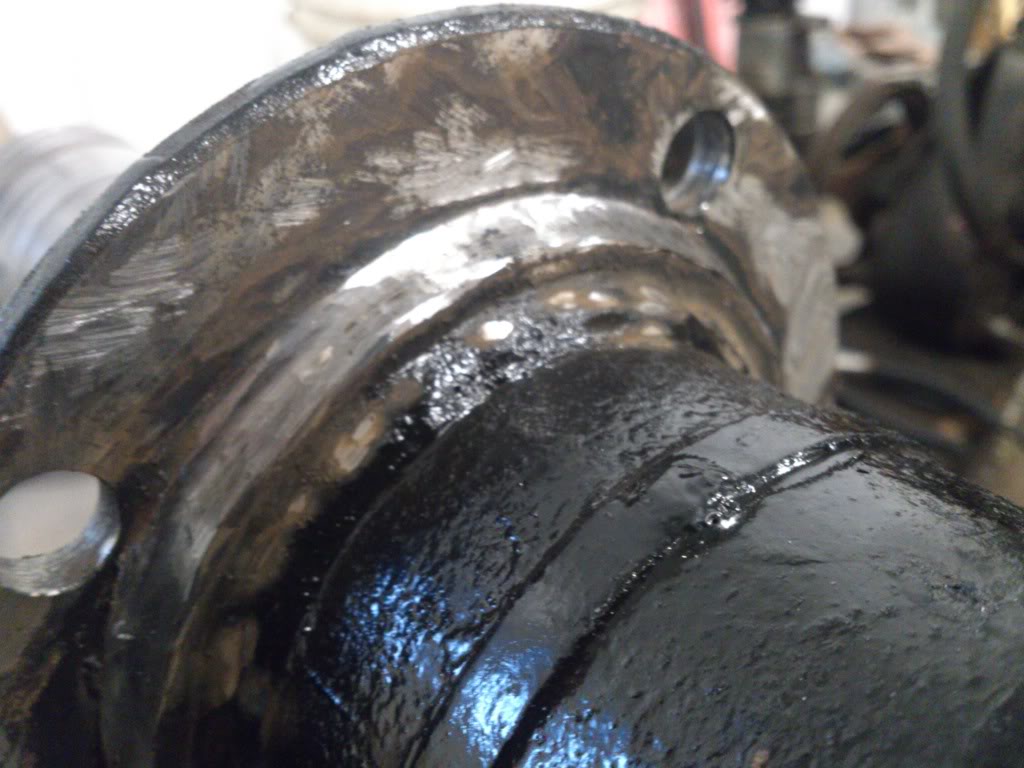

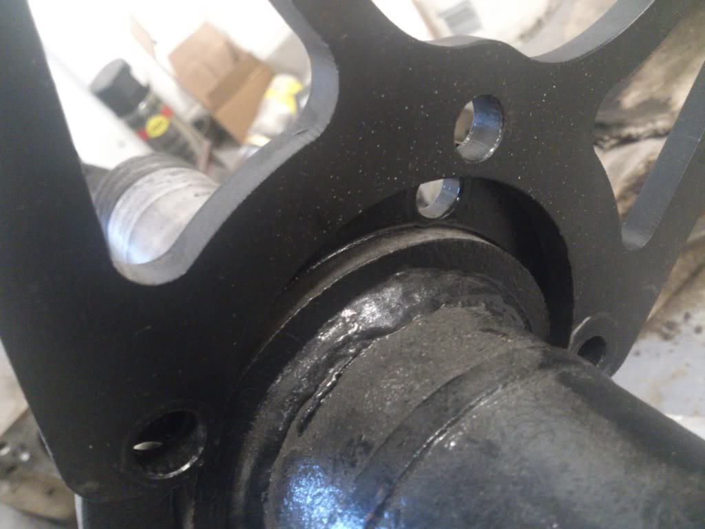

On a better note, the Dana 60 is just about done. Here's what I did to get the disc brake brackets to fit.
As you can see the brackets wont fit over the axle housing. So its going to take a little modding.
I took a grinder and ground the ridge down enough on 3 side for the bracket to fit over. Gave it a shot of paint after so it wasnt just bare metal.

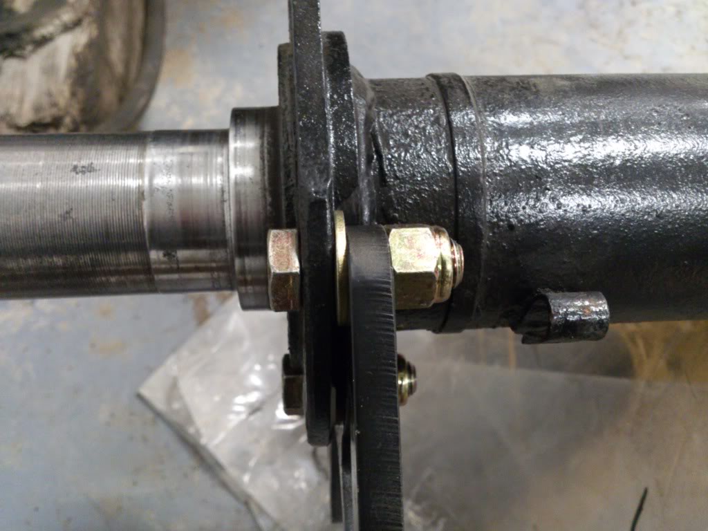

Here's the bracket bolted on and torqued to 55 ft lbs.

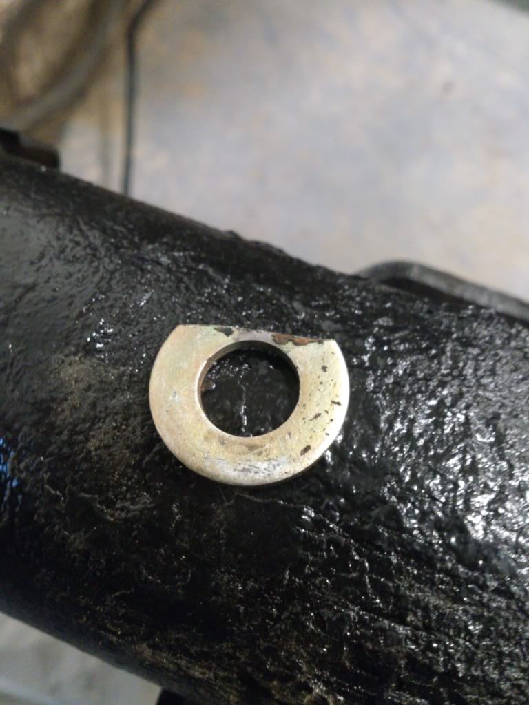

The brackets didnt come with spacers, so here's one of my crudely made ones. Just took some grade 8 washers to the grinder and voila! I used on washer for each bolt as 2 spaced it out too far.

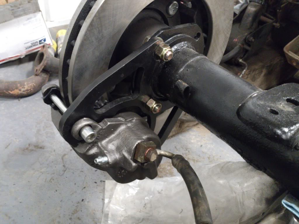

Here's this side all done. Looks pretty good IMO. I used the front soft brake lines off my '83 D250 because the ones for a '79 chev k20 had a weird bend in them and I couldnt figure out how to get them to sit proper. The dodge ones worked much better for me. Now I just need to connect them with some hard line and get my wheel nuts and shes ready.

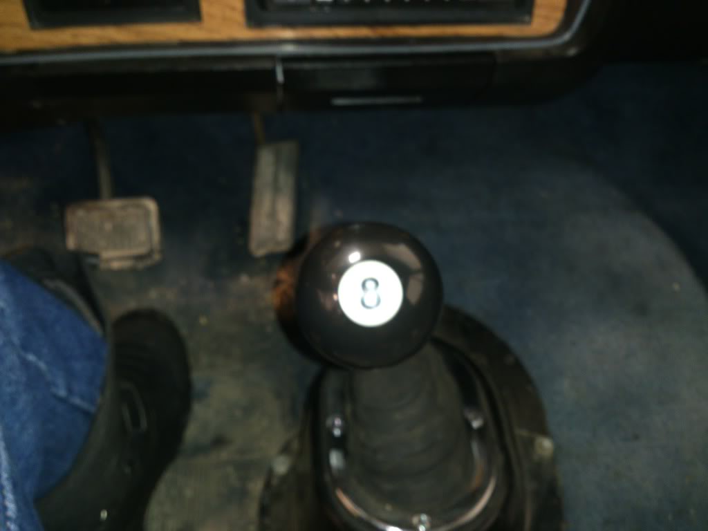

I also got around to making my 8 ball shifter.
Just drilled and tapped it (3/8 fine thread), put a little lok-tite on it (I buggered the threads on the shifter taking it off) and were good. I really like how it feels, it fits my hand perfectly. Should make for some good times slamming gears.
