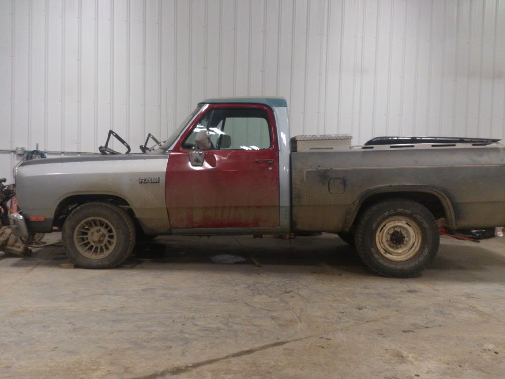

Got my 3/4 brake booster painted and installed, had to swap brake pedals as well. The 85 was held in by a clip but the 83 had a bolt through it, the pedals and booster rod werent interchangable. I got the exhaust done, dual side exit on the pass side with glass packs, I have to get a pic of it yet. Took it for a test drive and itll run ok, but trying to go up it hill it will stall out and stay stalled till I go off the throttle, then it starts again (its coasting in gear) but if I do anything more than feather the throttle it keeps stalling/starting until im down in 1st and can hardly get up the hill. The dizzy cap and plugs arent in very good shape so doing a tuneup tomorrow and well see if that helps.
Heres a few pics too.
Dana 60 in.
Before I got the front spindles swapped.
