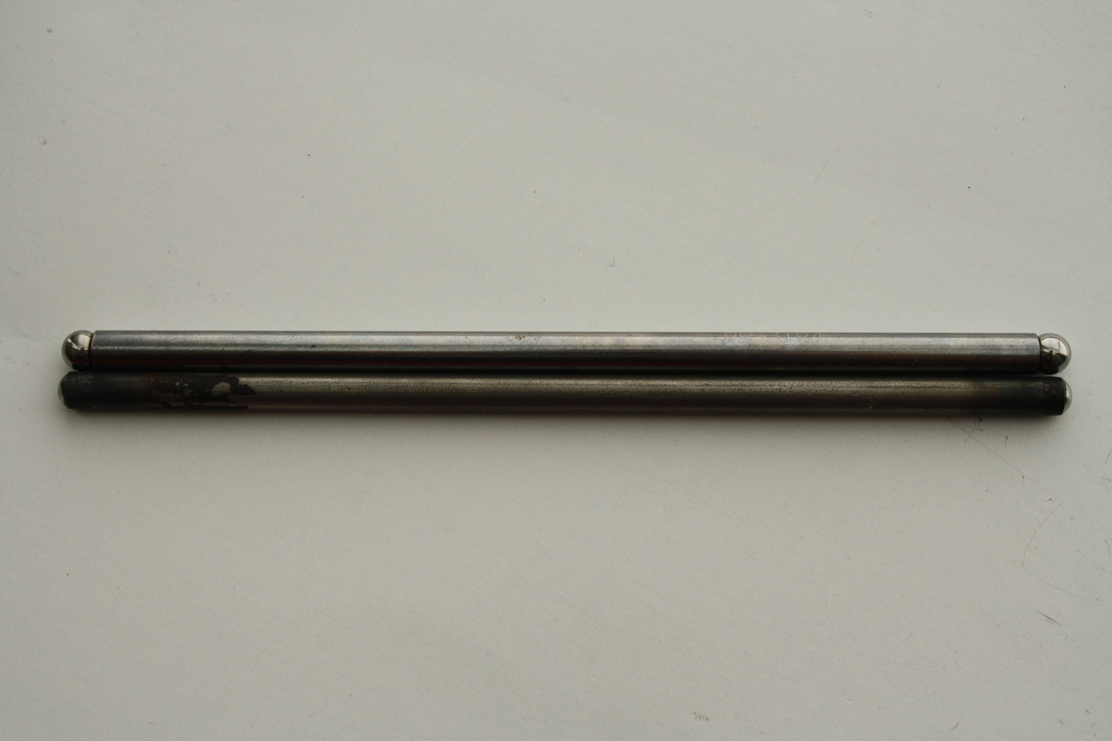

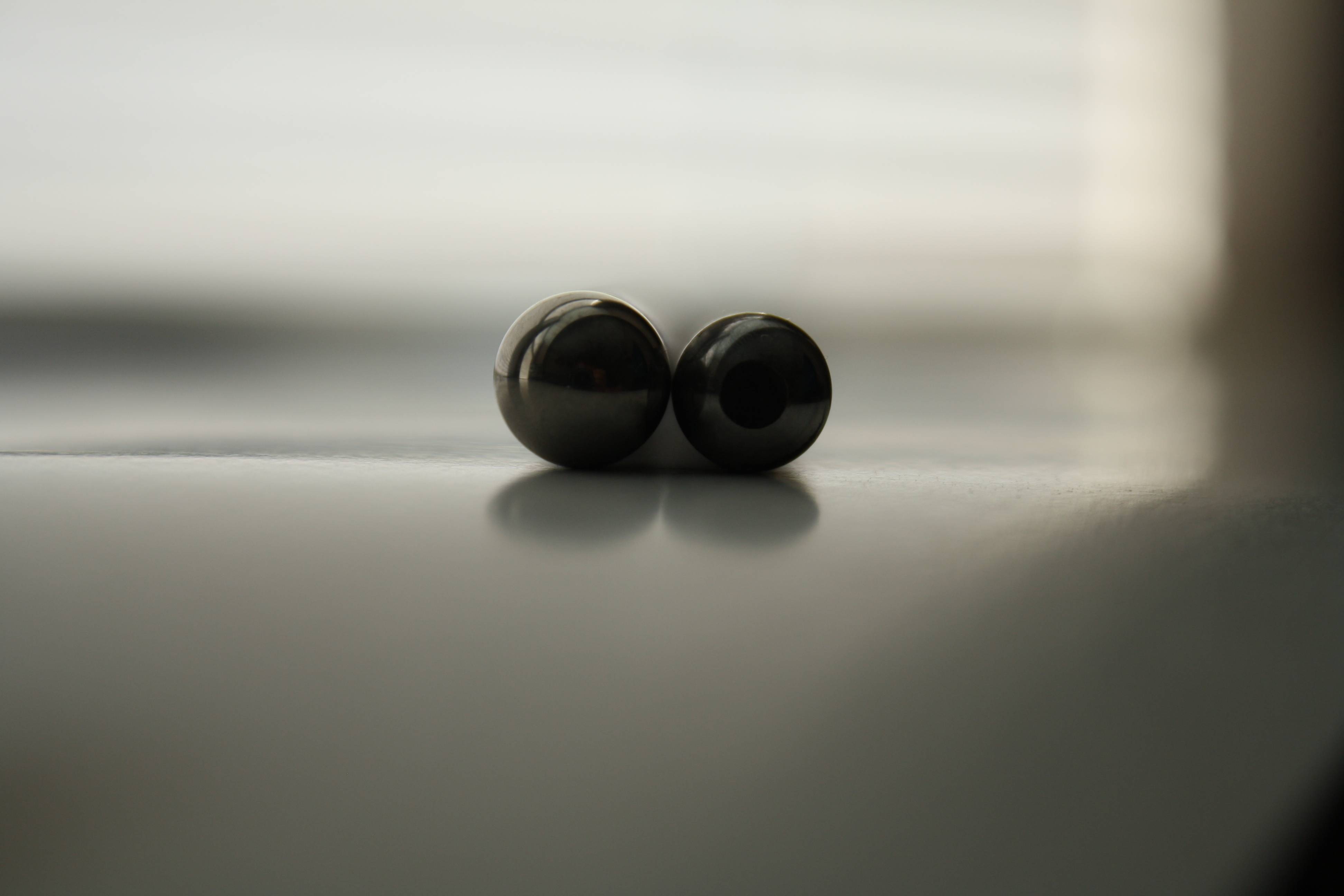

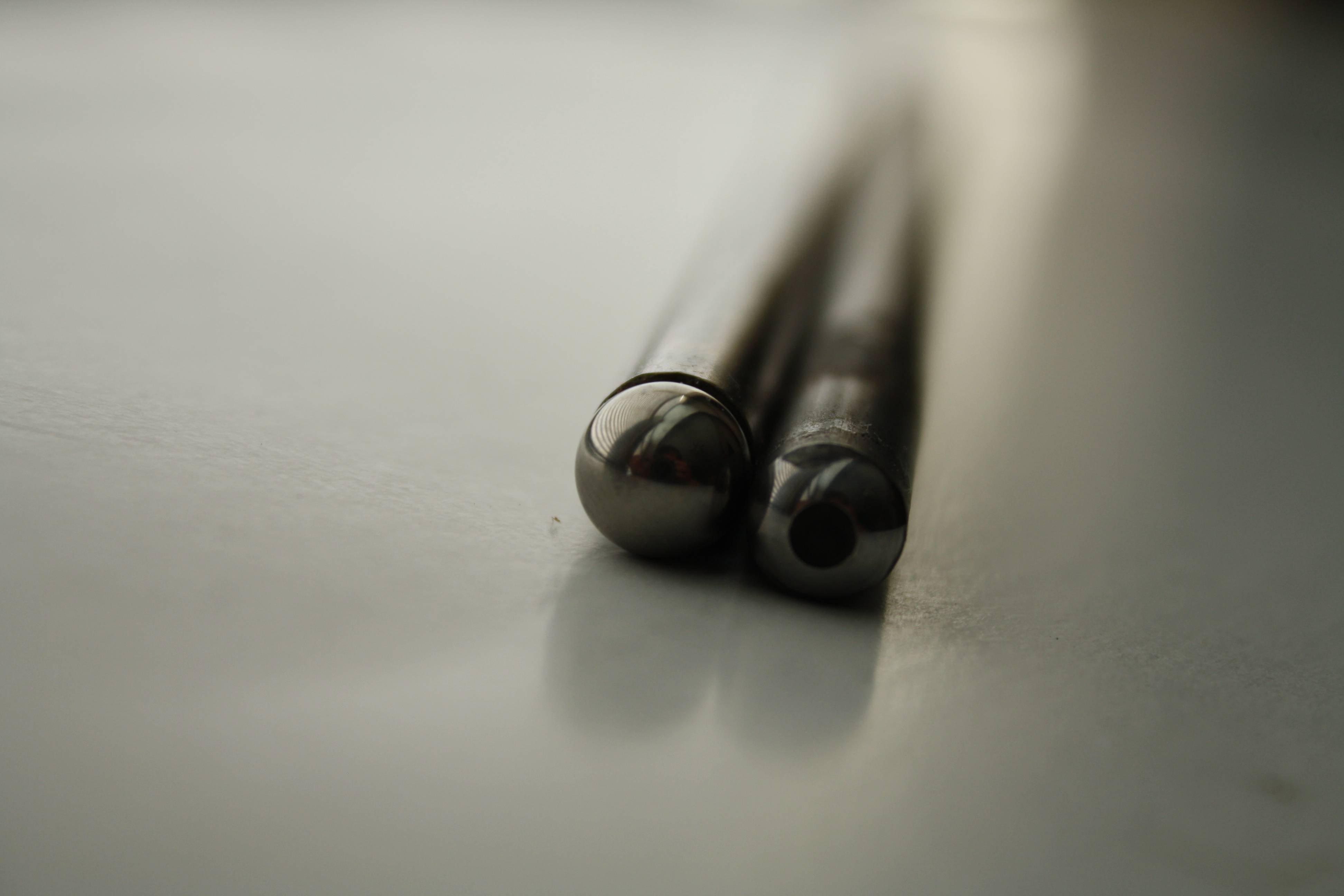

These are pictures I took of the push rods I saved 1 of the originals as you can see the new push rod is quite bigger, I had not noticed it when putting them in, trusting they were the right ones, they are the right length but not the right size/diameter. ? causing them not to seat properly and actually making them "longer" ?

I would say you found the problem. Those are solid rods, they don't have lubrication holes for the upper end of the valve train. They would also make the lifters more solid by trapping the oil in the lifter and taking away the lifters shock absorbing quality.
I still believe you will probably have to pull the heads but once the pushrods are replaced you might be able to get away with just doing a compression test to check for damage.
