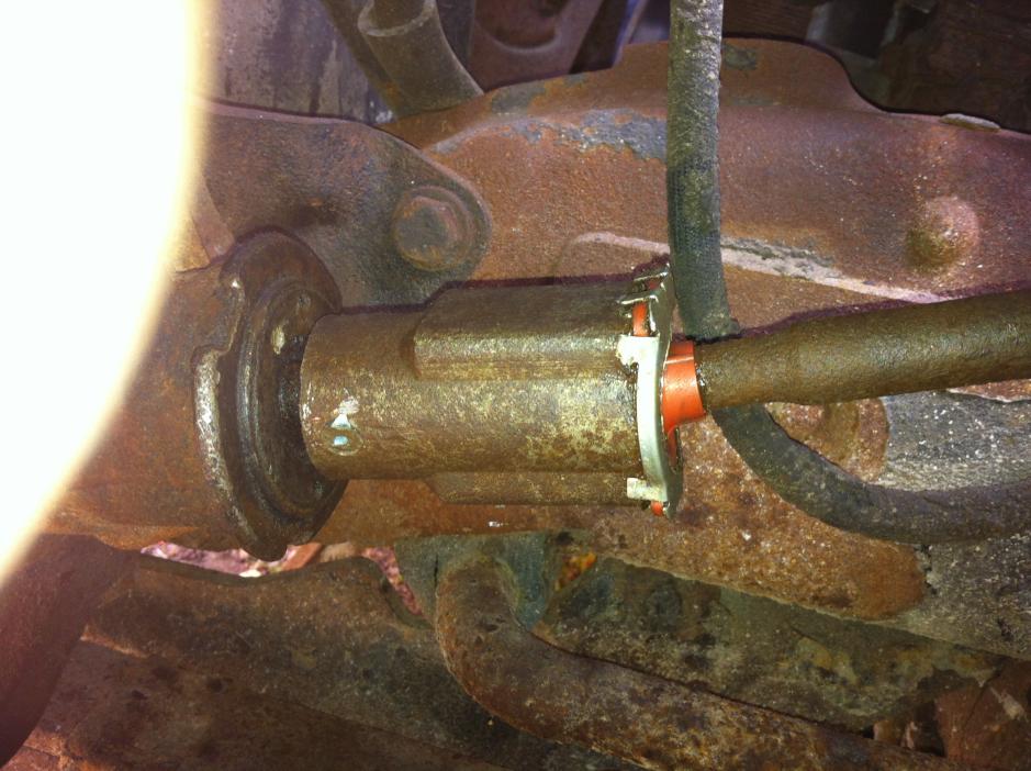

The "coupler" if thats what you call it, is completely worn and beyond repair, i tried a repair kit but the actual coupler housing is to badly worn.
I have contacted the Chysler dealership and other auto parts suppliers up here in Canada but no one has anything.
Can anyone suggest where i can get a new one?
Here is a picture of the part i am referring to.
Thanks. Brad

are you sure it is the coupler and not the steering box needing to be adjusted? rock auto has a steering shaft slip joint listed for a 81-87 w250 but none for the newer ones but they have the same steering shaft rebuild kit list for 81-93. i don't really know what the difference is.

Eliminate that problem forever with a Borgeson replacement shaft with u-joint. (PN 000940) Many people on this site including me have done this and are very happy we did. This is the cheapest I have found. Be sure to get a discount code as the code changes every month but it will save you money.

DIESEL10 is the discount code SEAL is talking about. it bring the price down to $170. after shipping and handling the it is just under $200. i don't know if there is anywhere else to get them cheaper.

Here is the housing. I think the Dorman number is 425-252-007.

rock auto has that exact part for the 79-87 dodge trucks. DORMAN Part # 425252 . for some reason it is not listed for 88-93

Do the Borgeson fix. It's a way better design.

Thanks everyone for the replies, I am going to order the Borgeson unit. From all indications it is the best solution.
