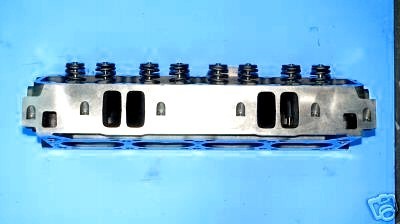

you can get a pair eq's that are already built better than stock for the same price as it would cost to get 2 bare iron ram head from Hughes.

I called, asked a few questions and will be getting heads from these guys soon.
Thanks for posting that.
item 150906713421 looks like it was meant to go magnum engine but use a LA intake. item number 160887572247 would be the heads you would want if you plan on keeping it fuel injected. the intake bolts on a fuel injected engine are vertical and the intake bolts on a LA engine are on an angle.
