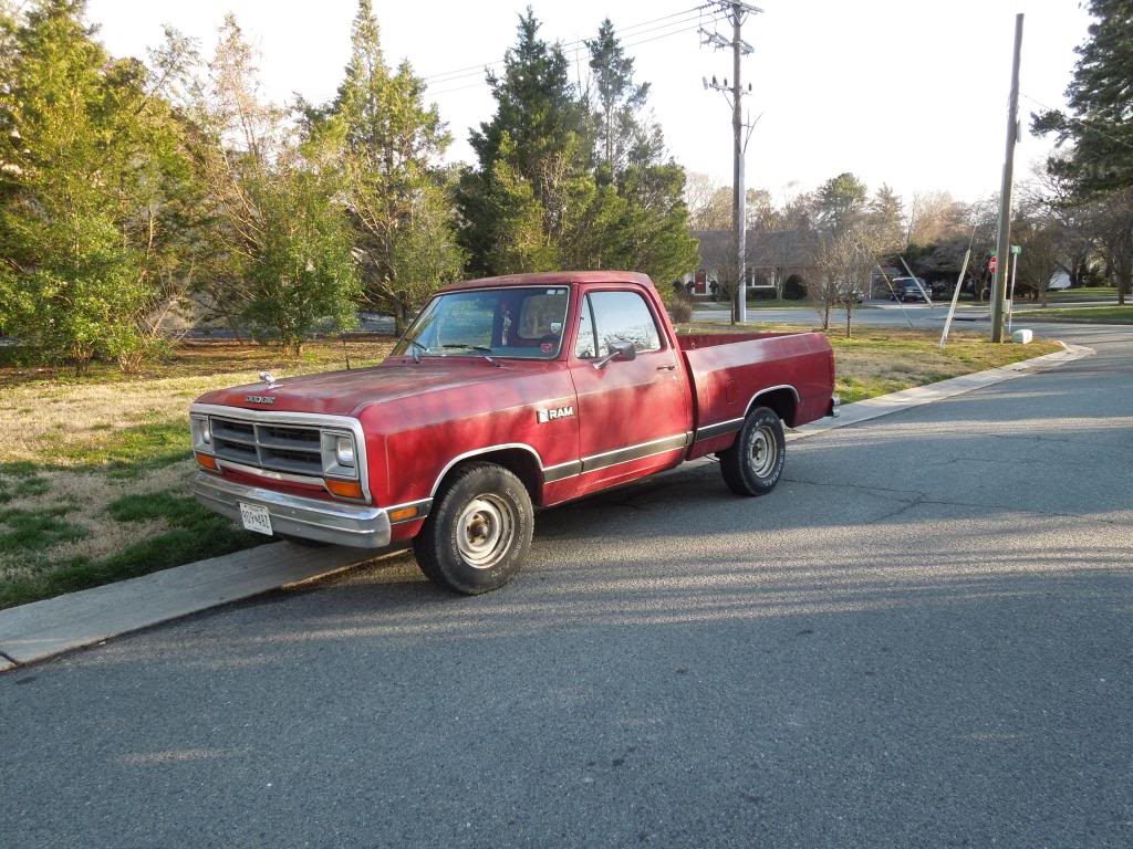

I recently bought this 89' Dodge D-100, it is the first car I have ever owned. It has the v-6, 5 speed on the floor, 2wd, and short bed.

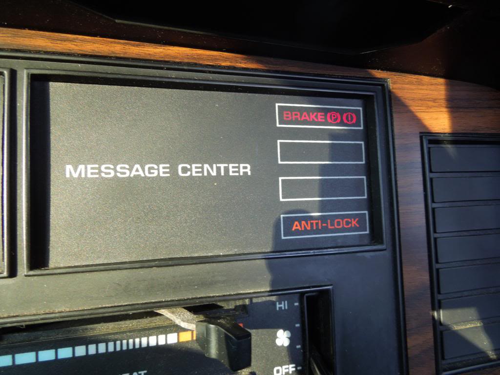

1.the brake and abs lights are always on:

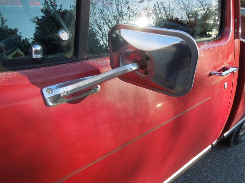

2. these side view mirrors are simply terrible, Where could I find OEM or good after market replacements?

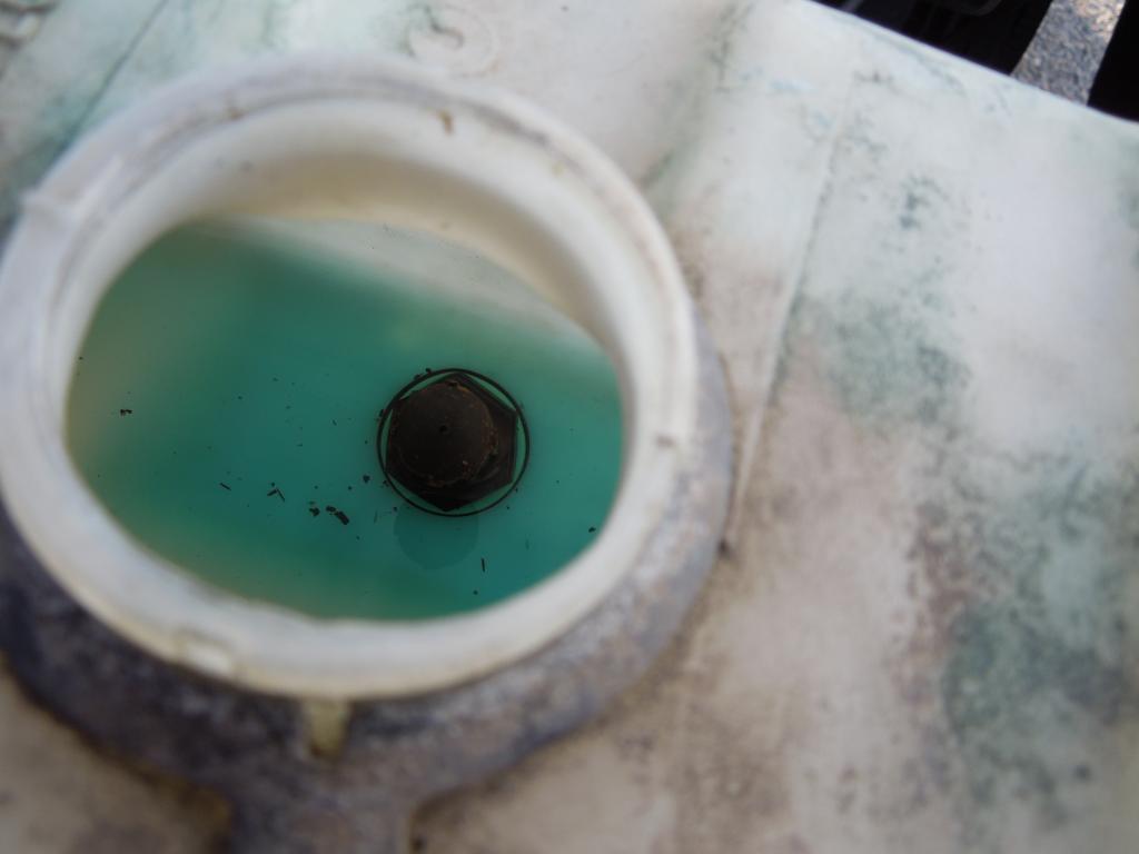

3.The windshield washer does not do any thing, so I figured it was the little pump so what size is this nut in the reservoir?

1. if both those lights are staying on you may want to check all the brake line. you may have a leaking line if they stay on.
2. those are oe mirrors. just they have a tendancy of rusting like they have on your truck. you could get some mirrors off another ram but you may want to take measurements since you will have to drill some new holes.
3. do you hear the pump kick on? with how much fluid is in the container in the picture it will not work.

check your brake fluid level too. On the mirrors, I hate those little things, but also hate the west coast Jrs since they are so noisy. Try to get a set of stock mirrors off of a 1990 91 truck like mine, they are PERFECT. They are twice the size of those on your truck and smaller than a huge west coast mirror set up so many people here seem to like.

the nut in the reservoir should be 7/8" or at least the one i took apart today was.

Okay, So the windshield washer pump is bad; filled the reservoir and it still did not work, found that it was getting power but not pumping.

I am still not sure about the abs and brake lights, I have not yet found any leaking lines. Could it be a bad sensor or wire to a sensor?

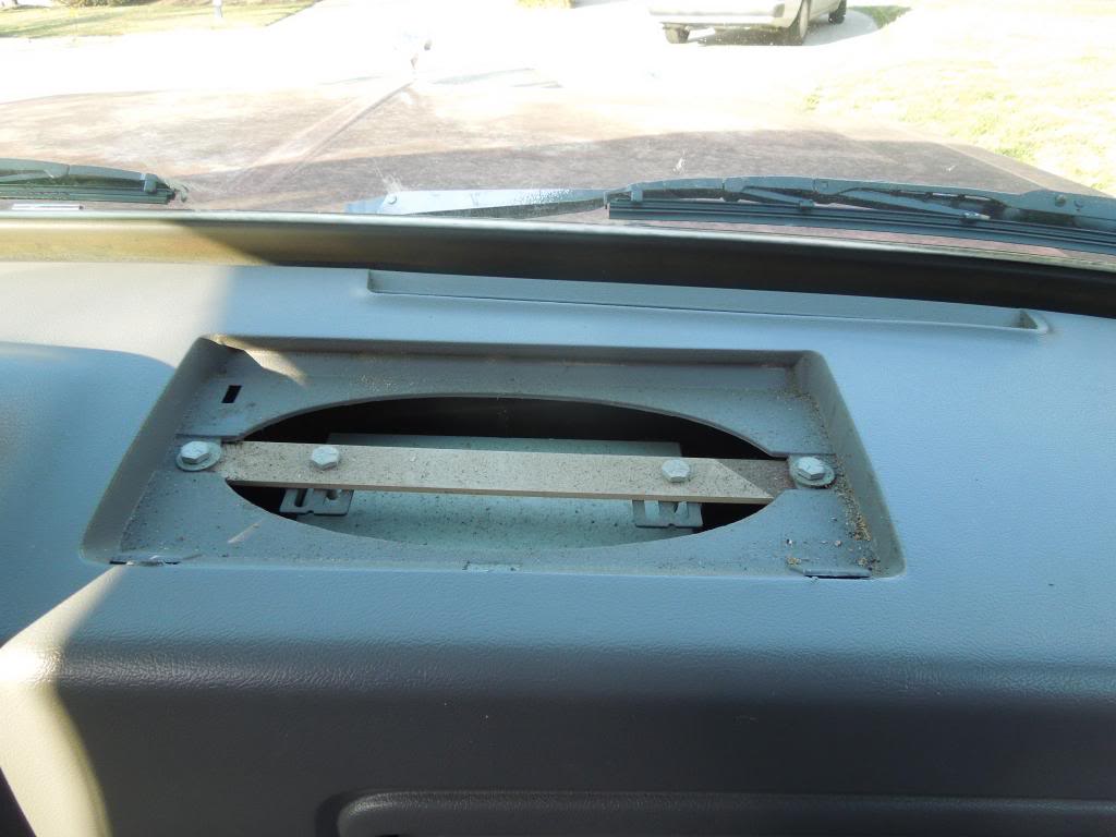

A 4x10 speaker goes in this hole on the top of the dash correct?
