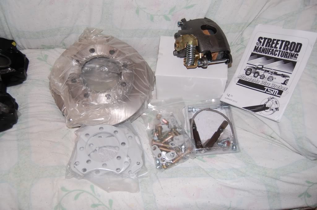

I purchased mine from http://www.tsmmfg.com/ and had no problems and they offer great customer service.

Early test fit on an older D60HD I was going to use:

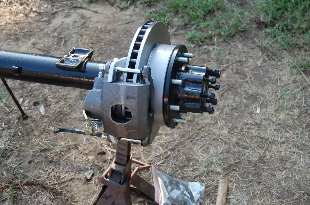

Final set-up on a different D60HD I ended up using:

It is very easy to install.
I did have custom length e-brake cables made which was very inexpensive. You will notice I installed my calipers "upside down" so that I had additional ground clearance with the e-brake cables. I have them so they run over the axle and not under.
The one thing that you have to remember is to adjust the e-brake before connecting the fluid lines...with the rear brakes assembled, I removed the spring on the e-brake arm on the caliper and moved the e-brake arm on the caliper back and forth until the pads were stopping the rotors. Then re-installed the spring and hooked up the cables and adjusted the e-brake.
Then I hooked up the fluid lines and bled them out. On mine I have to pull the caliper off and flip it over since they are upside down. I simple gravity bled them and shook the calipers and tapped on them with a hammer to ensure all of the air was out of them.
Where people run into issues with the Caddy Eldorado calipers is they try to bleed them before adjusting the e-brake and then they have a terrible time getting them to work correctly.
