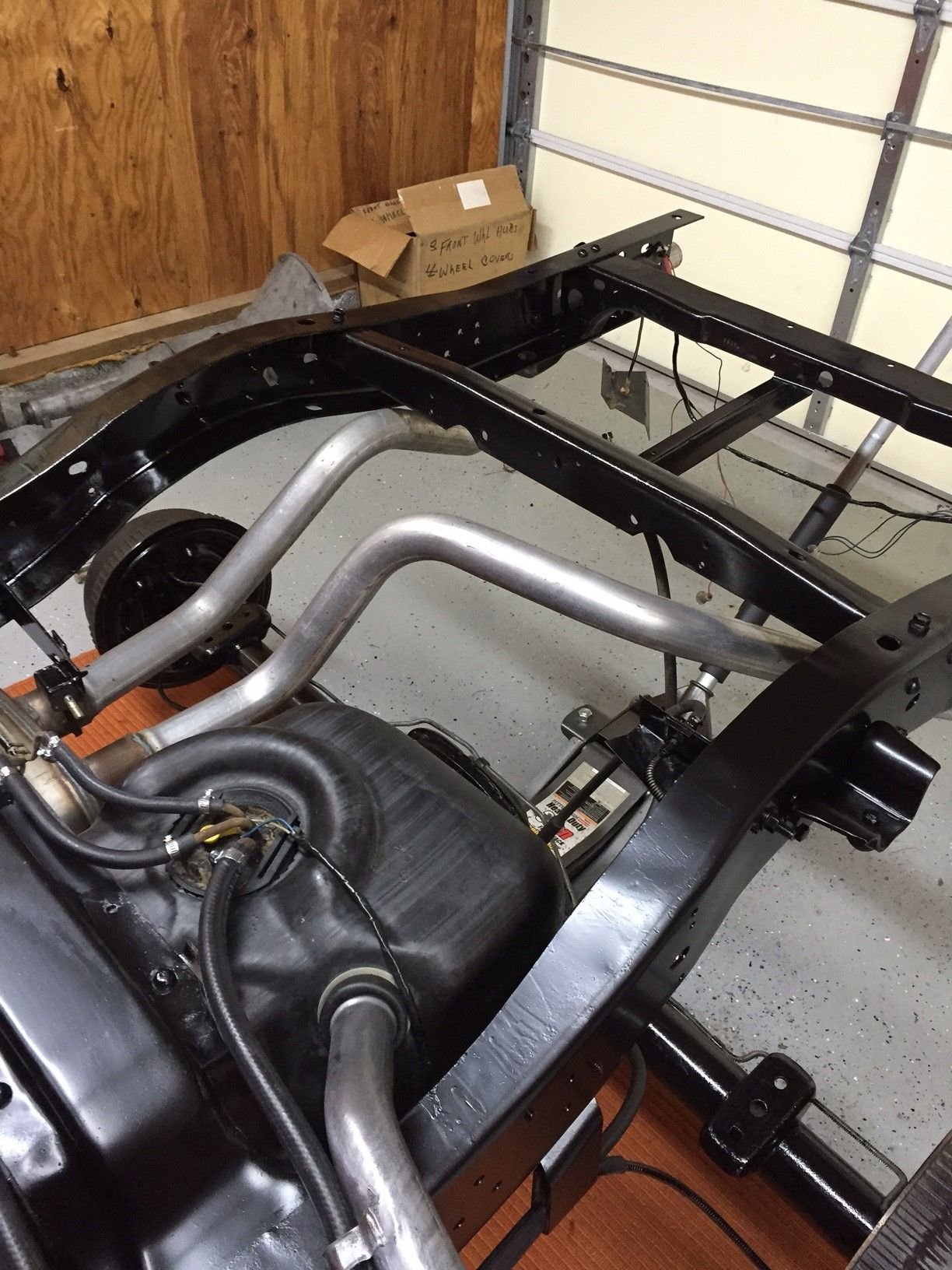

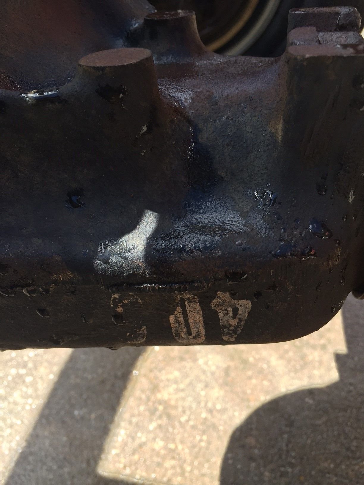

In the previous post is a nice shot of the dual exhaust with the two in two out muffler that has a built in X pipe. Now its time to pressure wash. As you can see I had a great starting point.

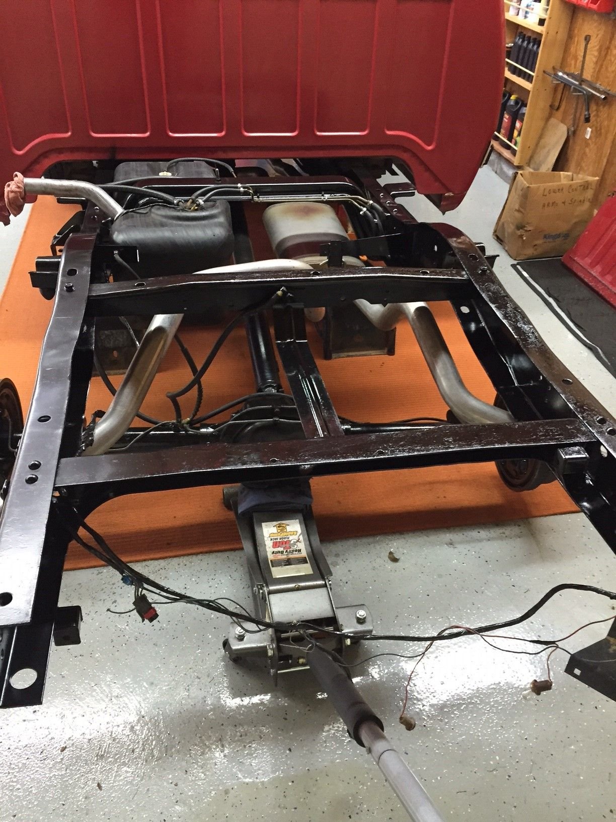

I replaced all the fuel lines and filler neck grommets while in there. Also all the suspension bushings as well as re wrapping all the electrical. after that it was time to strip the frame.

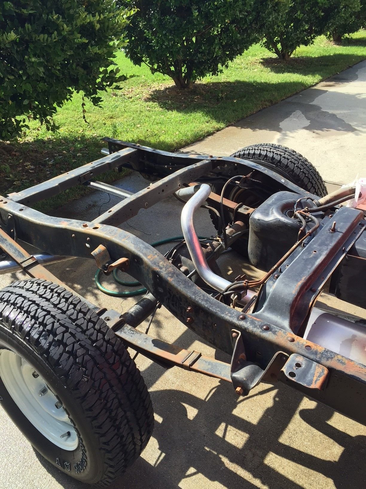

here is some finished shots before everything went back together. I hit the frame with 2 coats of POR 15 and 2 Chassis
black top coats.

Not dead just low traffic. I take it you are not in the rust belt because that frame was in nice shape to start with.

I found the truck in GA. It only had 60,000 miles on it. I believe it was put away after a flood many years ago. Found water lines inside the cab. Anyway the guy who sold it to me really took me and falsely advertised it. As stated it was an unexpected project. Now that I am done with everything I basically have a new truck
