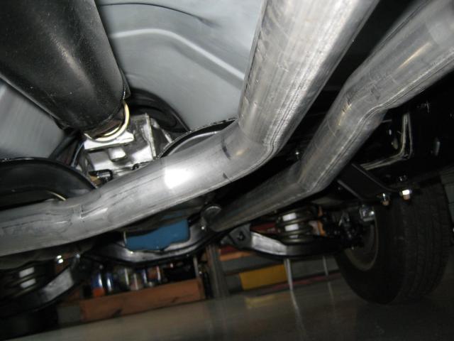

Well, I wasn't able to run the exhaust like I wanted but here are a few shots. I went with a 2 in 2 out with a built in X pipe in the muffler. i also had them install some clamps just passed the headers so that I could pull the motor if something doesn't go as planned. They will be removed and welded after everything is dialed in. also the drivers side pipe was run behind the trans in ccase the trans has to be pulled
[IMG][/IMG]
[IMG][/IMG]
[IMG][/IMG]
