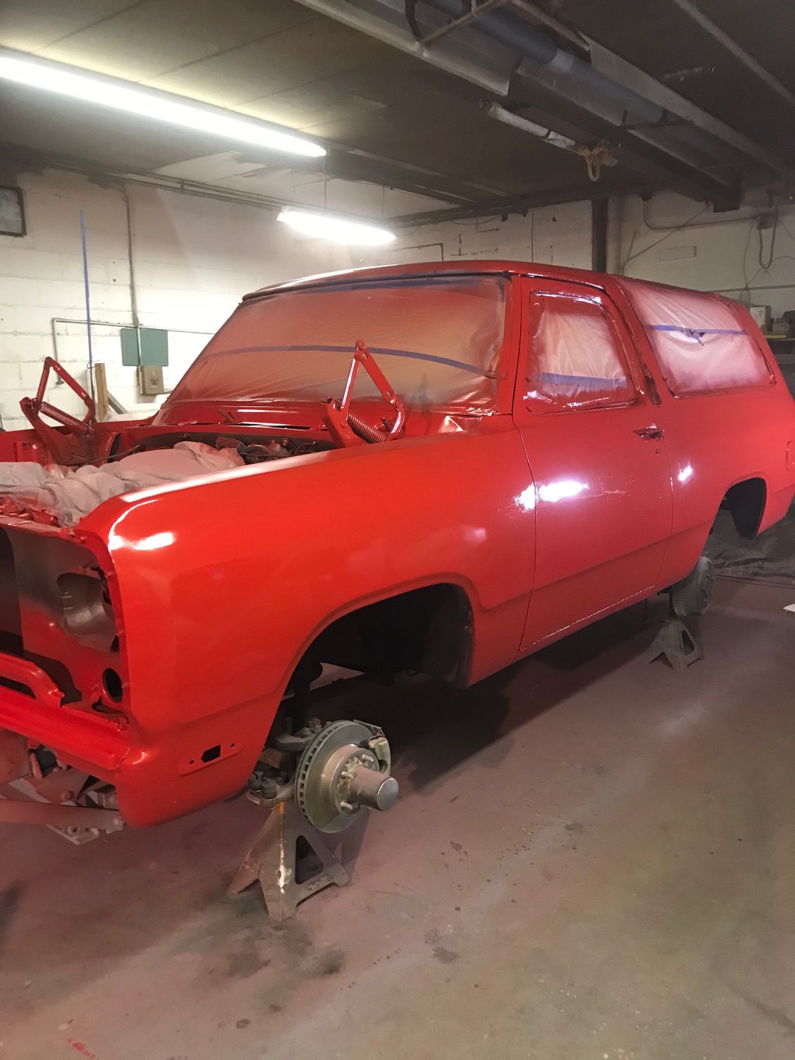

That put me at $6.00 over but that was ok so on Wednesday this we the swap will be done. I can only hope we have the one in the picture done by then
