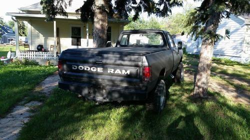

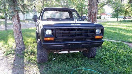

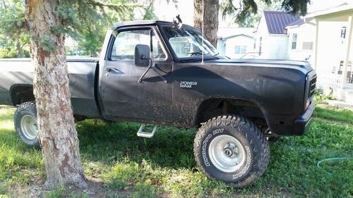

Hello! 82 Ram 360 4spd
Long time stalker, had many-a-Ram, just gonna be picking up a brand new 1982 Ram 360 4 speed manual. (4WD) (owner claims full driveline rebuild 8k ago)
my question is, assuming it’s a granny tranny, what are some desirable tranny and driveline builds for these? Looking more-so for mileage and MAYBE a small amount of mud play. I know no matter what she will be a pig but those first gens are way too cool to pass up.
