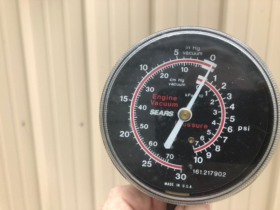

I checked the vacuum and it read 17 I played with the throttle and it dipped down a little then stayed the same back at idle
I ordered new spark plugs and wires along with an idle air control valve to see if that fixes anything I値l keep you posted
